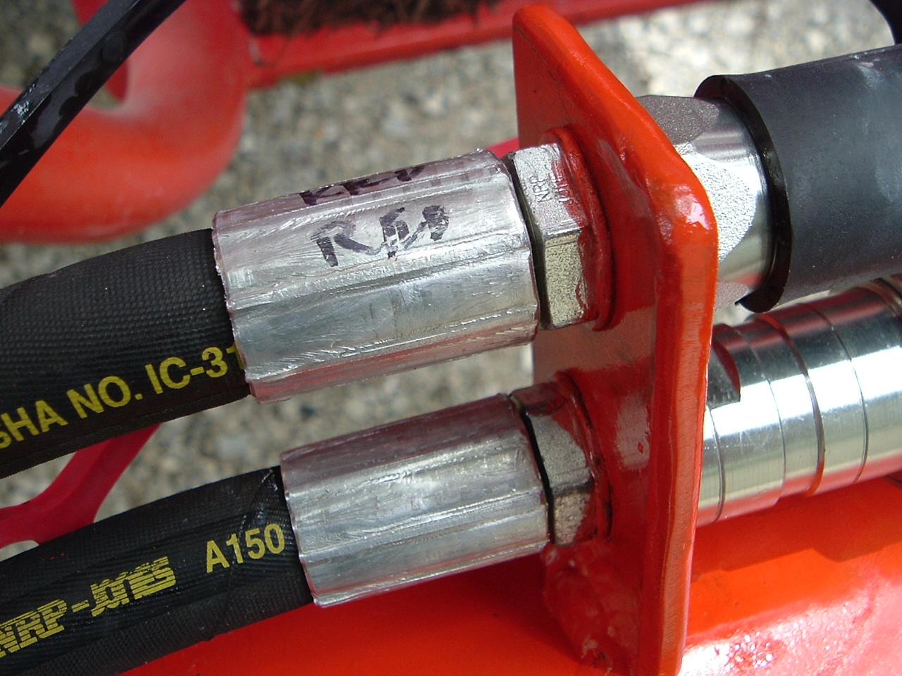

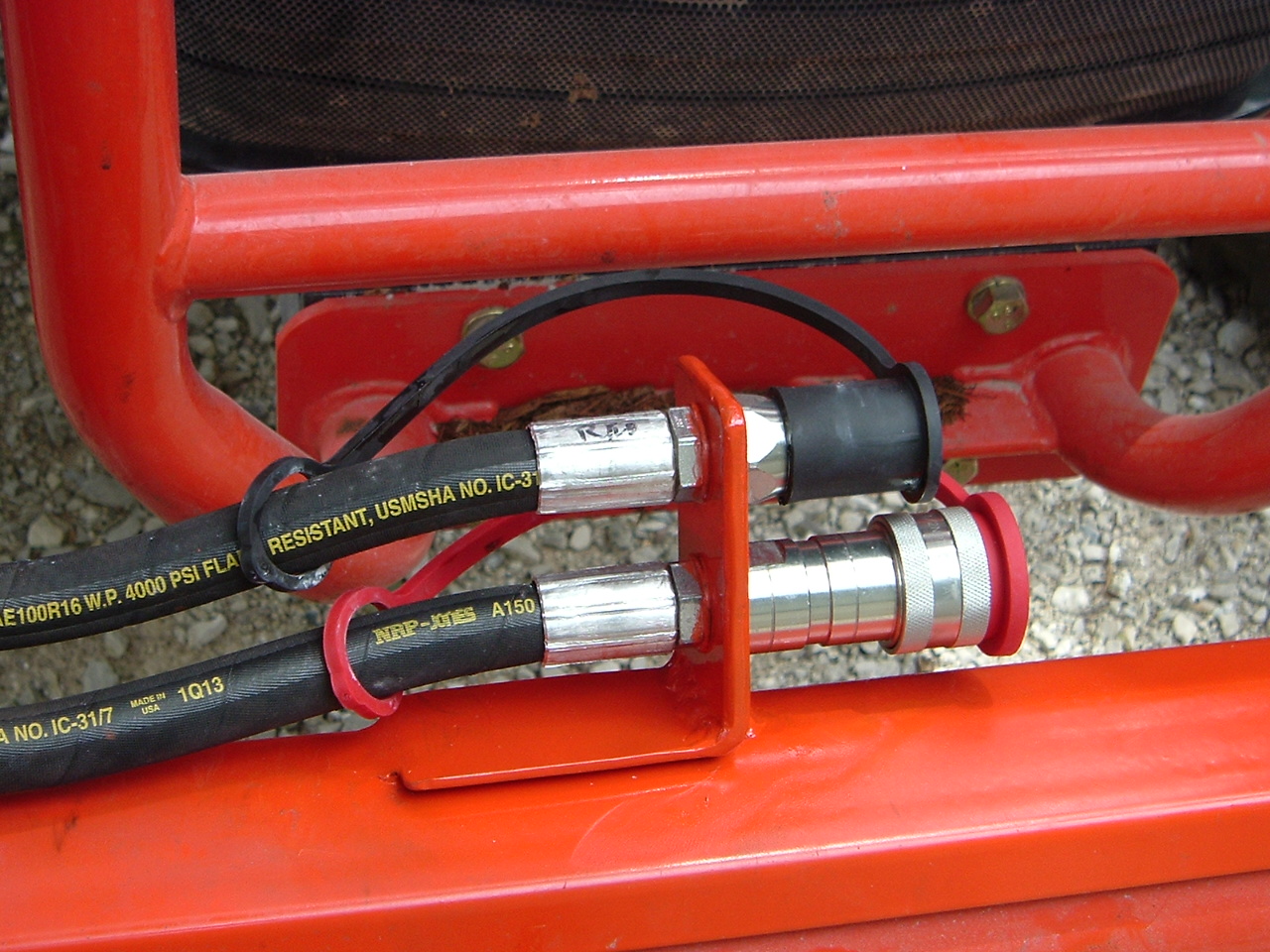

What I've found to be more importantly is how will you connect your hoses so you can take it off and put it back on quickly and easily. I've tried two different brands of quick release fittings with horrible results. Now I just unscrew the hoses and screw in a plug when the grapple is removed. This has proven to be the fastest, easiest method for me.
   / Pros,Cons of single/double lid grapples? Opinions needed #5
For a small tractor without a lot of lift, weight should be your primary concern.
I have a double on my loader backhoe. Weight isn't a concern, for me it's more important to be able to get as much as possible on there and for it to stay there all the way to the burn pile. Having the two arms close separately allows me to hold an uneven load more securely.
Eddie what kind of problems did you have with your quick connects.? I just have the "Ag" connectors on mine.
