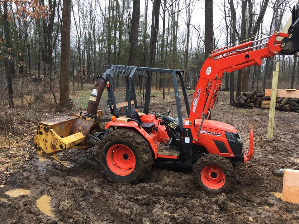

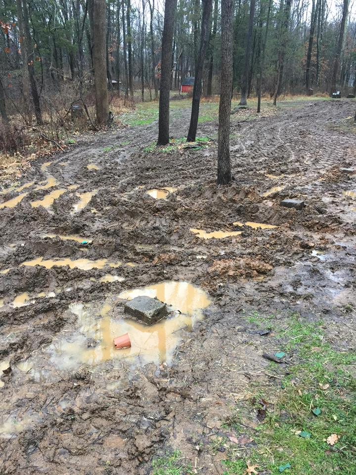

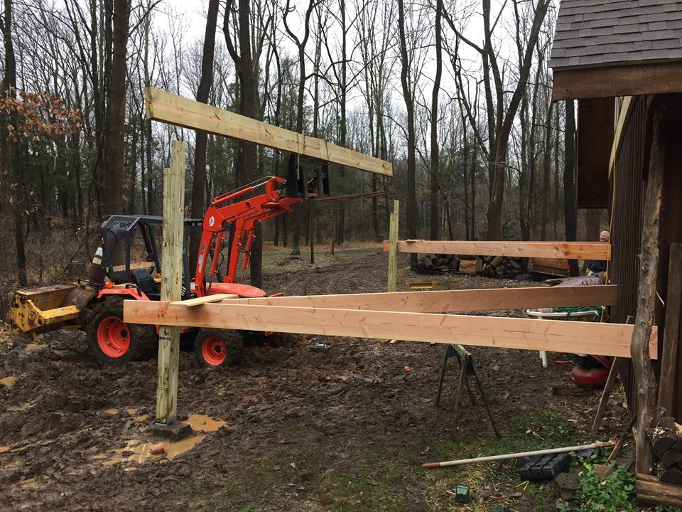

R4 industrial tires are not useless on mud. Turfs are useless in mud! There is a big difference between a turf tire and an industrial tire in mud. R-1 tires (Ag tires) are worlds better than industrial tires in mud. If an Ag tire is your reference point, I can see how one could conclude that industrials are useless in mud. But with turfs as a comparison, industrials are great in mud!
In 2 wheel drive I can easily drive my tractor with industrials through mud that will sink a walking person a foot and suck their boot off! In 4wd drive I can push through mud until it comes over the front axle before I have to use the loader to get my self.
In the mud in the pictures, I never needed 4wd. 3 people lost boots that day!
As for negatives of a heavier tractor, the only one is ground compaction which might not even be a factor if the tires are larger. Most heavier tractors come with larger tires. I know for a fact that carrying 700 pounds in the bucket of my now sold 20hp CUT would make deeper ruts in the yard than the same 700 pounds in the front of my 45hp tractor. This is because the larger tractor has much larger tires to better distribute the weight. Both of those tractors had industrial tires. Turfs do the best job of distributing load on turf and tear it up the least but industrials wont tear up a lawn if the ground isn't wet.
