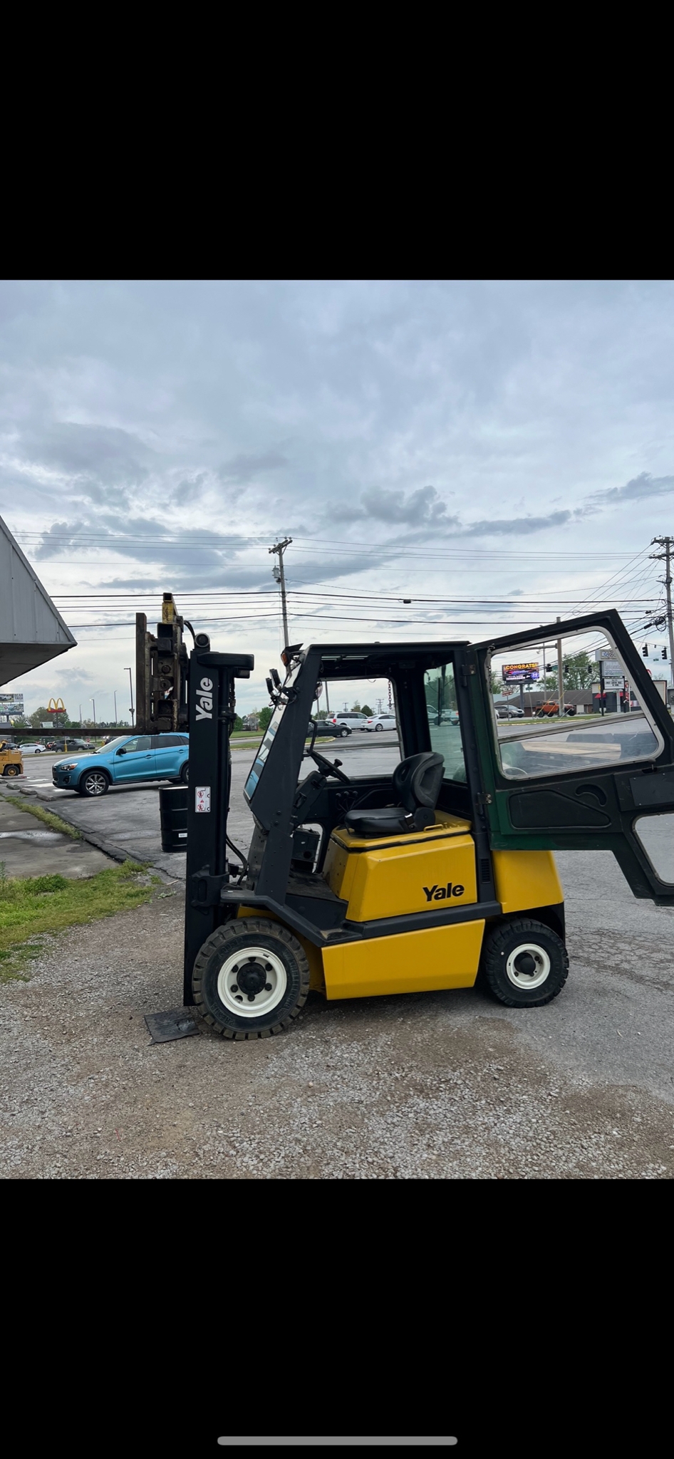

I have a propane fueled forklift that runs fine when it does run. I’ve never had any problems starting it when it’s cold. And by cold the ambient temperature is in the 80s so it’s not actually cold. Sometimes it will start when it’s warm the problem doesn’t constantly present itself. Sometimes it cranks more than normal and eventually starts sometimes it won’t start at all until it sits for a while. The coil is making spark when it won’t start so I think the problem is fuel related not ignition.

Someone painted it and actually did a good job. It’s a 2003 with 10,000 hours. It’s a Mazda 2 liter engine.

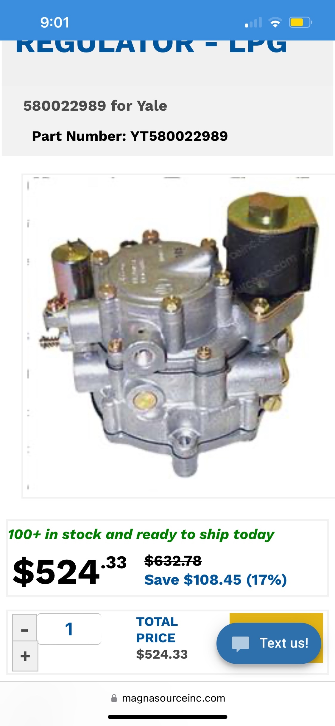

I don’t think it has one unless it’s built into the regulator. The supply hose appears to go straight from the regulator to the tank. This is what the regulator looks like which does appear to have a solenoid valve on it.
   / Propane forklift won’t hot start. #9
I don’t think it has one unless it’s built into the regulator. The supply hose appears to go straight from the regulator to the tank. This is what the regulator looks like which does appear to have a solenoid valve on it. View attachment 3810887
If memory serves, the lockoff valve is under that coil mounted on top right of that picture you posted. When the coil is energized, it magnetically opens the valve. When it loses power, ie. turning the key off, it shuts off the propane. When machine is started cold, everything works. When machine is shut off hot, the springs close the valve, but because of heat soaking, the coil isn't able to overpower the springs keeping it shut, or thermal expansion is keeping it closed with friction. A new coil may solve all of it. Most coils have a manufacturer part number right on them, so you may be able to take that and just replace the coil fairly cheaply.
