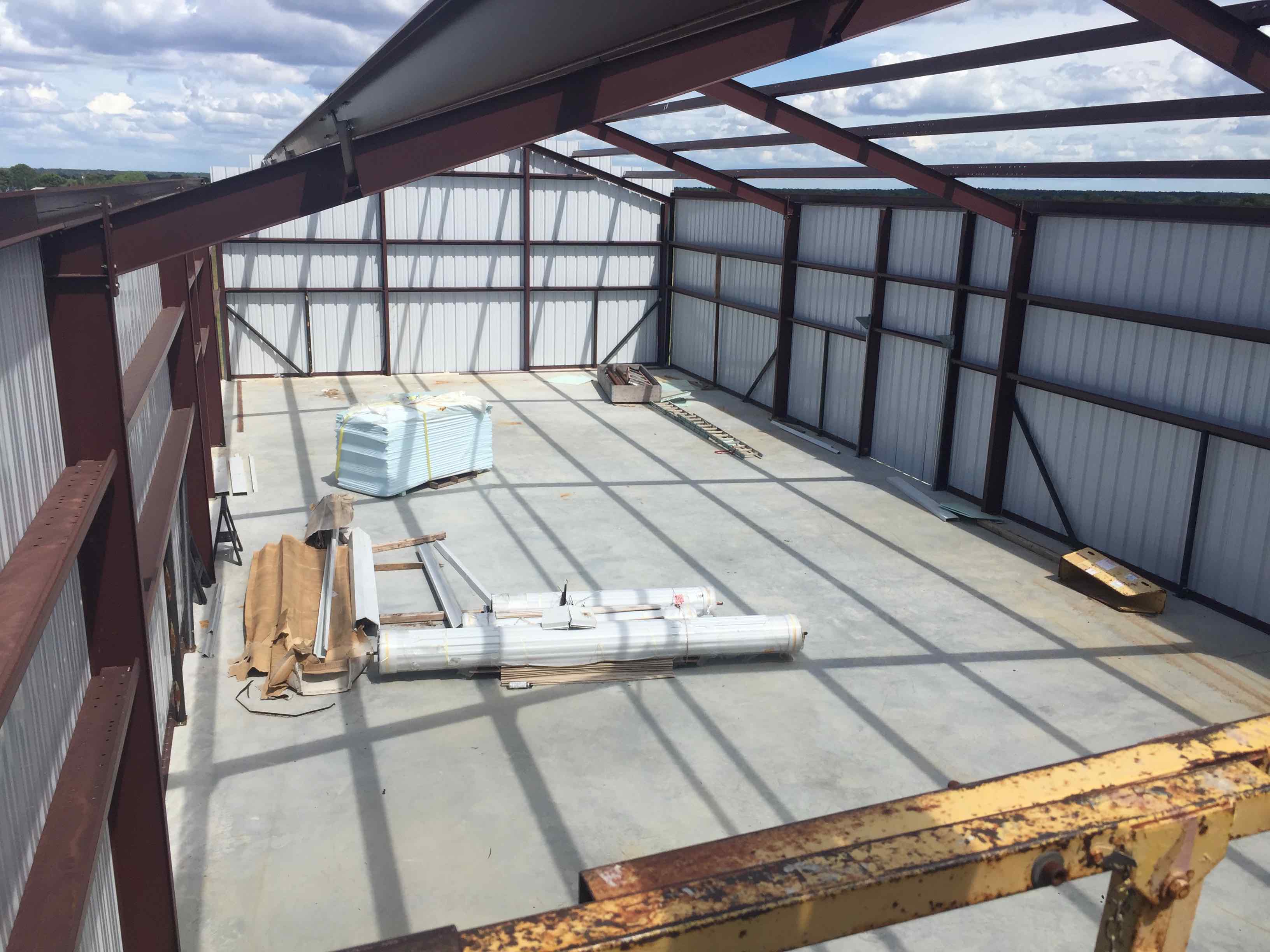

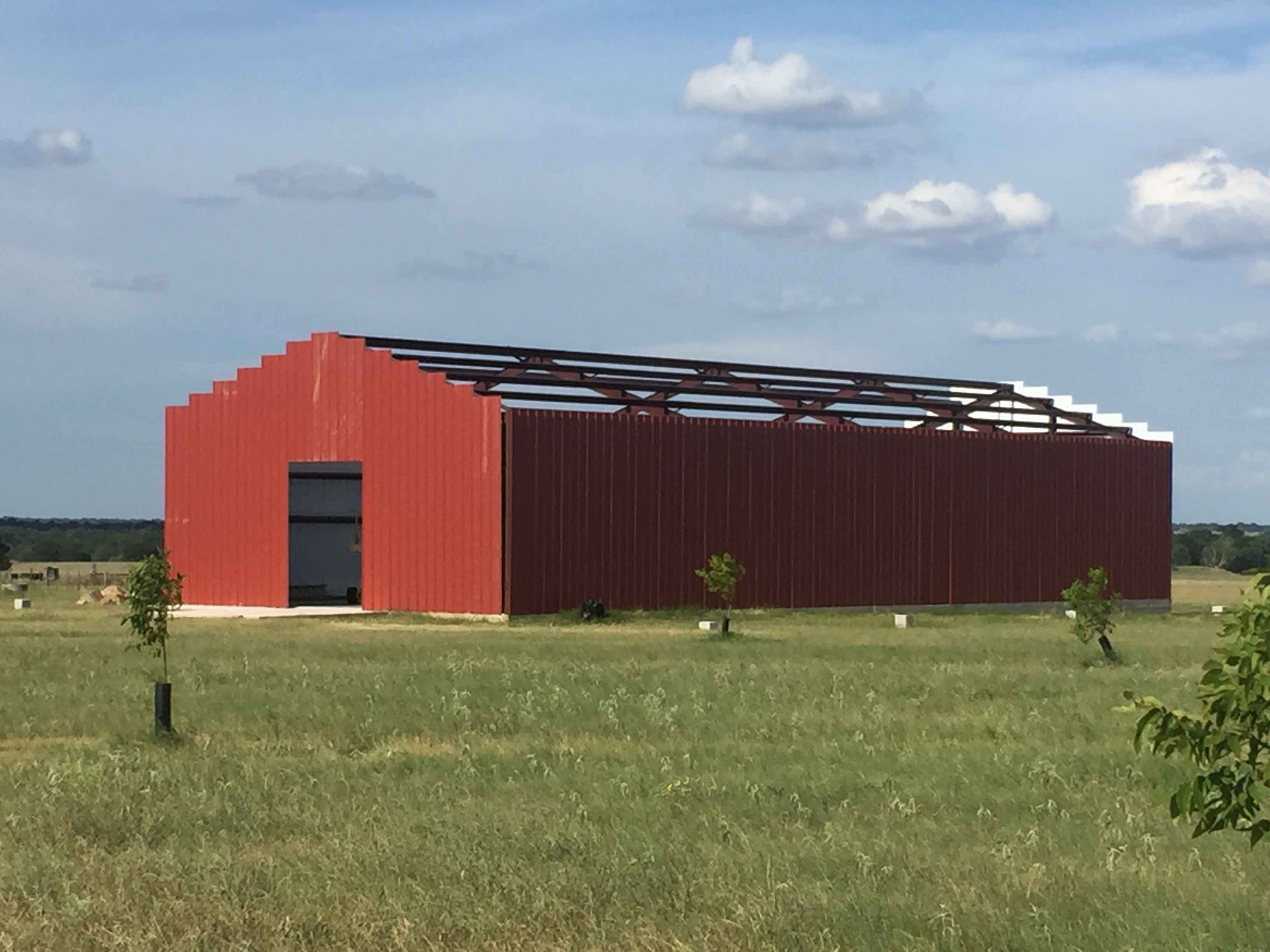

I am making slow but steady progress on the new barn/maintenance shop for our ranch. Between weather, the pandemic, material shortages, flaky help, business slowdown squeezing cashflow, just 2020 in general has made good progress even more difficult.

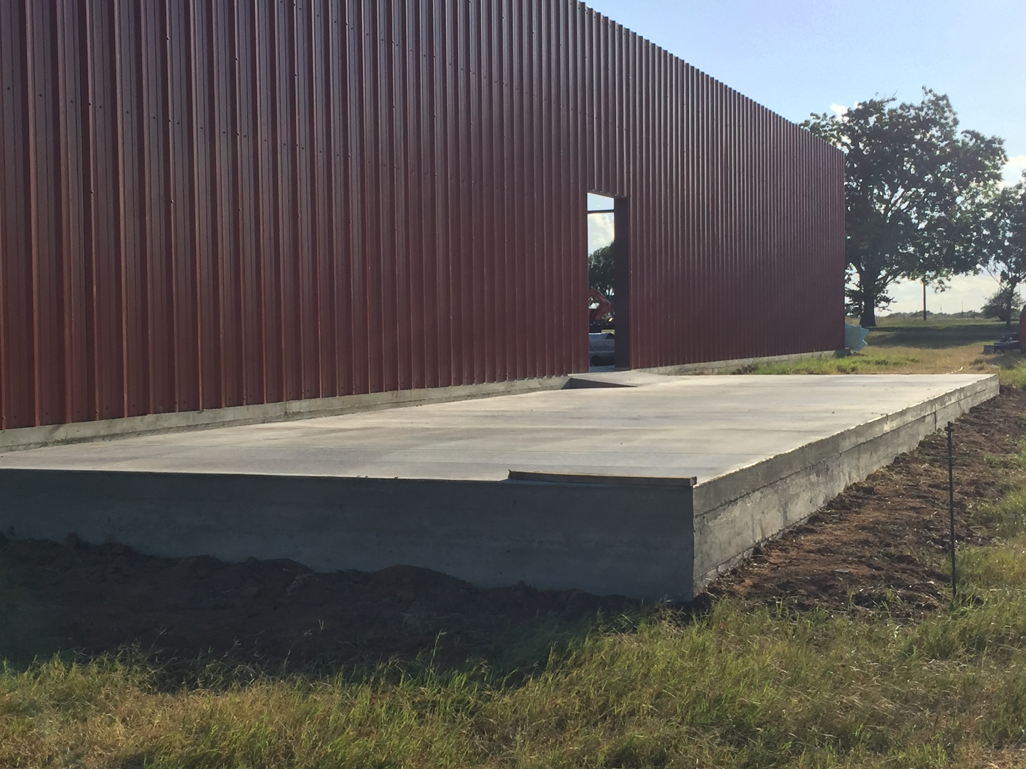

We have the framing steel up along with the sidewalls, and have poured the outside welding rough work area and footings for the shed wings.
Now I am getting ready to start putting the roof on and get it dry on the inside which will make life a lot easier.
I now have two older scissor lifts from the mid 90s, one a Grove 3160 and the other a smaller Up-Right model. Both are pre-computer control, they just run off of switches and solenoids so I can keep them going normally with a meter and a can of contact cleaner. One question that I have is both are a little jumpy when you engage the wheel motors, sort of a couple of seconds of windup and then the go. Do older lifts use accumulators or anti-drainback valves to smooth them out when new or are the all just jumpy? Never really used or had one before and now I have a pair which should make doing the roof a lot easier.
