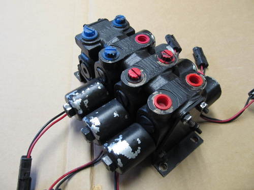

Saw an ad for a used Eaton electric control valve.
It is listed as an Eaton 5 gpm electric (12 volt) for $75.
Curious what kind of project a person might build around it?
-Neil
   / project ideas for a small electric control valve? #2
Looks like a three section directional control valve. It will function similar to manual operated valves except these are full on or full off. Without knowing what type of spools these are it would be difficult to know what they would do.
   / project ideas for a small electric control valve? #4
You can use air to determine if the valve is open center or closed center.
Are there any numbers on the valve?
This looks like a newer model of that valve.
Sectional MDG Valves
Looks like one I used for an irrigation project
