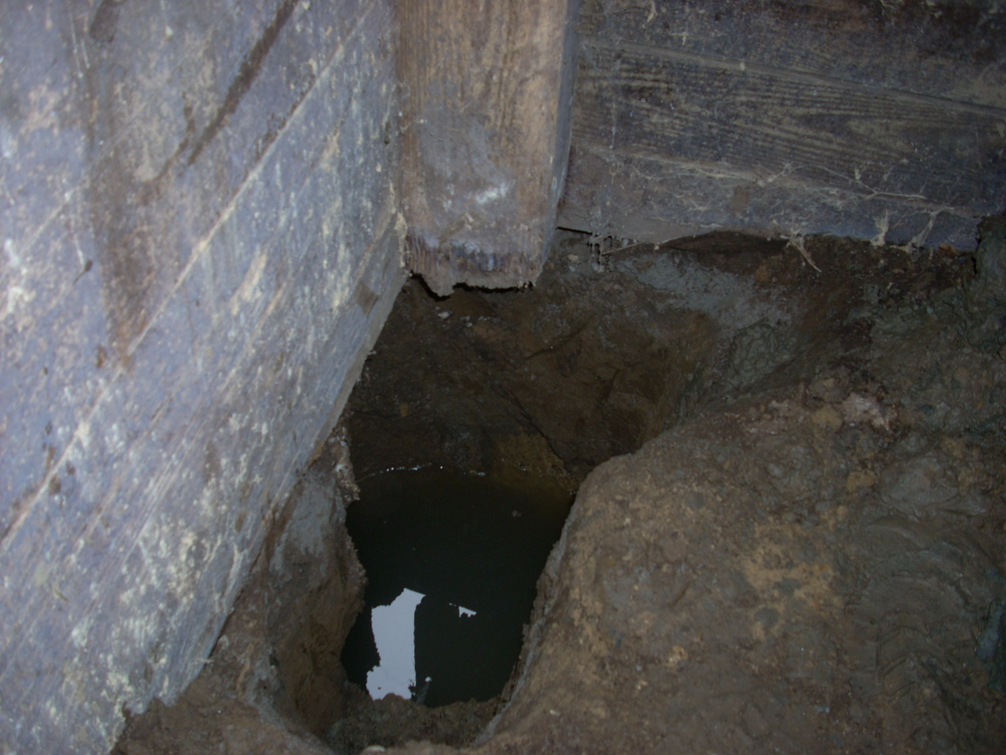

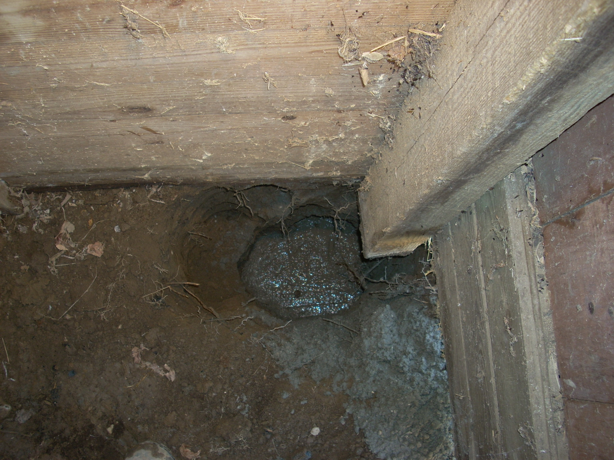

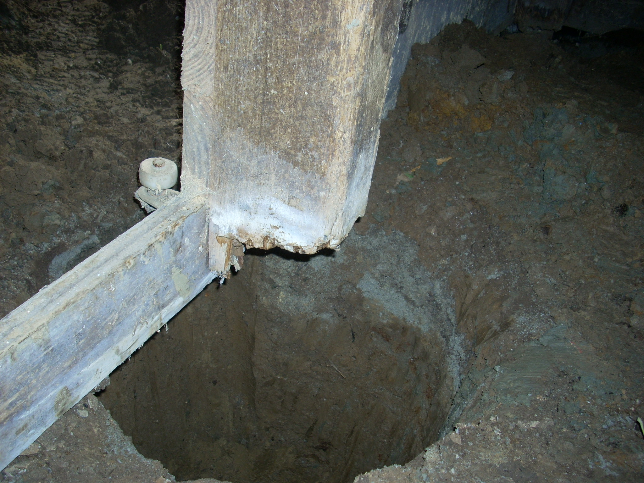

One of my customers has a mid-80's vintage 25' x 50' 2 story barn with 8 stalls, hay rolls stored up in the loft. Doors weren't closing correctly and barn needed some electrical work & stalls cleaned. I adjusted the doors and did some checking around.
Upon closer inspection of the posts, I noticed significant rot. Out of the (28) 4x6 & 6x6 posts, 24 of them were rotted 50-80% through!!
Much to my surprise, the posts were made out of untreated hemlock or locust. She had no idea how bad it was because years of hay, dirt, etc were packed around them.
After reaching agreement with Customer on costs & how to proceed, I began to think about how this job would be done. How would a barn of this size support itself while posts were being repaired and how would I repair them?

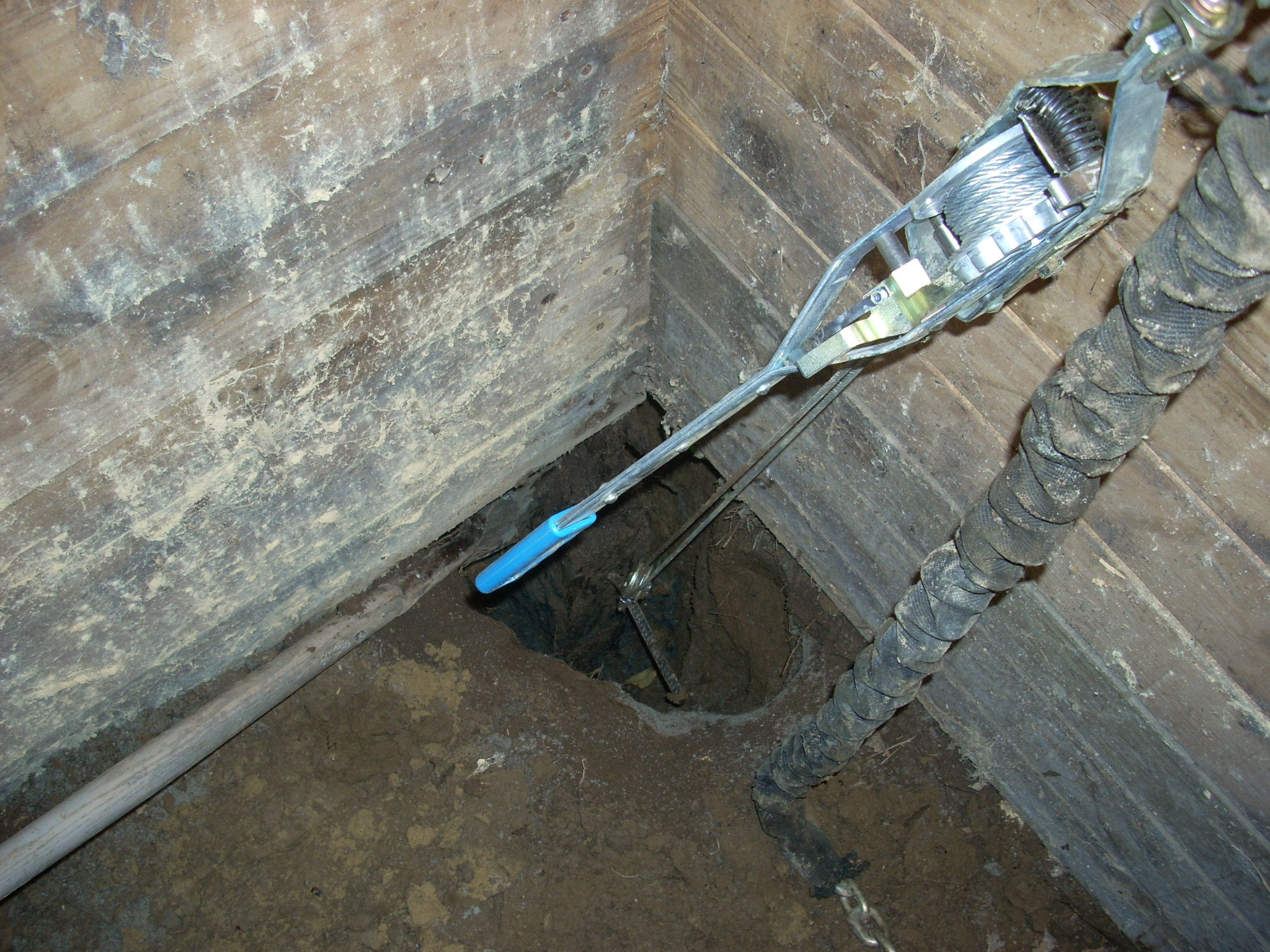

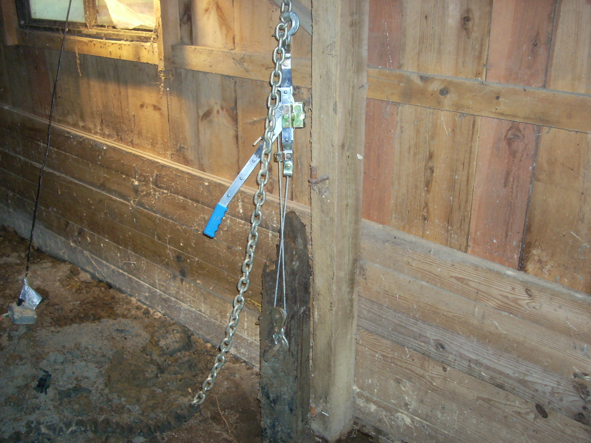

I decided to use post hole diggers and dig the rotted piece of the post out from under the healthy parts that remain above ground. The posts were approx 5' deep and wouldn't budge even after they were dug out wih PH diggers. Plus I had to contend with only being able to dig on 1 or 2 sides of each posts since they were trapped in corners.
I used my "oooopsie" (RE: Drago) Milwaukee 28V cordless drill equipped with "$5 batteries" and a 5/8" auger bit and drilled a sideways hole about 2' down into healthy post. Then I inserted a 5/8" carriage bolt into the hole. I threw a heavy chain on the carriage beam above the post then used my trusty come-along (high torque !) to extract each post piece stuck in the ground. Since they had some remnants of concrete stuck to them, they were difficult to remove. It was difficult to pull them out in such a tight space.

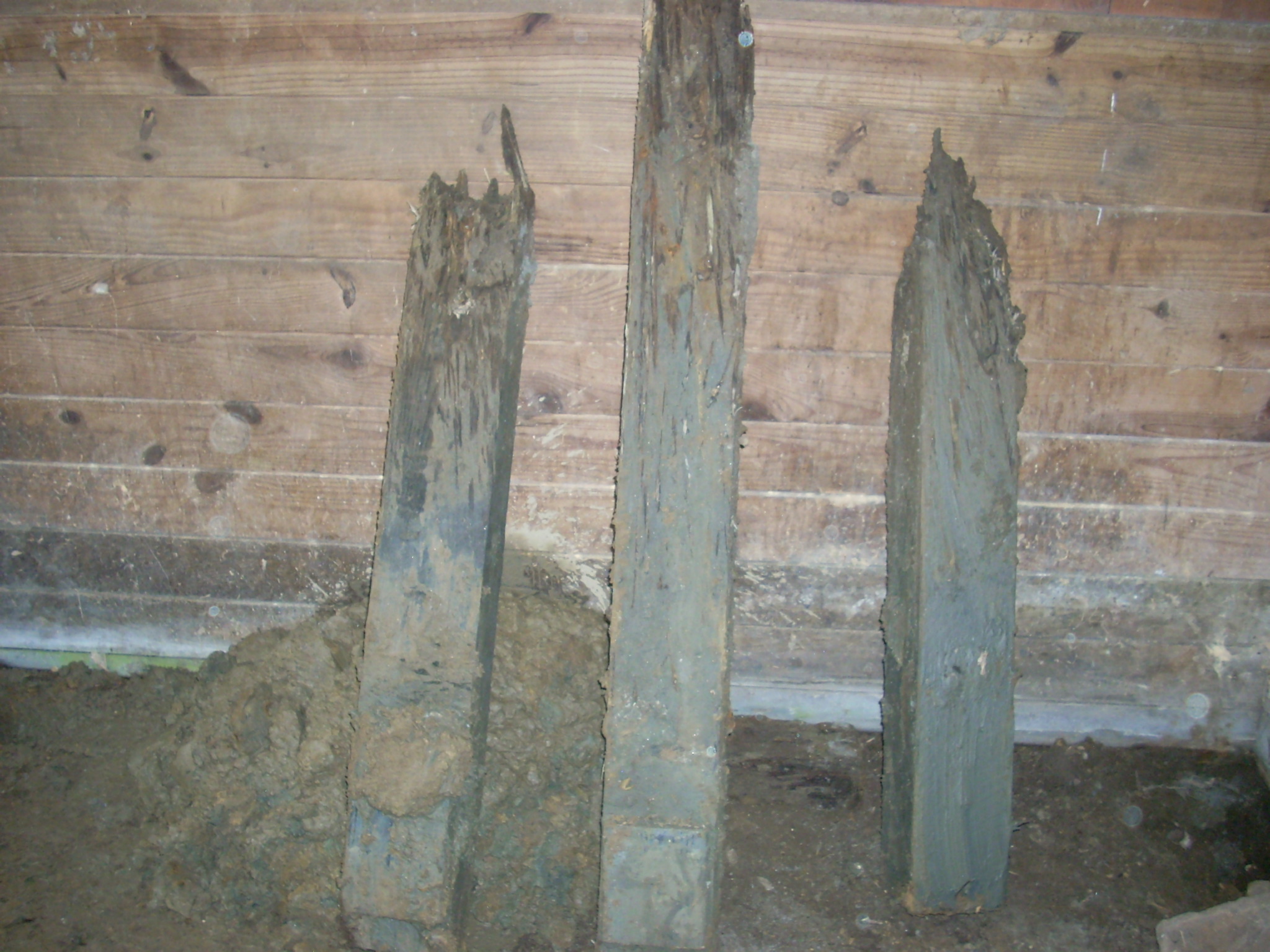

Next: the pieces I extracted were still healthy. No surprise, but only the 6" part of the post that was just above the ground rotted. I couldn't believe that even with treated lumber available, they used untreated posts. They didn't even dip the posts into tar.

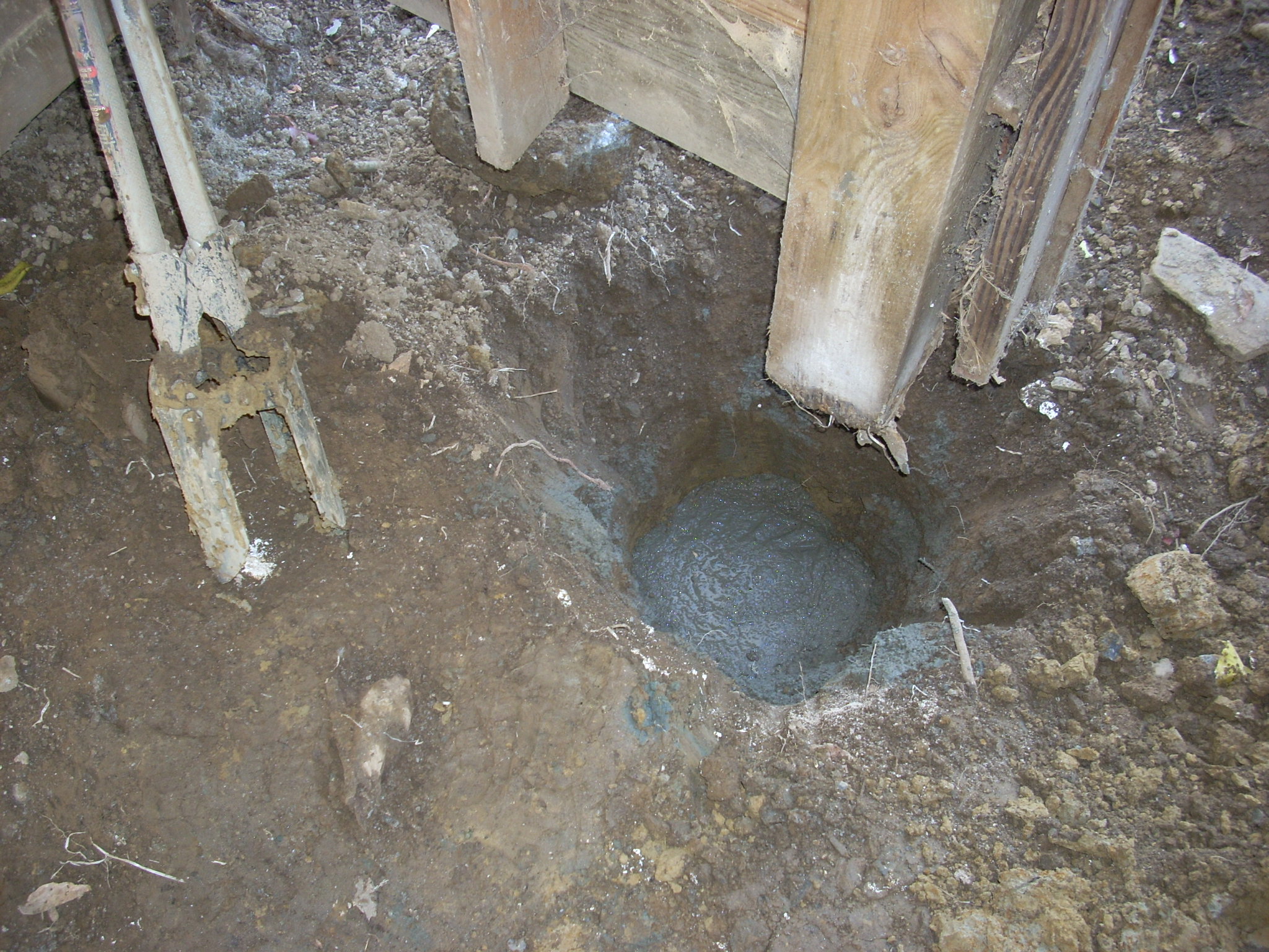

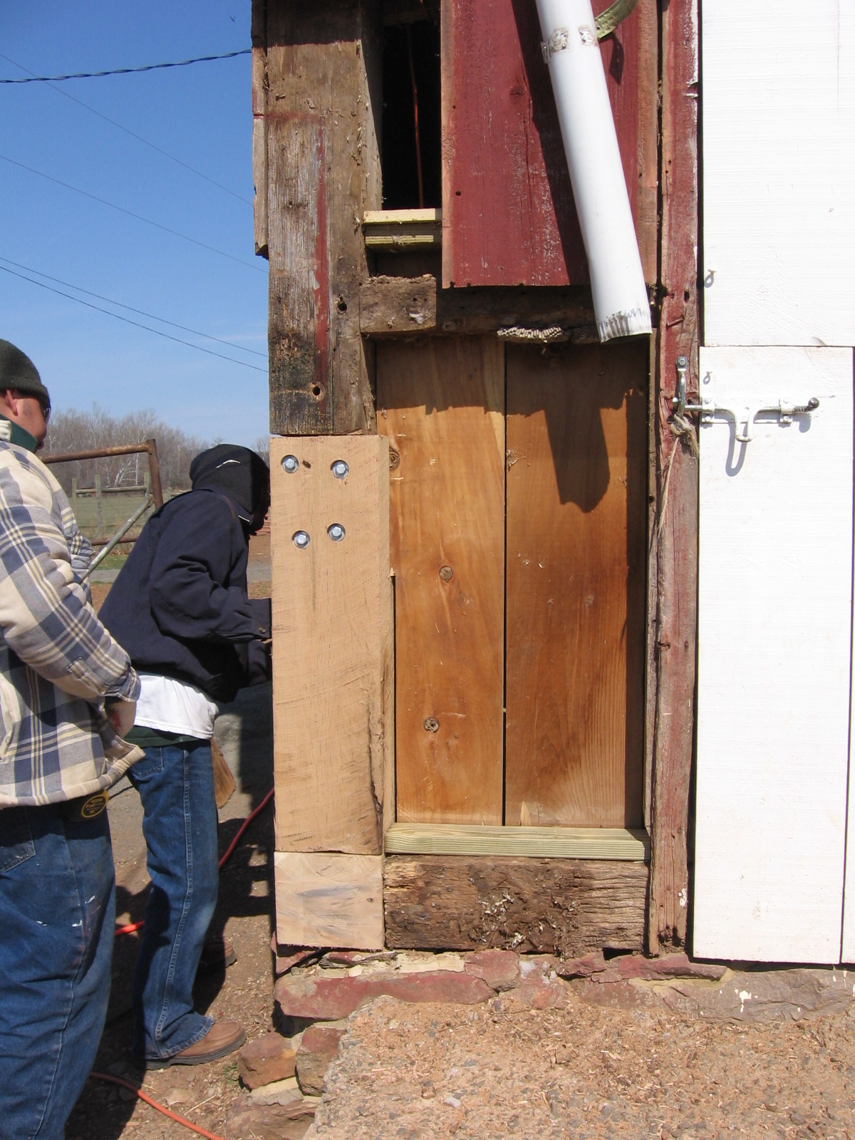

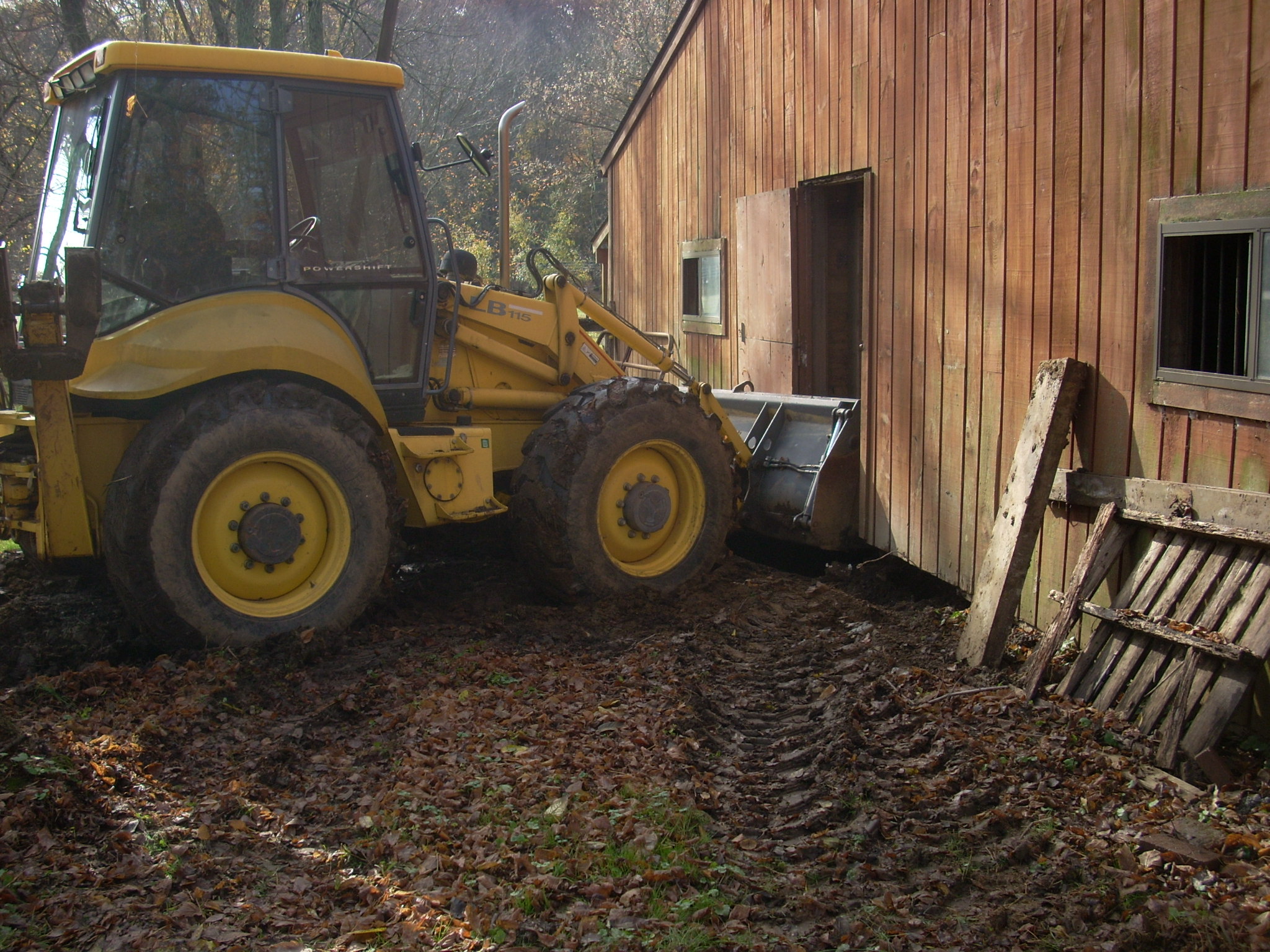

Much to my surprise, there was VERY LITTLE concrete used under the posts. In some holes, I couldn't find any. Also, the barn had sagged somewhat from its' loss of structural support and some posts were easier accessed from the outside. How was I going to raise the barn to re-level it?
First I cleaned the holes out then mixed new concrete for each footing. I put a new 15" thick x 24" diameter footing in each cleaned-out hole.

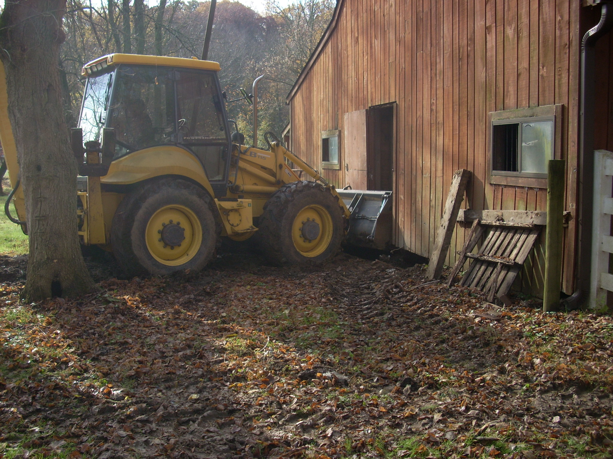

I used my New Holland LB115 "walmart excavator" ;) (thanks 20/20)to lift the barn up a few inches in spots that had sagged. Try that with a mini ex!!! :laughing:
I then installed new 8' ground contact 4x6" posts next to the existing posts on the dry concrete footings and bolted them next to the existing posts with 3 5/8" galvanized carriage bolts at about 2', 4' & 6' above ground into healthy existing post.
I did about 4 posts per day. Allowing concrete to dry, it took the better part of 2 weeks to complete the project. She's all done now and for a fraction of the cost of a teardown, I was able to rescue this barn.
Amazing how some contractors cut corners and leave the customer with huge problems to deal with later. Be sure you hire someone who will do job right the first time and be prepared to pay a little more for it.

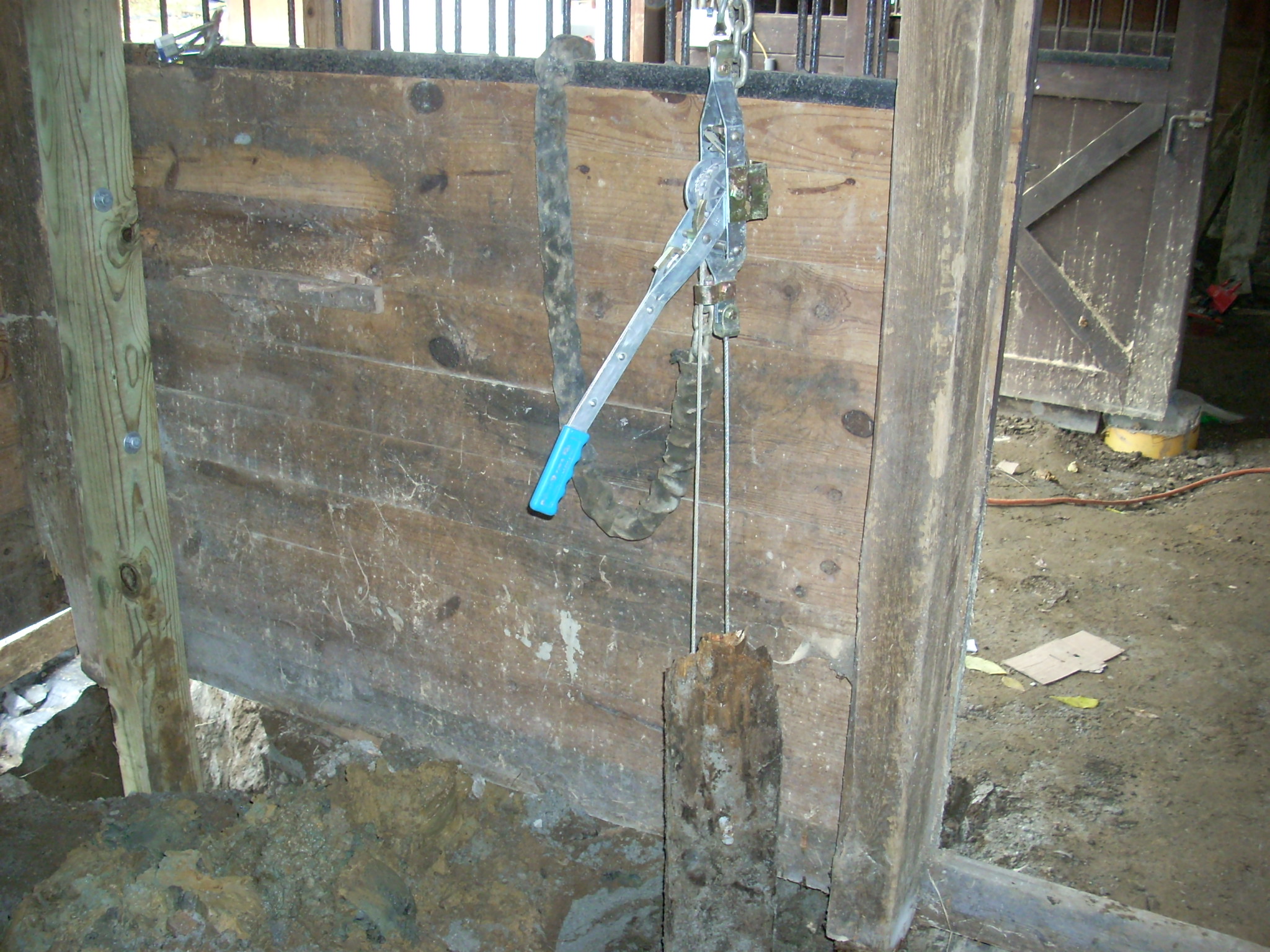

I was amazed to see how healthy the posts were below ground. Stating the obvious, but it takes moisture/drying cycles to rot wood.... just above ground level is where the damage is done.
In picture below you can see a sistered post. I added another one to that same posts since it is one of the direct support posts for the 2nd floor beam on the front wall. The come along was the tool to extract the posts. Couldn't have done it without the "high torque" version.

Scary part was trying to keep the barn from collapsing while removing load supporting posts. I made sure to only do one under each of the 4 supporting posts at a time.
