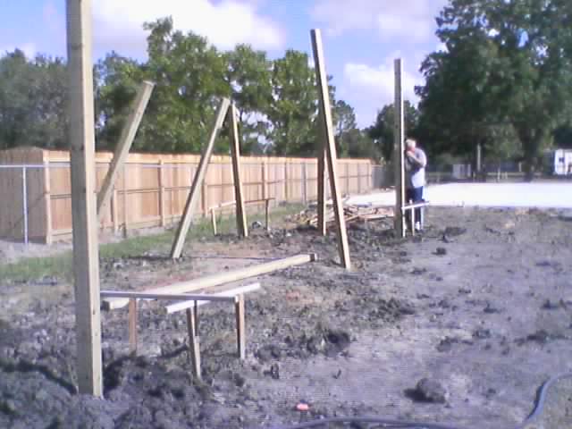

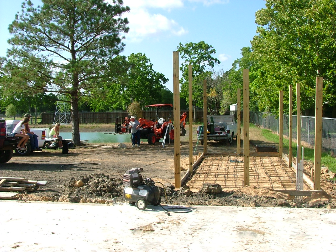

The gumbo mud was so hard we had to modify the pilot bit on the 12' auger with a Pengo pilot which help a lot
#3 rebar left over for the shop foundation went to good use.
Coming alone painfully slow

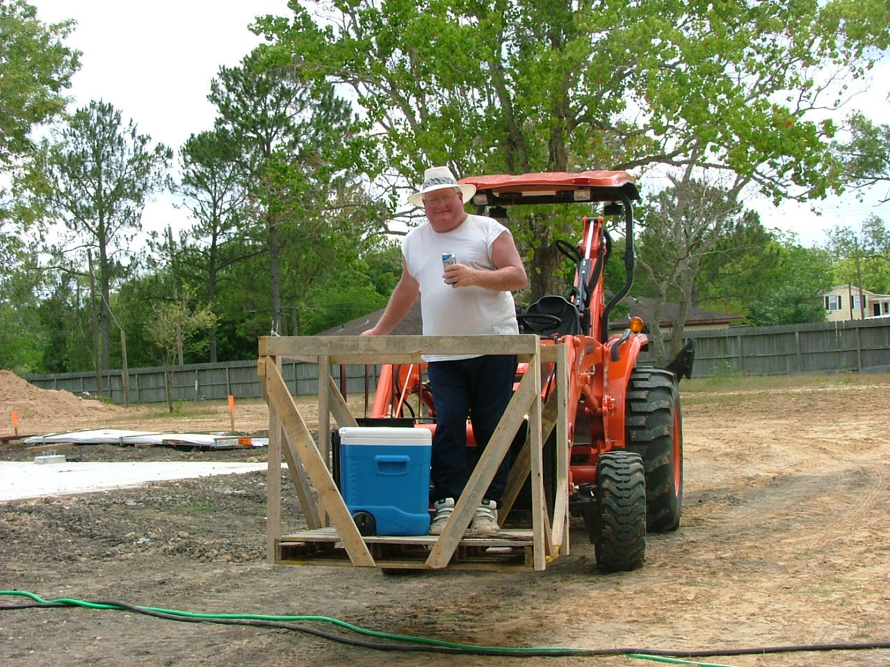

Safety police hold yur fire :) this I my version of the redneck manlift basket.. It worked fine hope to build a nice one out of DOM tubing after the shop is finished.

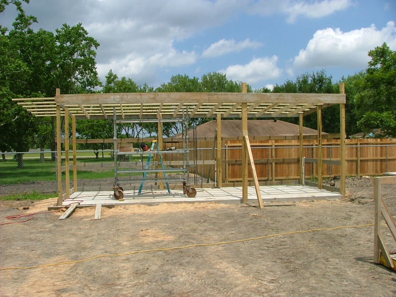

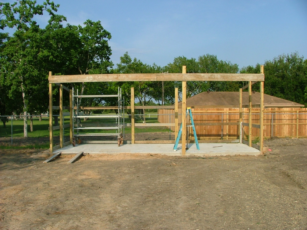

Ready for the roof metal then framing in the 10' enclosed area.
We used a framing gun with standard nails.. The question came up if the nails where hot dipped galvanized or stainless steel :eek: that are required for the ACQ treated lumber.. Well this was a real show stopper to say the least. After some searching on the net seems this is true. To improvise I used 3-1/2" deckmate screws which are compatable with ACQ treated lumber.
Now comes the question are there screw fastners the type used on metal shops self tapping with washer that would work with the ACQ lumber??
The only type I have used appear to be carbon steel with no coating of any type. IF ACQ lumber is as corrosive as they claim they would quickly be destroyed...
Thanks for any ideas.. Chuck.

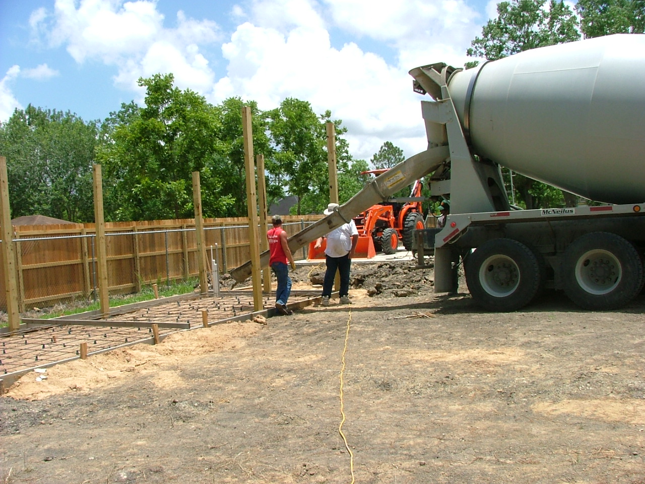

Another lesson learned... Never pour, even if its only 7 yards of concrete at 1300 hrs especially with only 3 people (2 had no concrete expierence)....Man was it hot... It was the only time available on that day, if I had to do it over again I would reschedule for early AM..
