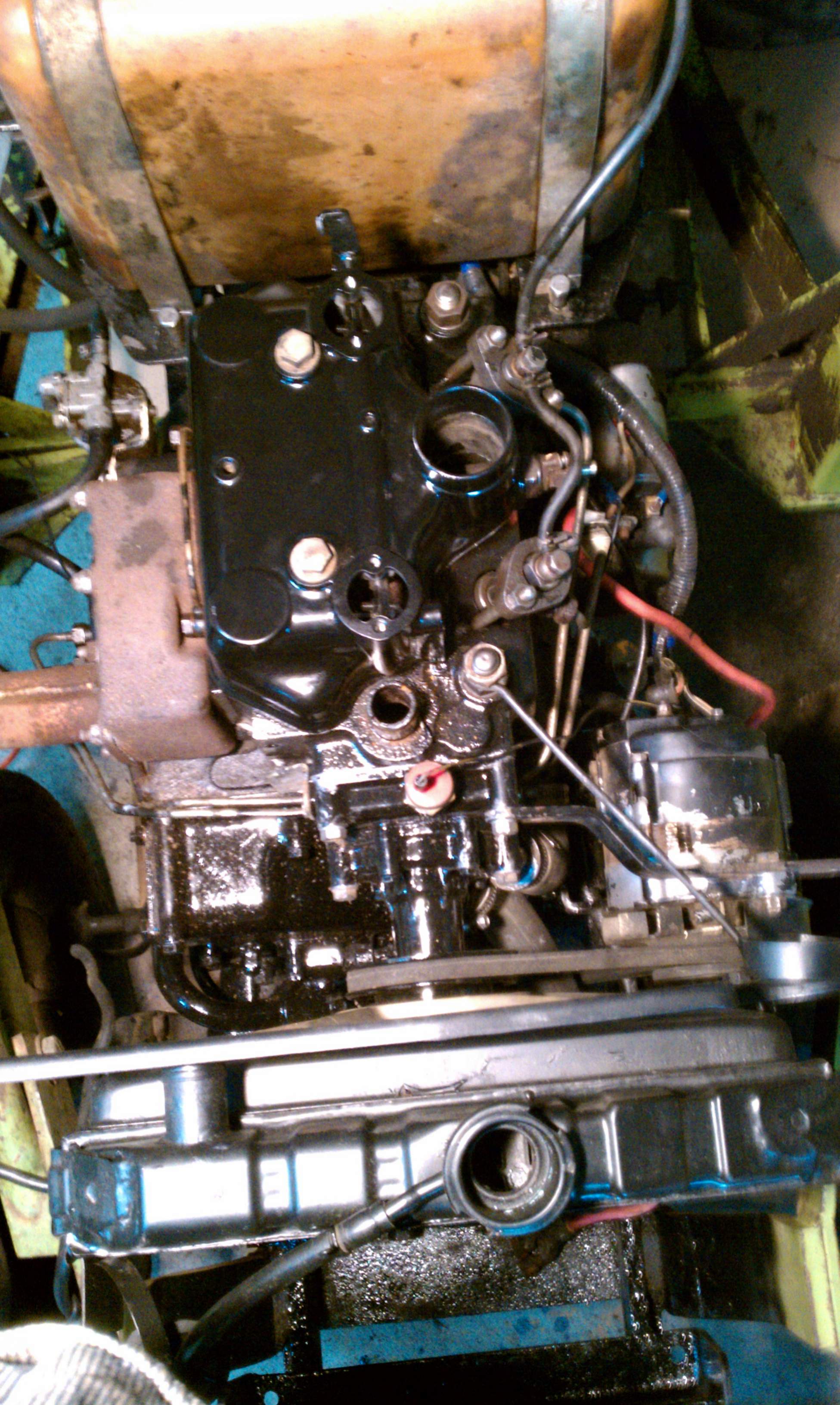

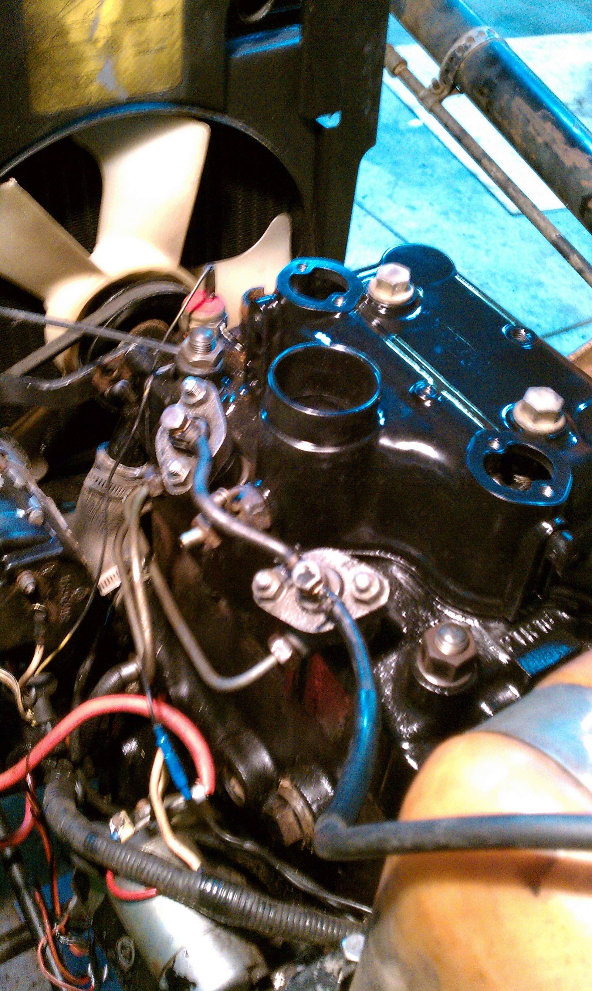

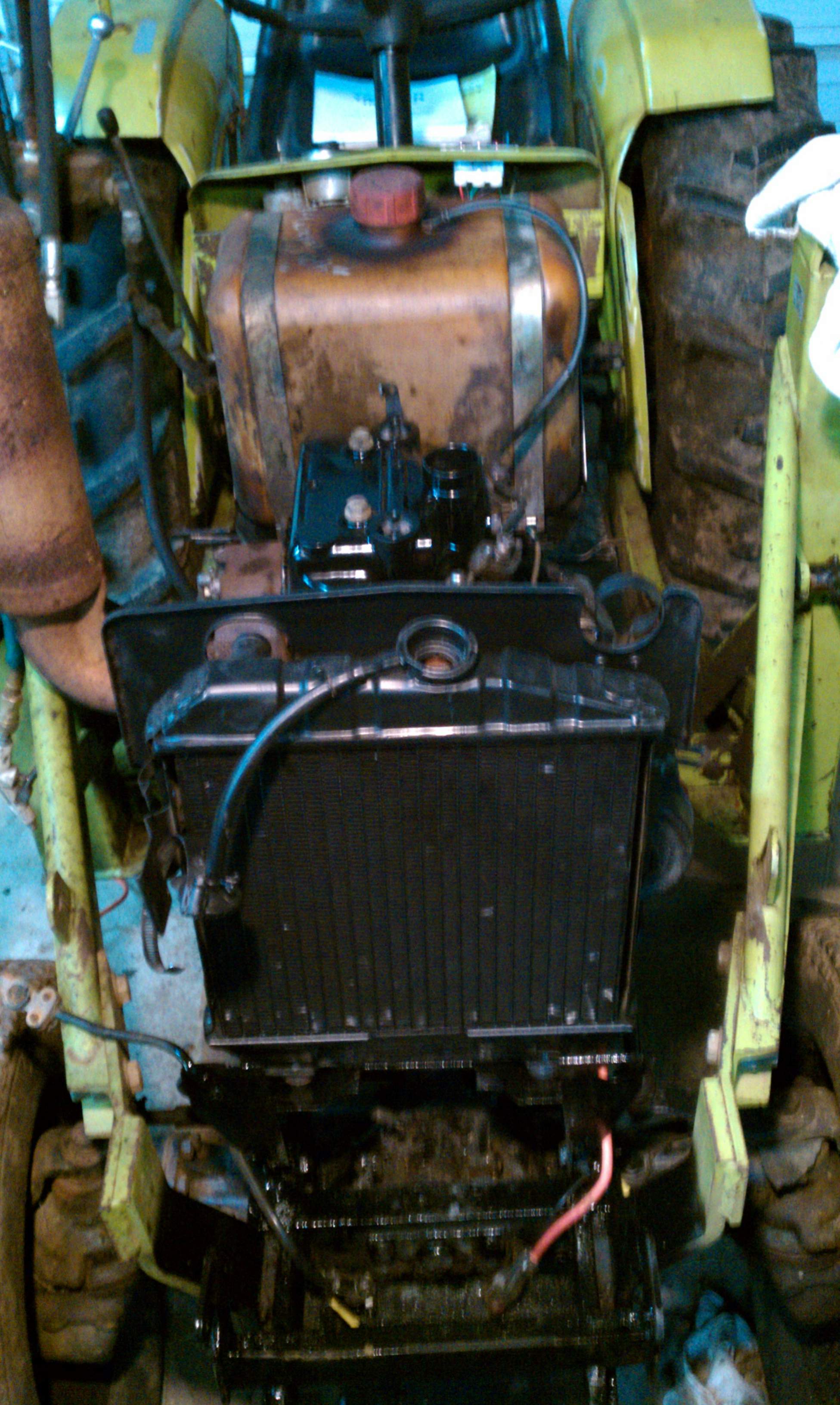

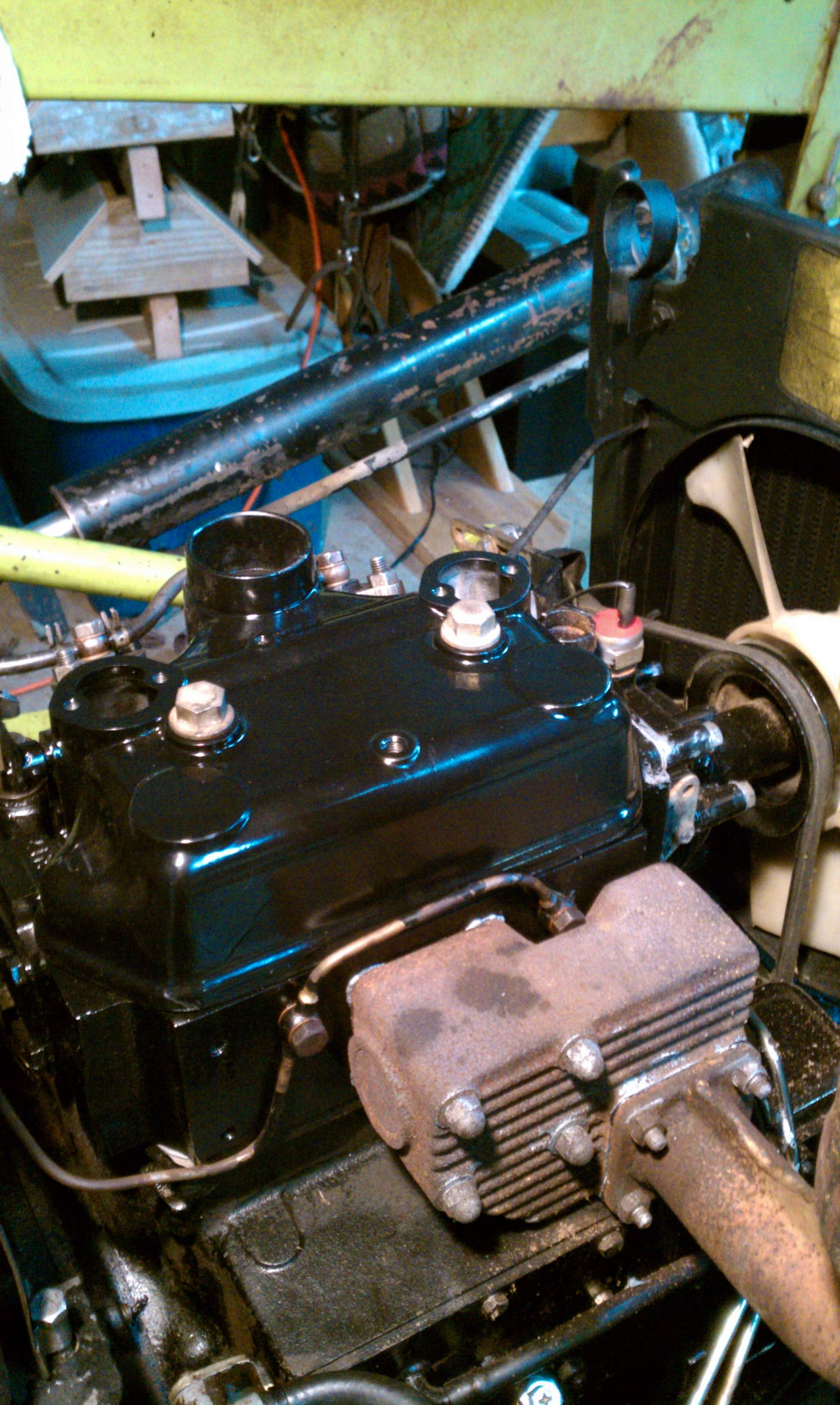

Well just to let you know how its going on the old 240D I got a month or so ago. I ended up getting more than I bargained for. What was suppose to be a tractor with a blown head gasket and a few minor problems.
So far I have replaced cracked head with reman one, and head gasket. figured might as well put new rings in and check rod bearings while I'm at it (so i wouldn't regret it later).
Figured since radiator out I better take it in and have it checked, since there was a cracked head and other signs of over heating. Well it was shot. So I had it recored with a larger core for more flow. Since water pump wasn't to hard to remove I opted not to replace it yet.
The steering wheel spun round and round with no effect. Knuckle and shaft shot. So I rebuilt steering box with new everything. I ended up having problems getting the right shaft. I ended up having to do some fabbing things different, someday I'll do a thread on that.
Of course fluids and filters all been changed. Anyway I finally got radiator back today. So tomorrow I should finish getting it back together and try to get it running. Everyone cross your fingers. I will try to video start up when we go for it. I am pretty anxious to get it running. Here some pics of where I am at so far.

Let's hope you don't regret the bigger radiator core. They normally run too cold anyway, with no thermostat.

But these two-cylinder Yanmars are simple to rebuild and have a minimum of parts. No thermostat, no fuel shutoff solenoid, no fuel lift pump, not even a water pump on many of them. There's really not much to go wrong. An in-frame overhaul replacing the two wet sleeves, pistons, etc is inexpensive and should give years of like-new service.

Well it was to the point of ready to try and start. I cranked it a bit with decompression to build oil pressure,then pulled compression. I did this 3 or 4 times with no success. Just white smoke bellowing out the exhaust. I even used the thermostart. Finally as a last resort I used a shot of starting fluid. Guess what? IT FIRED UP and actually ran. Purred like a kitten:thumbsup:
Runs great! I see that before i get it out I need to do some hydraulic leak repairs next.
