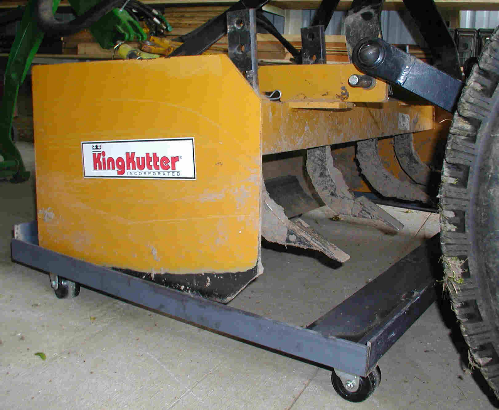

I have a new JD 4110 and just detached the rear mounted mower. I tried to hook up a neighbors 4 foot box blade and seems adjustments need to be made. The center link seems easy enough to adjust. However each side arm needs to come inward about 2 inches so the pin on the blade bracket will go thru the eye of the lift arms. What adjustments need made? Thanks

Did you adjust your sway chains on the lift arms to let the arms come all the way in ?

Once you get the arms adjusted to the correct width, the generally accepted procedure is to get the side links close to the right position by carefully backing the tractor into position, then beat the living @#&$ out of the hitch components with as large a hammer as you can find until everything lines up. If you know any good drunken sailor phrases, they will likely come in handy during this procedure also. Seriously though, it really does get easier with practice. My tractor has pins you remove to allow the lower links to move closer together or further apart. I believe this is called adjusting the sway. Perhaps your tractor has something similar?
   / procedures for installing Box Blade #5
You must pull the keeper pins and turn the sway turnbuckle to get some slack on the hitch arms. Then, you must adjust the turnbuckle and limit the amount of sway on the implement after it is attached. Then reinstall the keeper pin. By the way, run down to your local hardware store, spend $30 and buy a 6' digging bar. With one of these bars, you can move heavy implements into place without straining your back. Best $30 you'll ever spend.
   / procedures for installing Box Blade #6
The 6 foot digging bar is an excellent suggestion. Also, if you keep the box blade in a shed with a concrete floor, go to Tractor Supply and buy four heavy-duty steel castors at $5 each, mount them under an old pallet and use it as a dolly under the box blade. This really makes life easier. Even with the dolly, you still might want to use the digging bar to help with those final small adjustments.

Thanks to all. I adjusted each turnbuckle to make it fit. Now, to adjust the sway, I guess I should readjust each turnbuckle, right? Also, sitting on the concrete, the blade does not go any lower than the tires. If I want to take more bite out of the ground, can I position the tractor so the implement has room to drop below the tires and then lengthen the center link?

In answer to both questions, Yes.
   / procedures for installing Box Blade #9
Like this?
