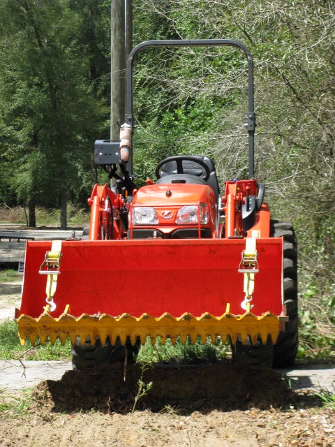

Since you will have brush to clear and move consider a Ratchet Rake in place of the York rake. Ratchet Rakes are sold at Tractor Supply for about $300; they are versatile and effective. While removing brush and maintaining woodland trails are my primary uses, I also use mine to "scratch in" seed for deer plots.
For brush I plow through with the RR in position shown in photo #1. Both top and bottom teeth engage the brush. Some is pulled out, the balance is toppled over or pushed ahead. ( This is twice or three times as effective as the bucket edge without the RR. ) Then I lower the bucket/RR nearly to the ground so the lower teeth on RR are engaged and reverse out. Whatever brush did not pull out going forward pulls out in reverse.
There are about a bazillion TBN posts for the Ratchet Rake.
Tractor is Kubota B3300SU package, 33-hp, 1,800 lbs.
