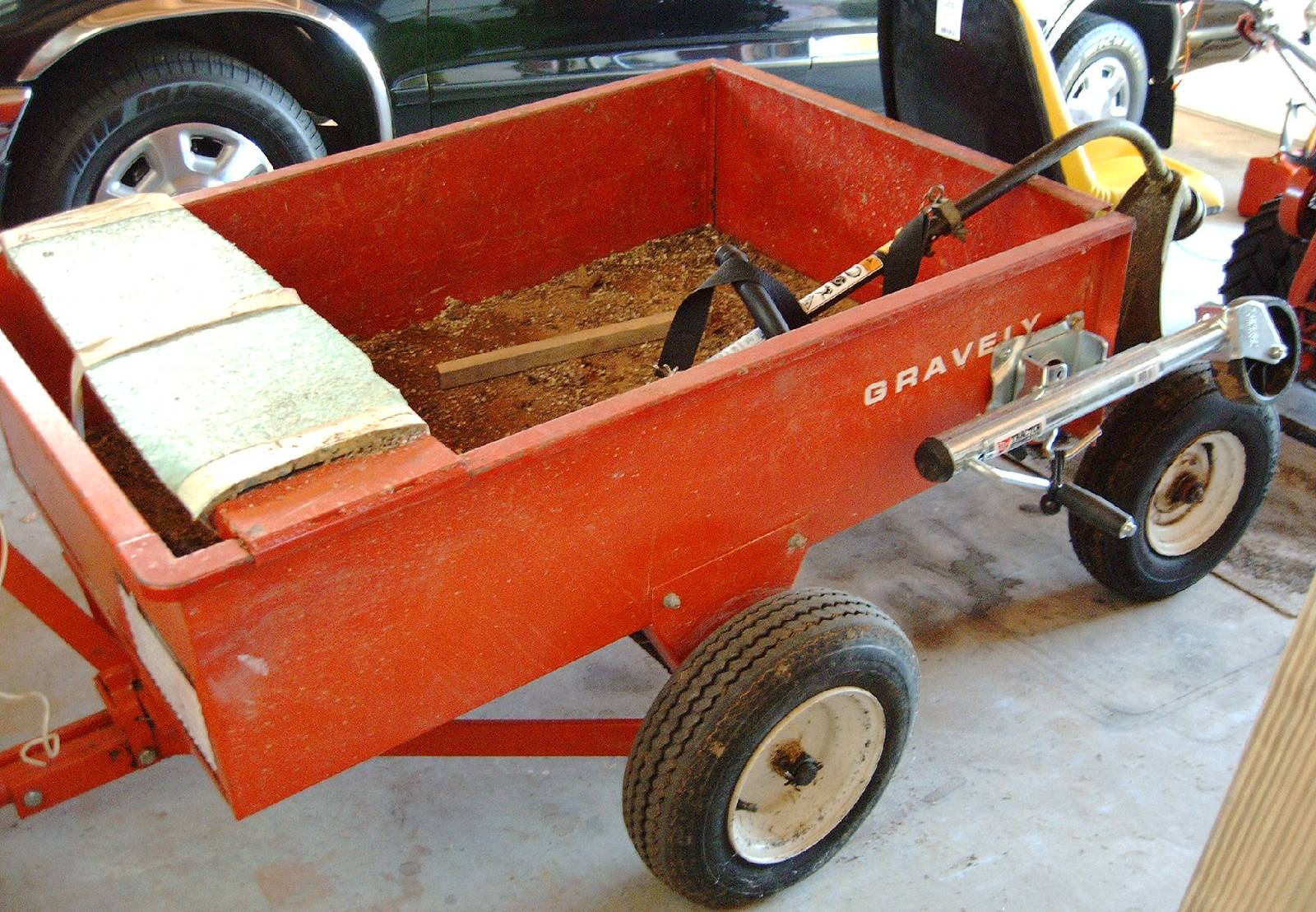

You could attach 2 of those trailer tongue support wheels to the front sides of the brush hog, similar to the one shown attached that I put on my Gravely cart.
I put this guide wheel on to keep the cart from tipping back if I had it attached to the 3 ph drawbar.
The wheel is rotated to the back of the cart in this photo. It'll rotate down. Think it is height adjustable. You'd want to find one with probably a more heavy duty wheel.

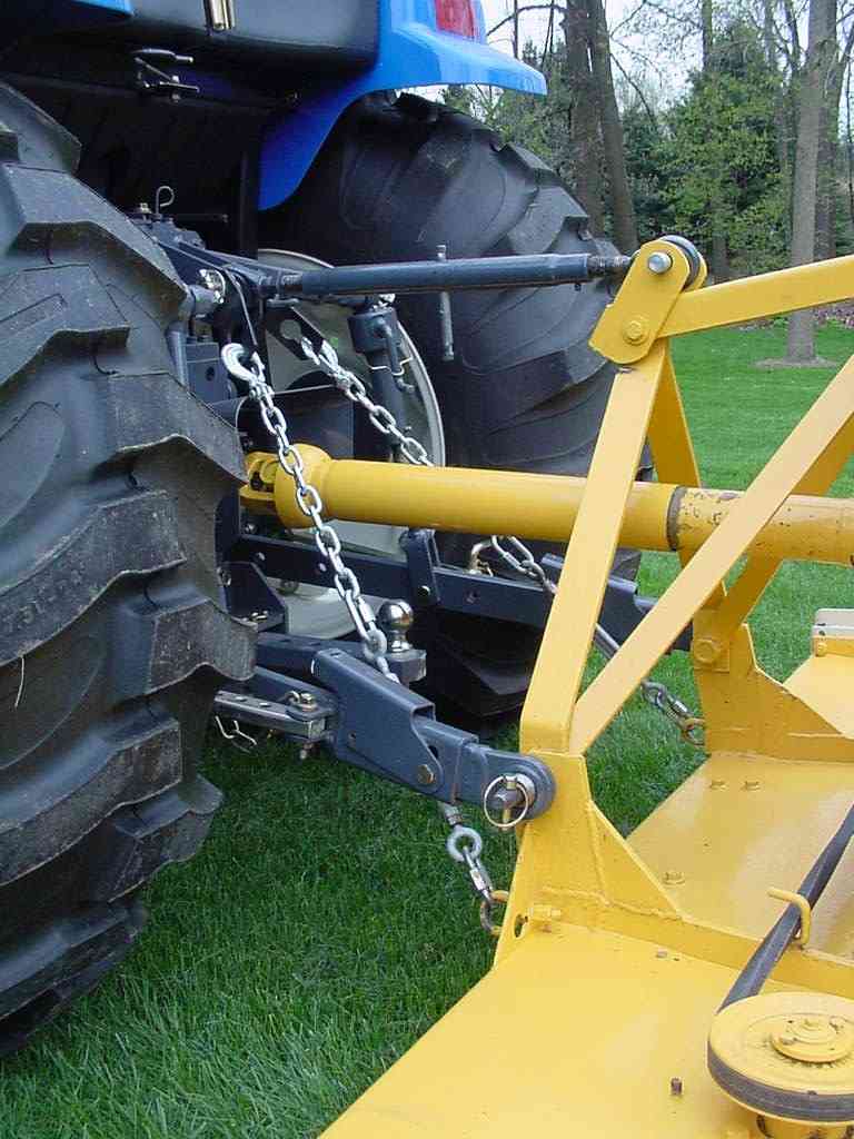

Add check chains, then no more "hanging".
This pic is of my RFM, but my brush hog is the same, except without the turnbuckles. You would still want a rear wheel too.
