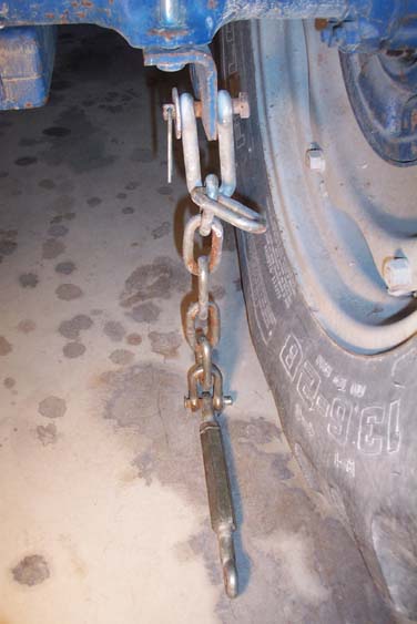

I have a customer who has an old Ford 2000 with the stiff stabilizer arms and I'm trying to help him with a box blade we sold him. He is having trouble hooking up the box blade to his 3 pt. hitch and the whole problem is the way the aftermarket stabilizer arms are on the tractor, they don't allow the lift arms to come our far enough to hook up to the lift pins on the box blade.
Does anyone have any suggestions? I've looked around for some other stabilizer arms on the web with not much luck aside from finding the same style stabilizer arms he already has on the tractor.

RedRiver,
I own an old Ford 2000 and have no problem hooking up to the box blade, but don't use stiff stabilizer bars. Instead, I use stabilizer chains from TSC.
Is it possible to get a picture of his setup?

Tell your customer to look at the stabilizer chains. TSC really likes them since they charge so much for them. Maybe you can get him a set for less.
I mounted them under the axle. Will take some pictures of my setup and post them when I get home tonight .

I bought them at TSC several years ago. Like so many other useful products, they apparently stopped carrying them.
My chains have a screw adjustment on them. You'll see it when I post the pictures later today.

RedRiver,
Here are the pictures I promised you.
The first pic shows one mounted. As you can see, I have to take it up a link because it is too long.
The second pic shows the entire assembly. The links are really hefty.
The third pic shows the turnbuckle. It has about 8 to 10 inches of adjustment in it. There is no problem adjusting to any lift pin width variations. If the lifting arms can attach, so can the chains.
The fourth pic is a detail of the chain assembly.
TSC doesn't have them in their catalog or Website, but I did buy them there. Maybe if your customer took the pics to his local TSC or farm equipment store, they could help him find a set.
