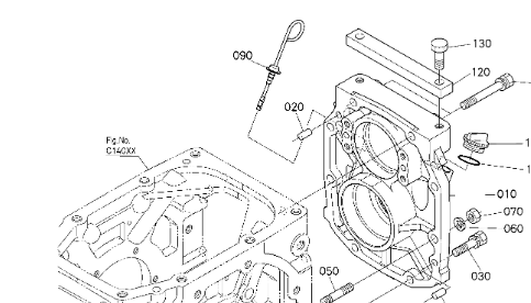

I suggest to check engine air intake & filter for blockage. I'm curious does your tractor have a hyd oil dipstick(key 090) similar to my M7040 because you mentioned adding hyd oil but not checking hyd oil? It should have a dipstick.

It (2010 Kubota M6040) does have a dip stick, but it is so small (short), I'm not sure what i can actually measure.
