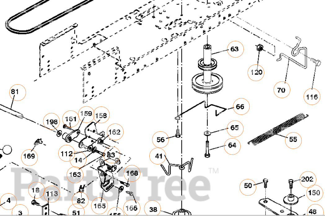

There should be a bracket that comes down on both sides of the engine pully. This bracket keeps the belt from grabbing the pully when you have the clutch pedal depressed. It is item 66 in this parts photo.
If this is not in place, you will experience the problems you are having.

I checked and that bracket (It 66) is installed on this mower, so that's not the issue. I suspect that its the belt being too short, as mentioned in an earlier post by another member. I haven't had a chance to remove the belt and measure it because I need to figure out a way to hoist the front end up high enough to where I can access everything better. I may need to go buy a chainfall or electric hoist wench at Harbor Freight. Thank you for your input, though!
