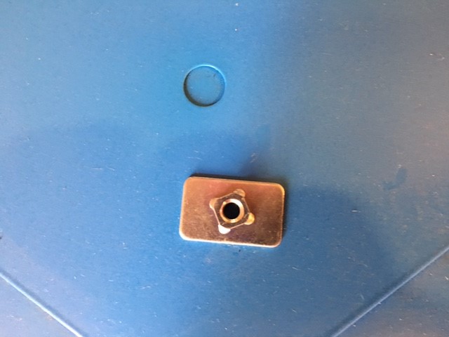

I went to go cut the lawn and dropped down the mower deck and a bolt or something came out onto the ground. I have no idea where this came from and cannot locate the piece in the owners manual.
Anyway, the issue I am having is the the height I set the deck at, will not stay at the height. I normally cut around 3 1/2 or so. For some reason the mower deck will drop down to the minimum, even though it is set at 3 1/2. More than likely the piece that fell off the tractor has something to do with the turn knob that adjusts the cutting height. See attached image below.
any idea what this part is or what affect it can have on the height adjust knob? Please help, as I cannot cut the lawn, as it will not stay at the correct height - keeps going to lowest setting. I'd hate to have to bring to the dealer over this, even though it is still under warranty (33 hours). Thanks for your help!!
   / Problem with Cutting Height Adjustment - B 2601 #2
Maybe the adjuster is a bolt that screws into that part? Looks like a "captive nut" that you found. Is the bolt still there? Imagine what it's threaded into and try to get that piece in that place. Flat side toward the knob.

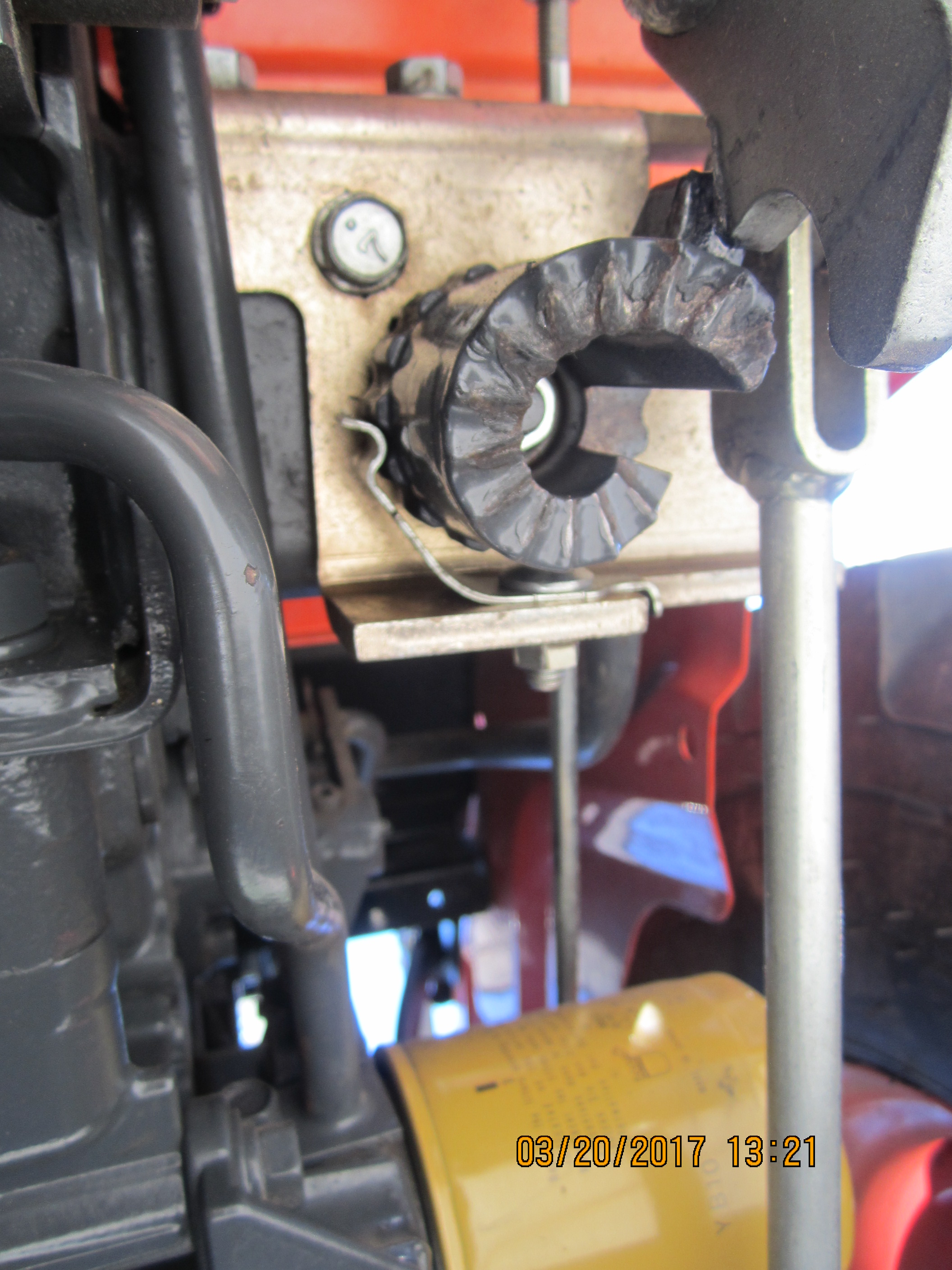

MarkinMass.......I had the same problem earlier this spring.......My B2620 has 580 hrs, most of which is mowing. In the photo you see a cam that I replaced (probably not your problem); and you will also see a nut that goes up the center that holds the whole adjustment, knob (bolt) and all together.013.JPG.
Your deck may have some slightly different parts than mine, but the mechanics is probably the same. A new tractor may have some bolts that come loose right after it is put into service. Your actual part I can not identify either in the OE MMM manual or the tractor manual. The dealer has more computer diagrams than most of us have.
If that adjustment knob bolt/nut comes loose, the deck will not stay up. For now, just tighten it up (metric) and see if that works. The part in your picture probably has something to do with it however.

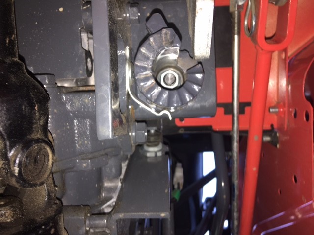

That seems very similar to mine.
I tried to tighten the nut, but it seems really tight already. I think I will take a trip to the dealer in the next couple of days and see if they have one on the lot. I can either take a look or see if I can speak with one of their techs. At the very least, I can ask them what that piece was that come off of my tractor.
