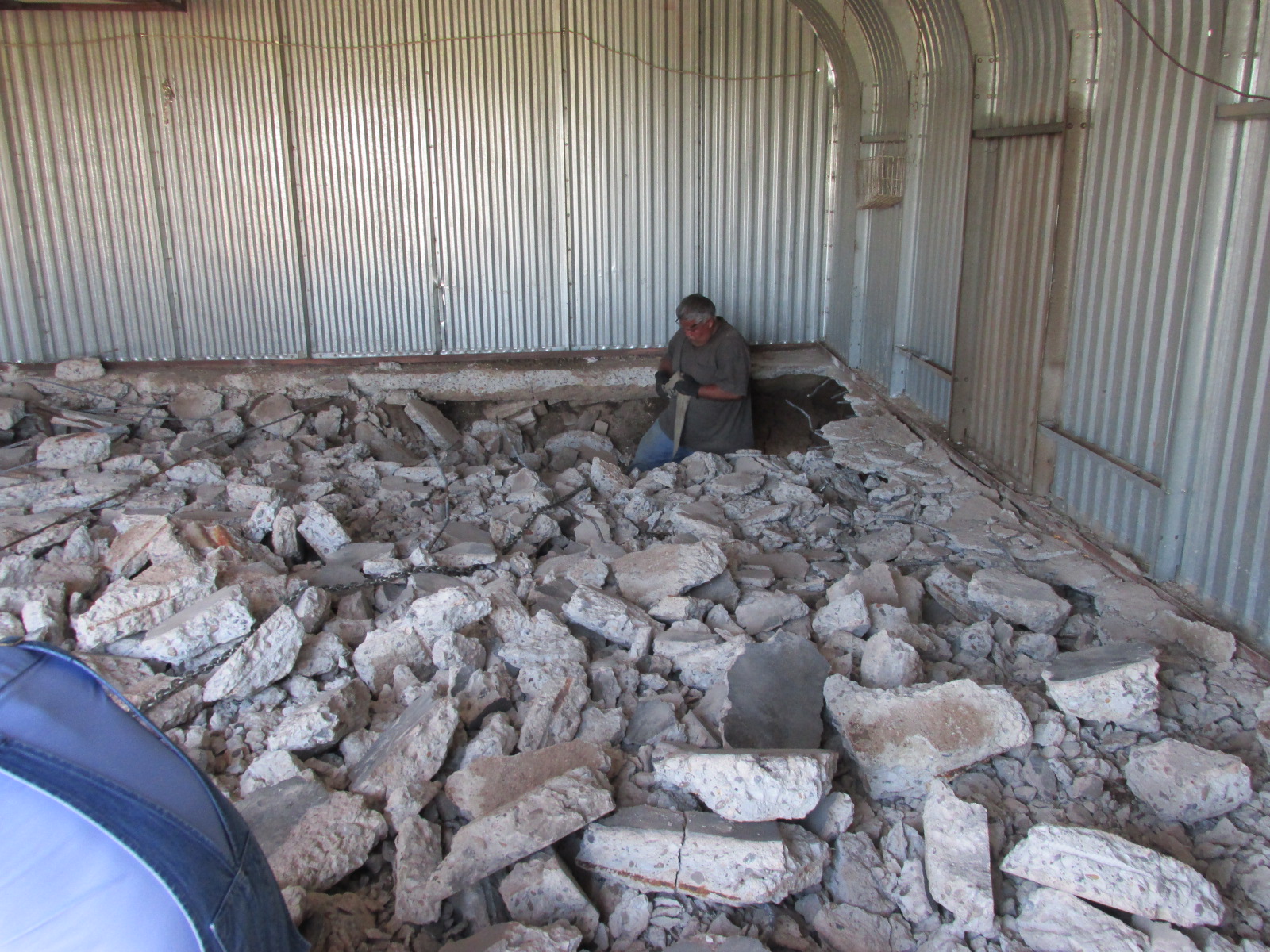

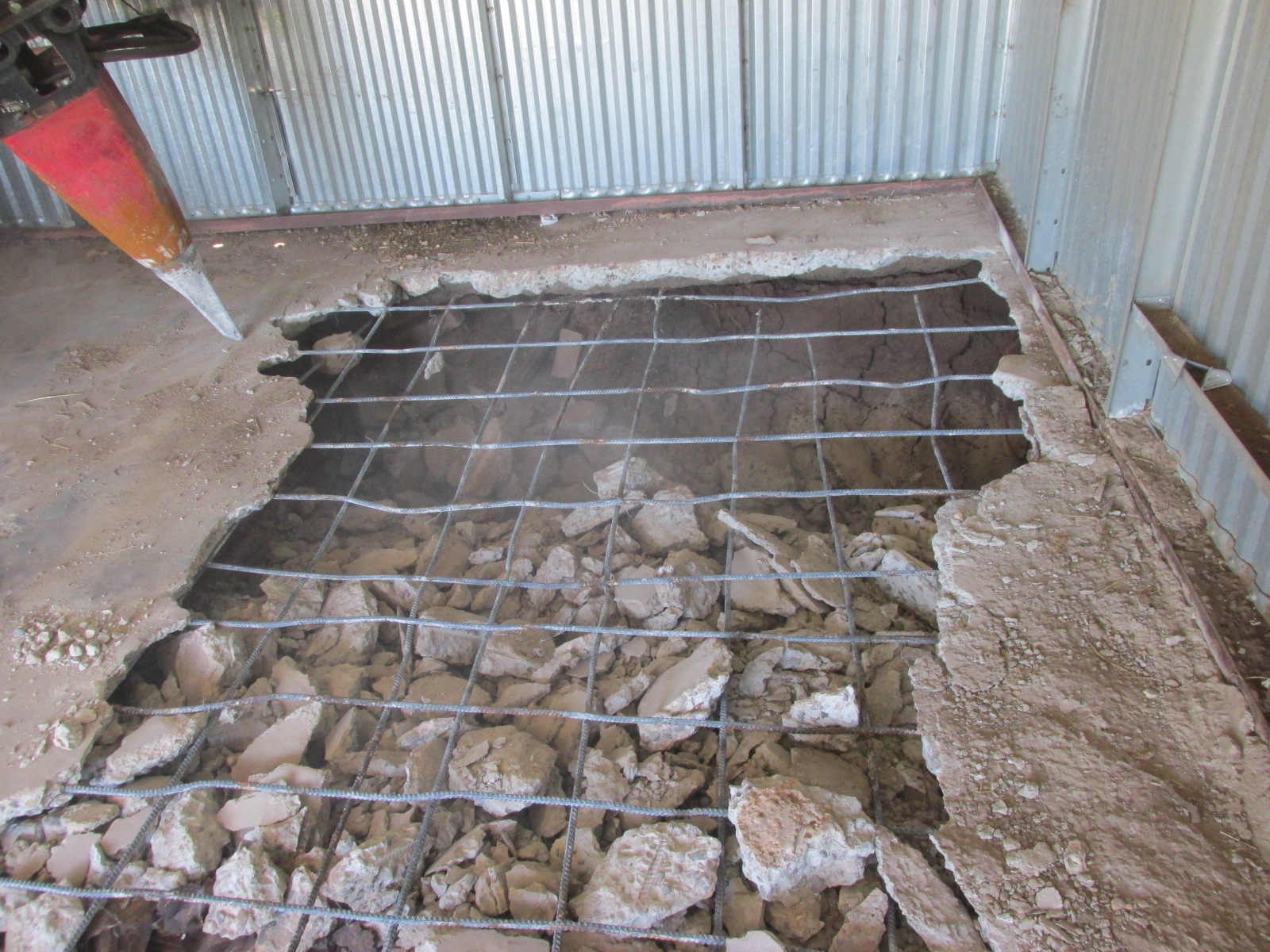

Jack hammered the entire floor.

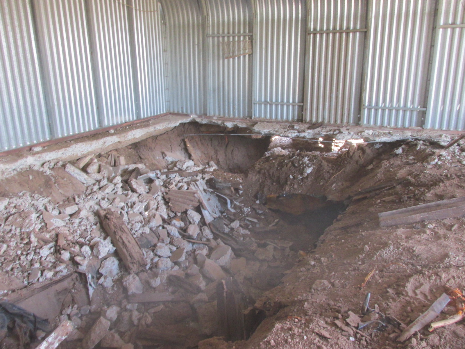

Notice cavity under the floor.
Destroyed what was left of the container top and pushed all of the busted up concrete into the hole.

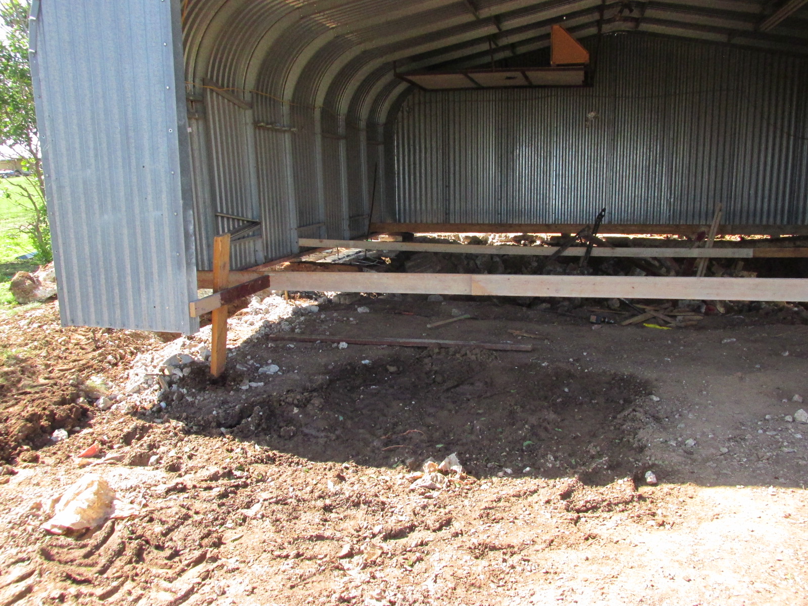

Lifted the front of the shop and blocked it up.
Almost ready to pour concrete.
The pad and building will be moved forward about 10' to be on solid ground.

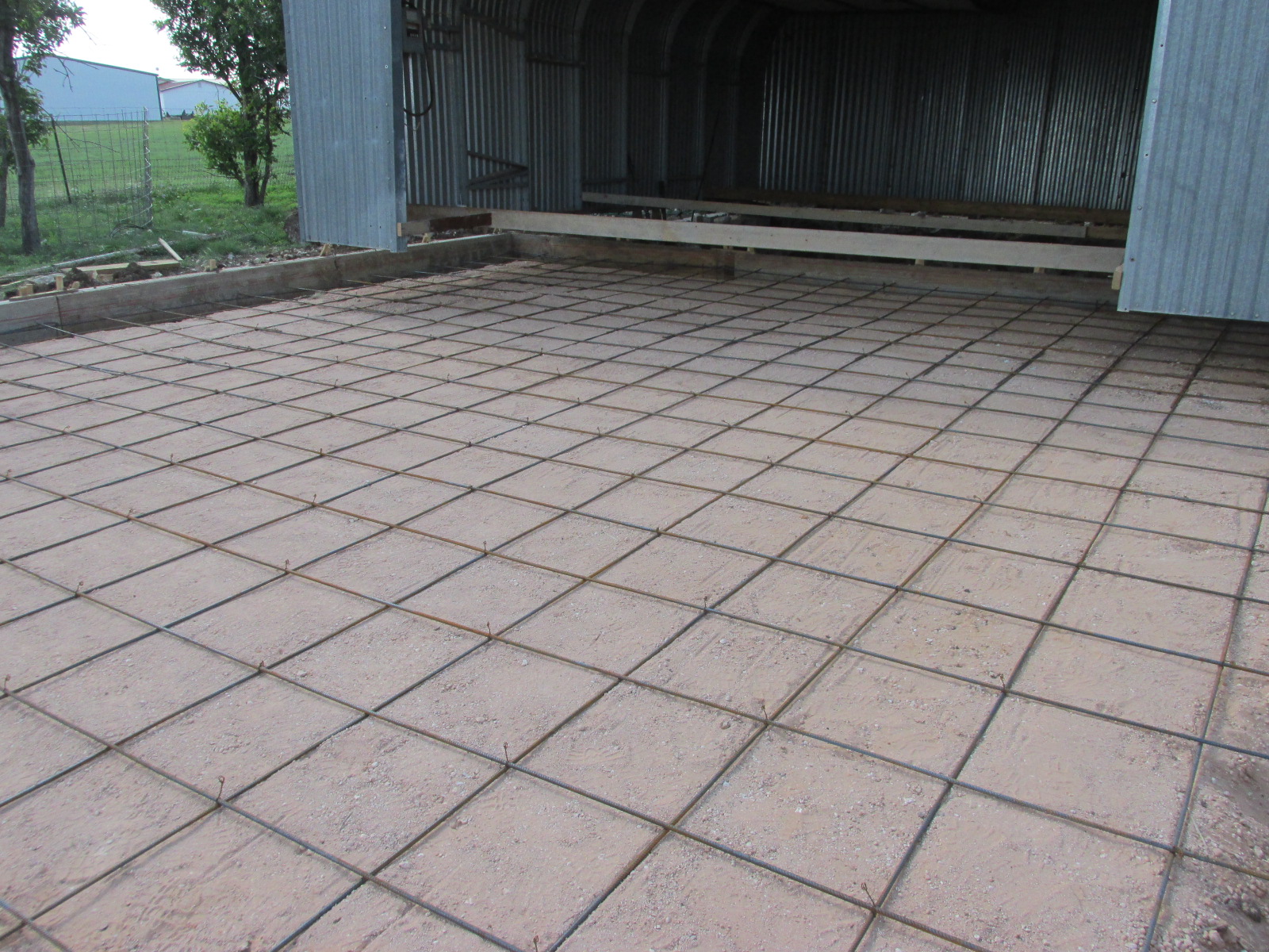

I will pour to day if all goes as planned

No chairs under the re-bar?
   / Problem with concrete floor in a quonset shop bulding 24/30 #5
Did you find Jimmy Hoffa under there?
   / Problem with concrete floor in a quonset shop bulding 24/30 #6
I agree on putting something under the rebar to keep it where you want it. Concrete will take it down without support.
I put the chairs under the rebar just ahead of the pour.
We poured today..12 yards.
There is a thunder storm brewing now..sure hope it has dried enough to survive it with no damage.
We have it tied down because of the wind.

The building is what is tied down. As you can see it is up on blocks.
