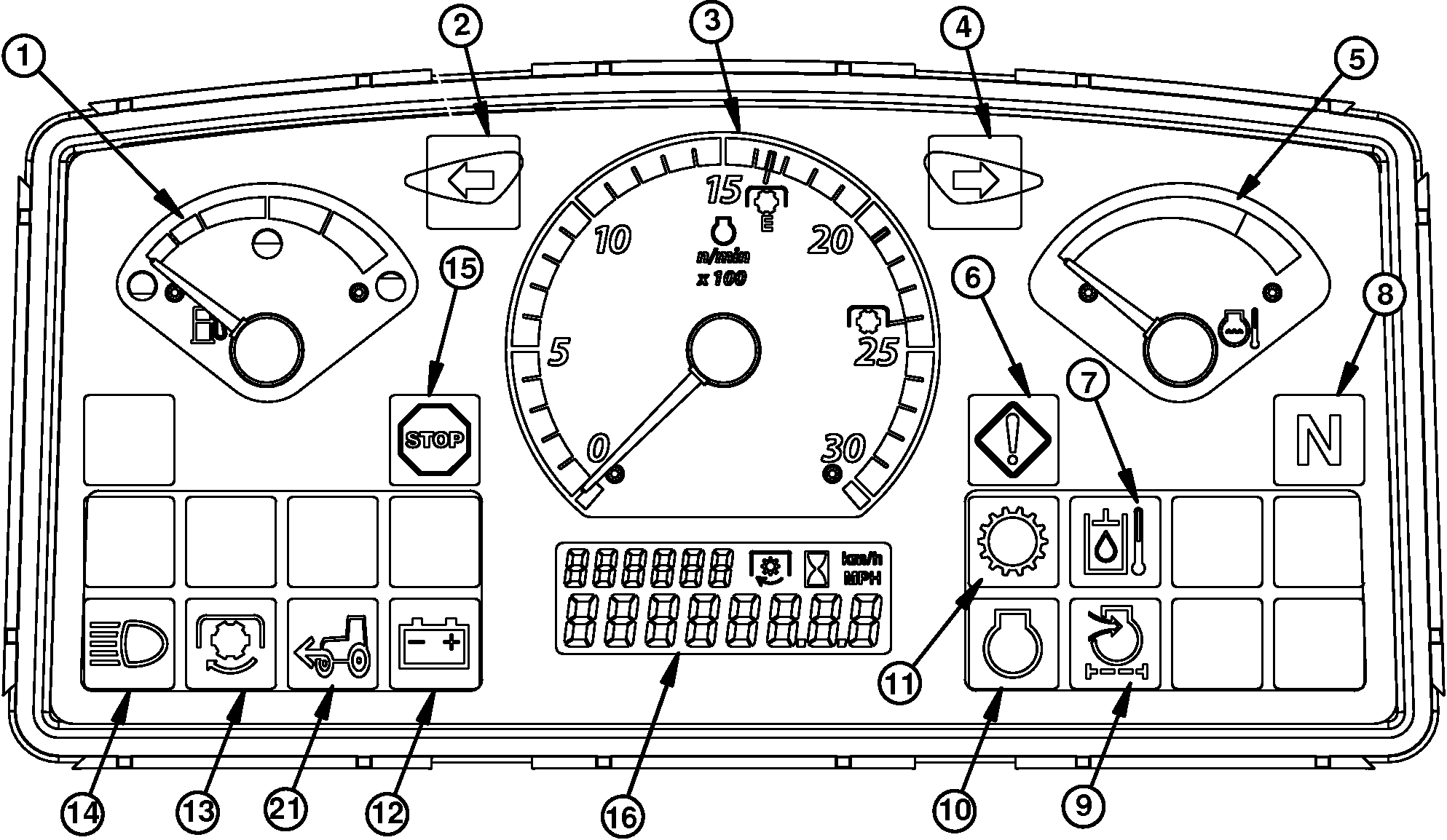

I just bought a new 5055e the other day, and now it has started beeping and blinking at me whenever I go about every 1500 ram or try to lift a heavy object.
The engine and hydraulic oil levels are OK, and there's no sign of overheating. Can't find anything in the manual, and the dealership mechanic can't figure it out.
The only warning light is an orange triangle with an exclamation point that flashes.
What should I do?

Is that a consistent thing? Everytime... Lift a heavy object - with the front end loader or on the 3pt hitch?
Seems like I'll get that "orange triangle" when I'm squirming around on the seat trying to get a better look at the front of the loader or turned around looking at the back of the tractor when I'm moving dirt or tilling, etc.
While my 5075 won't shut down if you get off the seat when using the pto etc. it will beep at you and you'll get that triangle business if you lift up and momentarily lighten up the seat.

Does your tractor have PowrReverser if yes, I have attached the operators manual and attached a picture of the instrument cluster. If it is light marked as number 6 it is a service alert indicator. What it is alerting you to I do not know.
How many hours do you have on it? It could be just to remind you to change some fluid.

What kind of local dealership do you have?? They can't determine what the flashing warning sign is - call an alternate dealer or call your regional service rep. Hey, its still under warrantee isn't it?? They will have to correct this condition. Your OP manual should tell you what that flashing triangle means.
