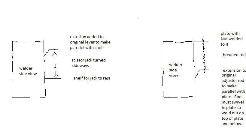

At this point if nothing bears fruit it is time to think outside the box with a cheap backyard new design to operate that lever as well as hold it in place:
a) Option #1: Carefully mount a salvaged car scissor jack (maybe $5 from a junkyard) on an angled shelf attached the front of the welder. Then use the jack crank to adjust the lever. This system if done right will eliminate the need for the locking lever altogether and likely even give more detailed amp adjusting capability than the original lock did.
b) Option #2: Sorta could do the same thing with a threaded rod adjust system with a plate mounted to the top of the welder. (Note: the thread rod system will allow more for angle changes on that adjuster lever if staying parrallel to fixed plates is not possible. Slots instead of holes can be incorporated into the fixed plate and into the extension on the adjuster lever to allow for angle changes
I will try to add crude concept sketches:

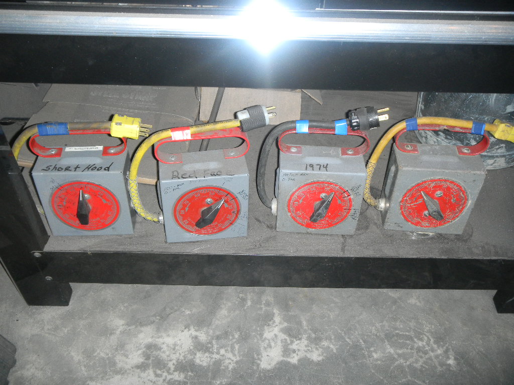

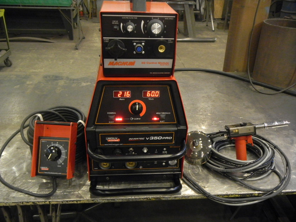

You know what you need? A machine that has a remote, you can adjust the machine as you're welding. ;)
Yeah those look to be just the ticket for a pro level welder, but quite pricey for a backyard hobbyist like me using only a low cost Miller Thunderbolt (buzzbox). Actually, My buzzbox is never more than a few feet away from me. All the manufactures pretty much universally recommend extending the supply power input cable over using longer than standard welding lead lengths on the buzzbox class of welding machines. Hence, I always run stock welding lead lengths and use an extension cord to move the welder close to where I will be welding.
It is No problem to take a step or two away and turn the crank on the welder as long as the adjuster easily operates with only one hand. That said, I do not want it to have to operate with more than one hand as I do not want to have to bother with trying to find a spot to lay the stinger down (especially in damp grass).
The OP AC buzzbox is not really worth much in the way of money ($75-$100 or so max), but it is certainly worth fabbing up something low cost from the scrap pile that solves the issue and actually makes the welder functionally better than it was originally in this case. (I always hated those Century adjuster slide mechanisms even when they were brand new - let alone well worn).
