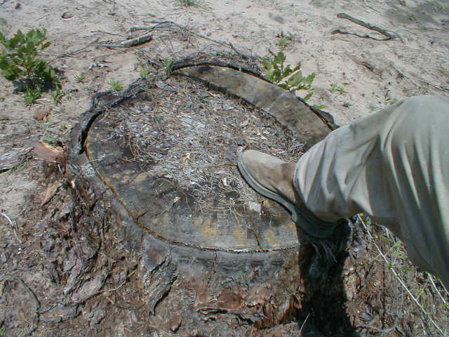

My neighbor dug out about 125 pine stumps that were left from the previous timber cut. As usual with big machines and work, I had to take some pictures. Here's a reference shot to my size 12.

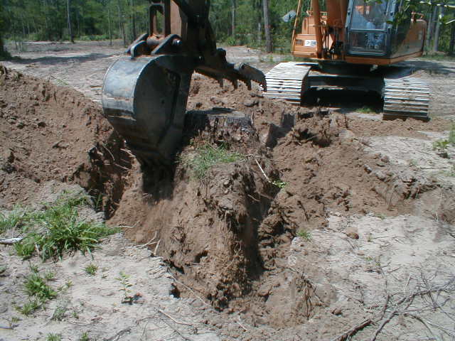

So he would simply drive the air conditioned (very important) track hoe to the target and dig. After digging down about 3-4 feet on 2 sides he would move 90 degrees and usually pop it right out.

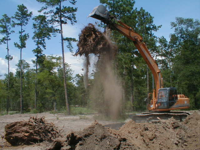

He would lift each one and drop it a couple of times to get the dirt loose. Standing 30-40 feet away you could definitely feel the thud on the ground.

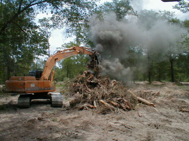

I would push all the stumps to a burn area where he stacked them to burn. What's the black smoke from? One old tire standing up at the bottom filled with motor oil and sprinkled with a couple of ounces of gas to start. Then he made a pyramid around this. Some piles had about 40 stumps and were completely burned in about a week with a couple of restacks.

Good pics TxTom. Track hoes are amazing machines but very slow moving. I would have been a little nervous sitting right next to the burn pile.

125 stumps as big as the one with your foot on it definitely make it worth hiring that job out.
