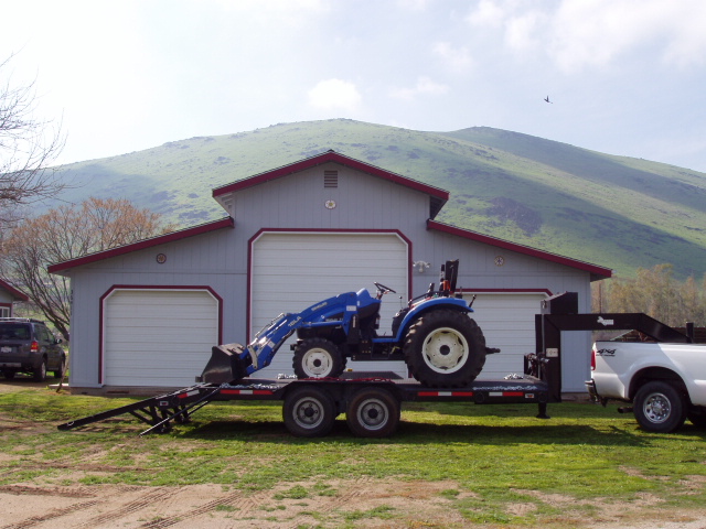

Hello Mike,
I am not a metal fabricator so I built my 32'x40' shop out of wood. Had the slab poured and then in my spare time built all the walls on the floor, then had a Saturday barbecue/wall standing party. Great fun and only took a few hours. Some of the "guests" who knew nothing about framing went away with the beginnings of a new skill.
If you have any non-bearing interior walls, consider framing at 24" o.c. 100 foot of walls will have 25 or so less studs. I always stick to 16"o.c. but it can be done.
Hey Nickel_Plate,
Nice shop. I've been thinking of a new shop building myself, something similar would work well for me. Did you use plans available on the net?

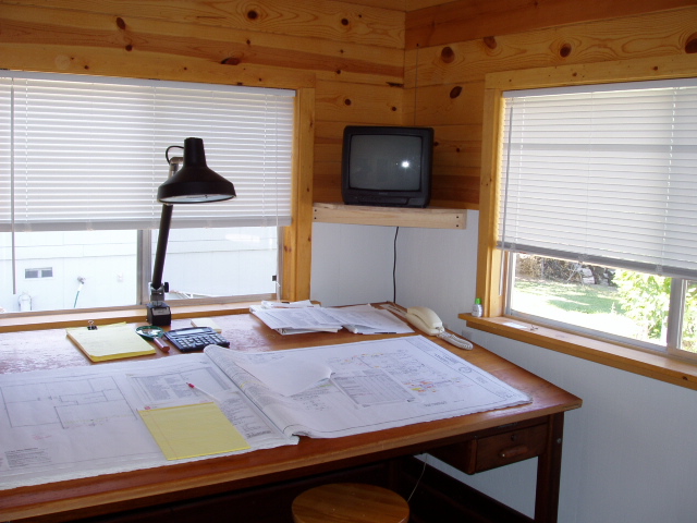

MrDig,
Being employed around the trades, I designed and drew up the plans (seventeen sheets) myself-no CAD or other drafting software-just pencil, paper and a scale. It passed through our building department without any re-draws.
The two side garage doors are 7'-6" and the center is 12'-0".
And yes, that is an old Bell "Princess" phone on my plan table. It has since been replaced when we updated the house phones.
