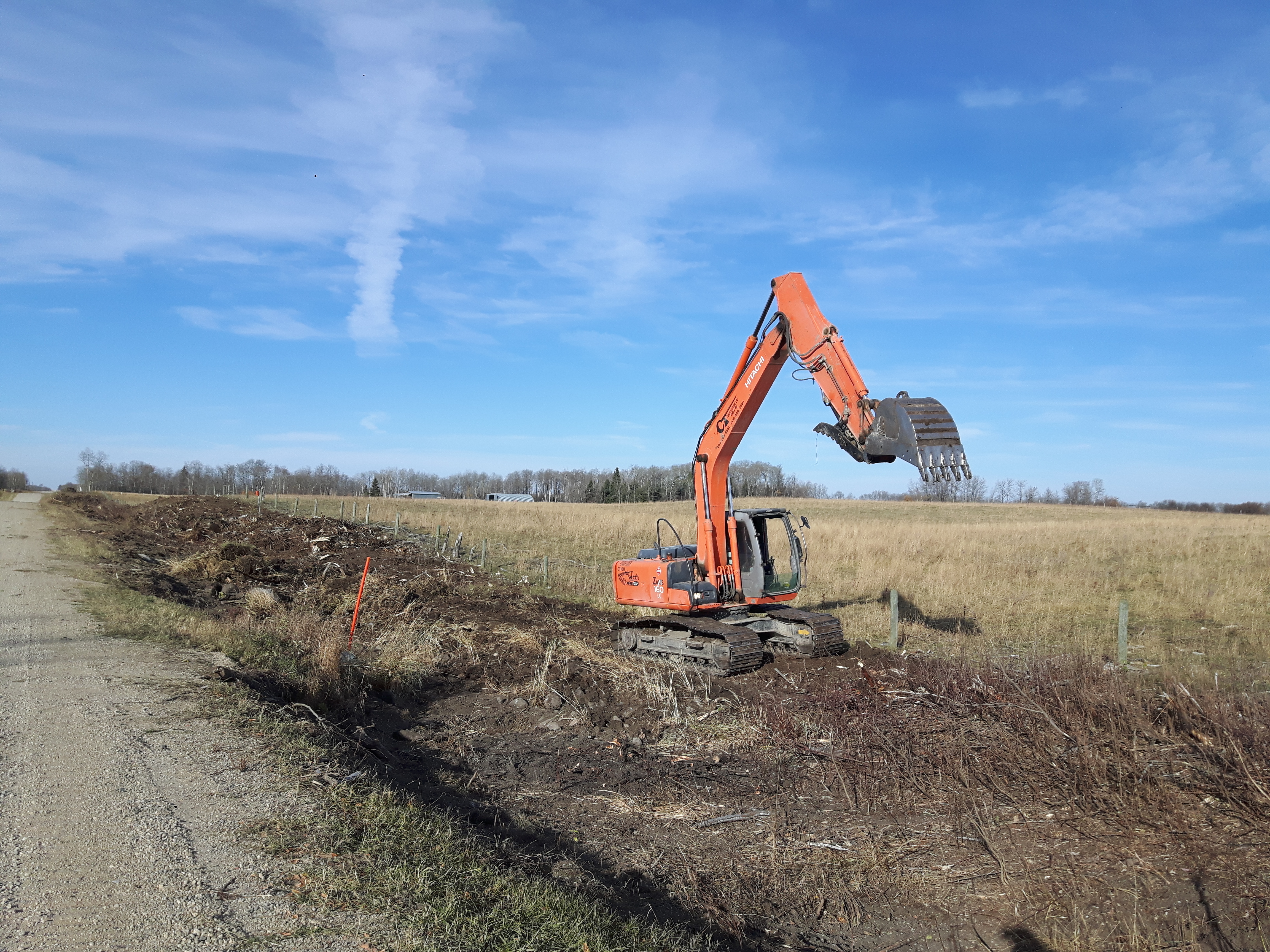

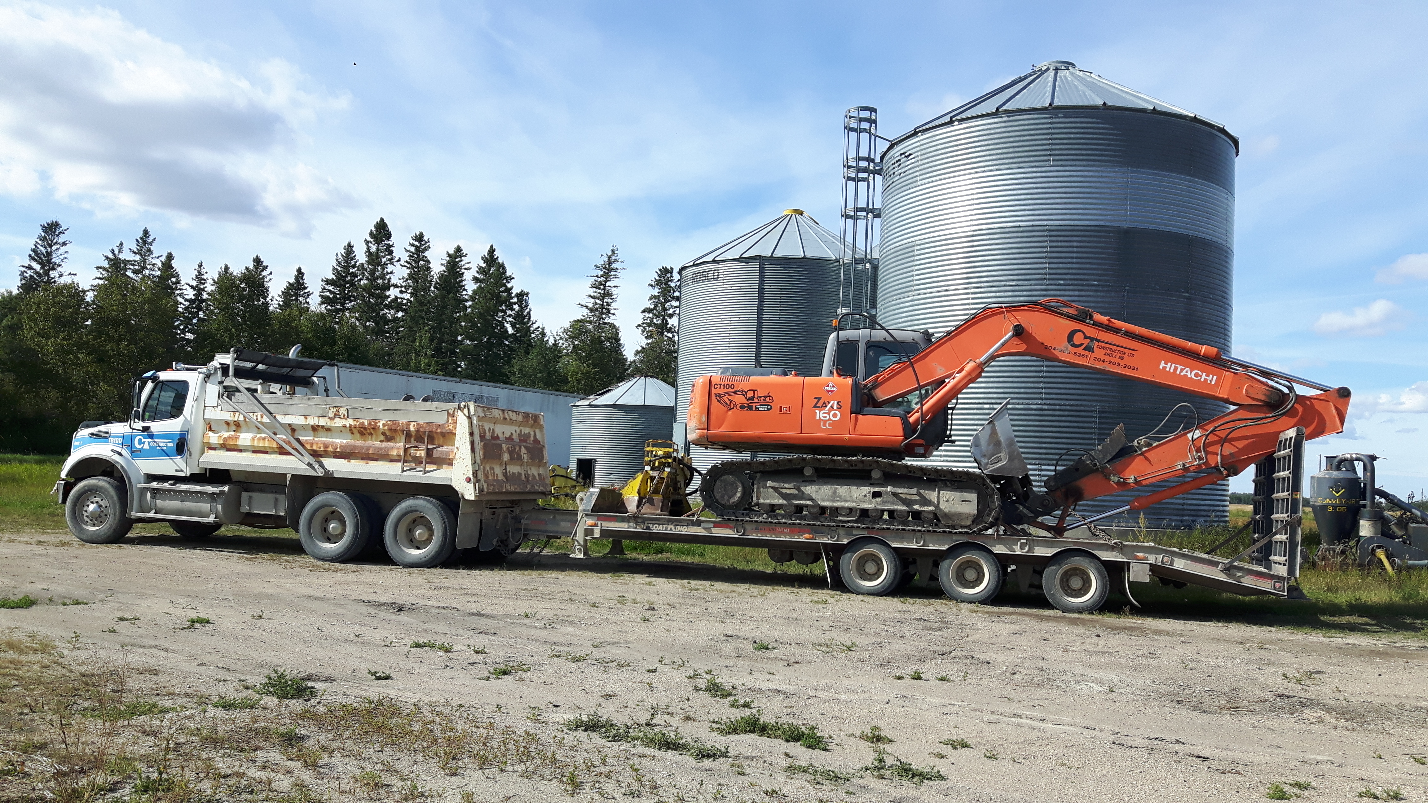

Yes this is my solution to that dilemma, I would love my own excavator and have long wanted my own but getting established enough to know I can make the payments through the lean months is the difficult part. And for this kind of work I need a machine that is heavy enough to dig in frozen ground and at the same time can be transported from job to job at minimal expense. Currently at my work I operate a 2006 Hitachi ZX160LC (16 tonne) and it does the majority of our jobs quite well but we still have to transport on a tri-axle trailer behind a tandem axle dump truck. If I went one size smaller to maybe a 120 or 130 size machine I could go without the extra axle and eliminate some costly tire replacement. Lol But I could still get on to most acreages and dig the deepest septic tanks 14-15 feet deep. But I'm also looking at maybe $1500/month to own, plus I would eventually have to buy a truck to transport it and all the costs associated with owning and operating a truck.
