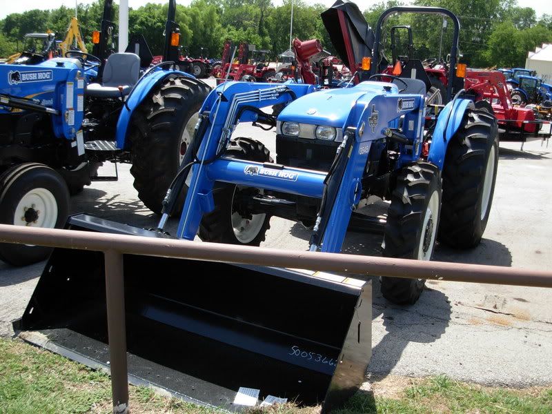

Went to the dealer and looked at tractors today. He has a NH TT60A 4WD with Bush Hog 3525 Loader.
Price is $25,995 and a down payment of $2,695 0% for 36 months.
What can you tell me about this tractor, good/bad...
I will need a rotary cutter and he gave me prices on 6' Ag-Meier for $1,179 and a 6' Land Pride for $1,375. Which one is better/which one should I stay away from.
He will throw in a canopy if I buy it by the end of the month....
   / Pricing on NH TT60A #2
I've never heard of Ag-Meier, and without knowing what model of 6' Landpride cutter you have a quote on, no one can give meaningful feedback. The TT is a no-frills tractor. THe two reverse gear choices will be a shortcoming if you do much loader work, but will be OK for occaisional loader duty. I think the swinging drawbar support on the TT is incredibly light. But it is all relative to price.
The Ag-Meier is a "Brave" 6FT
Land Pride is a RCR1872 6FT
Here is a picture of the tractor
