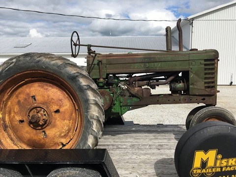

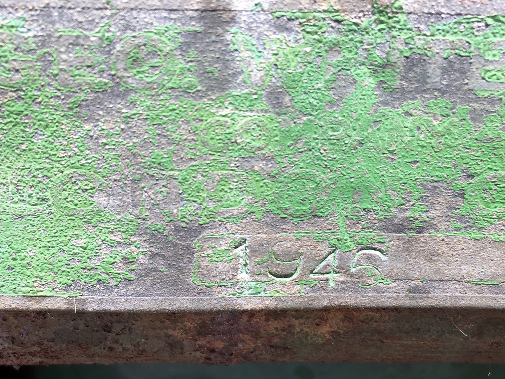

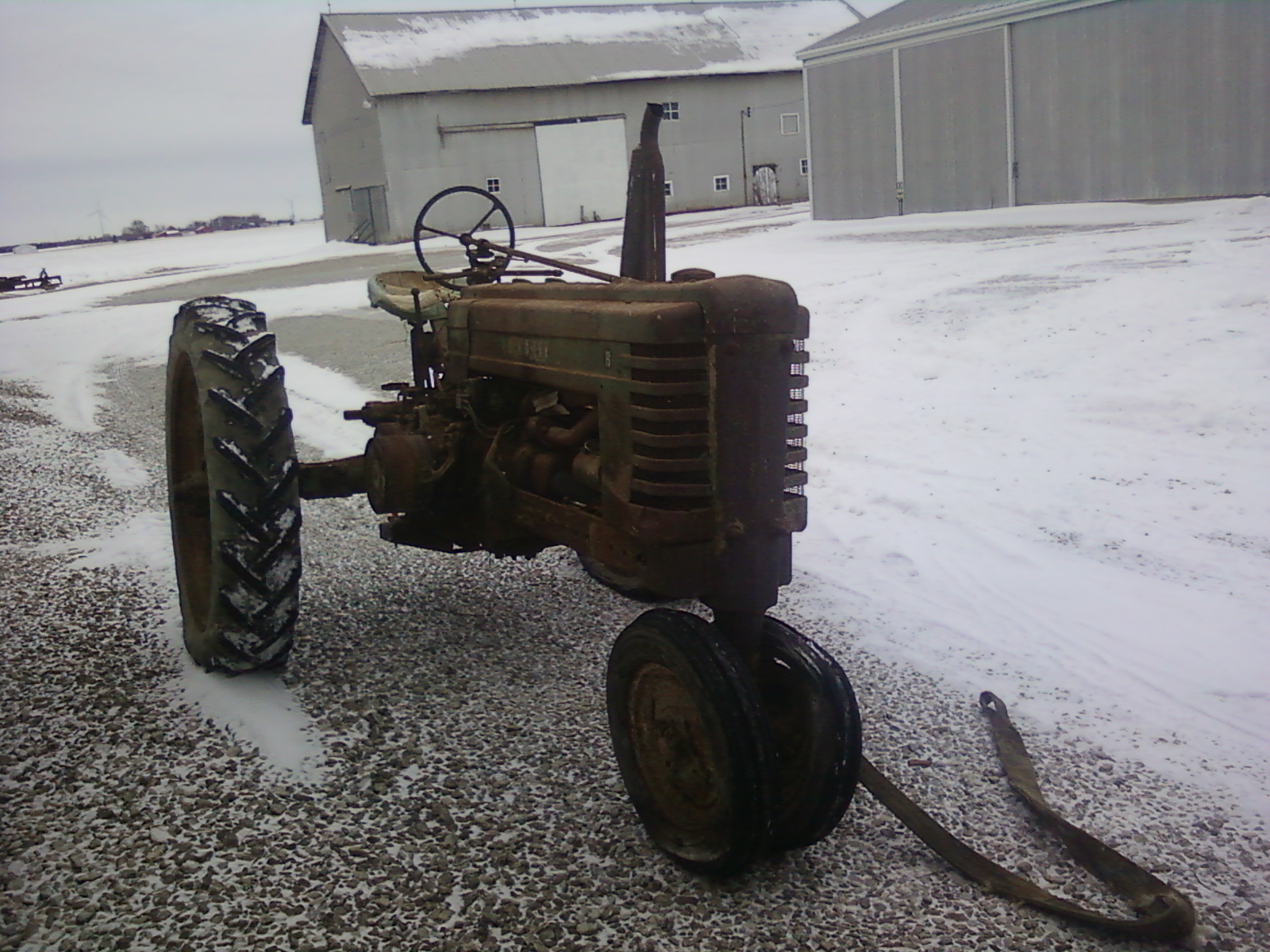

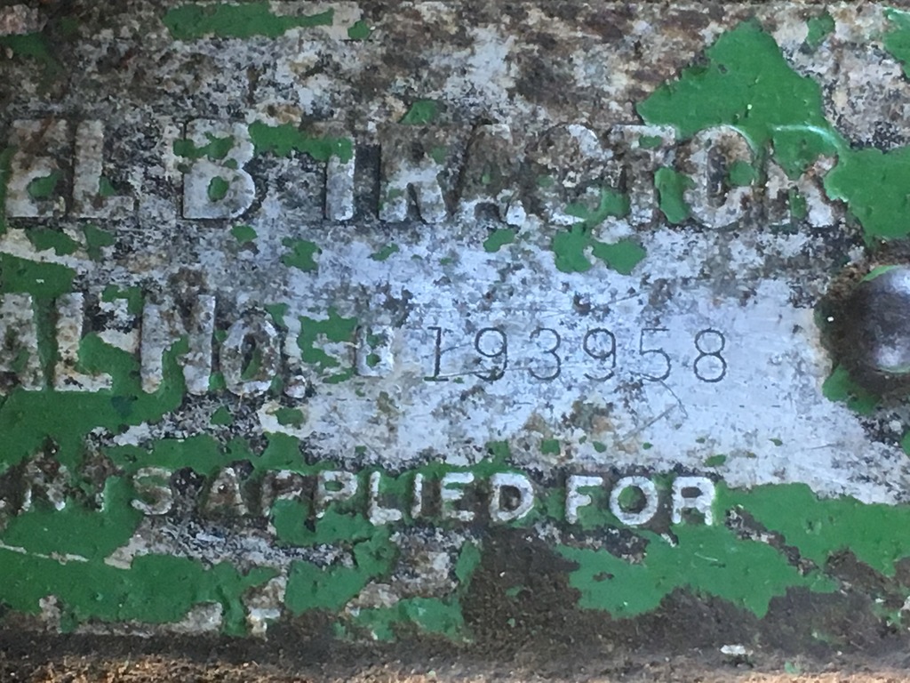

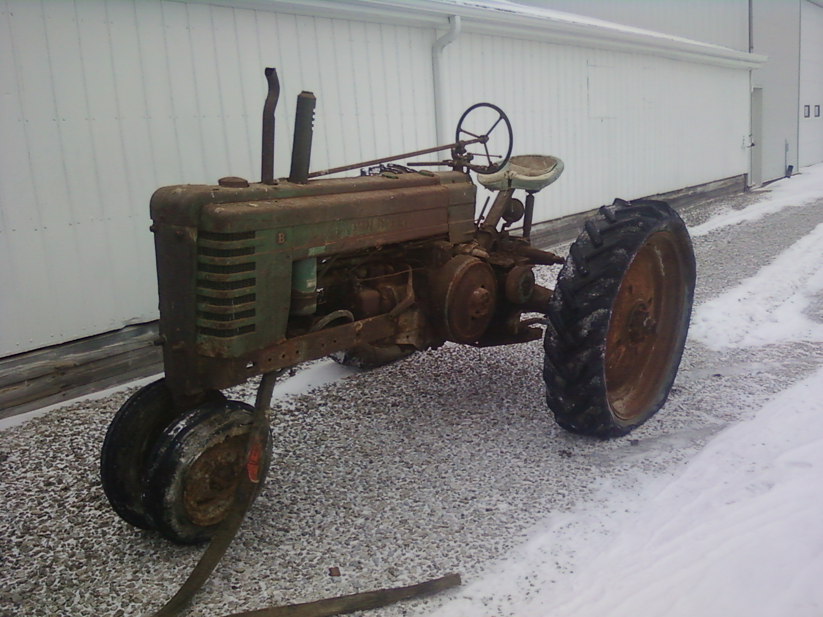

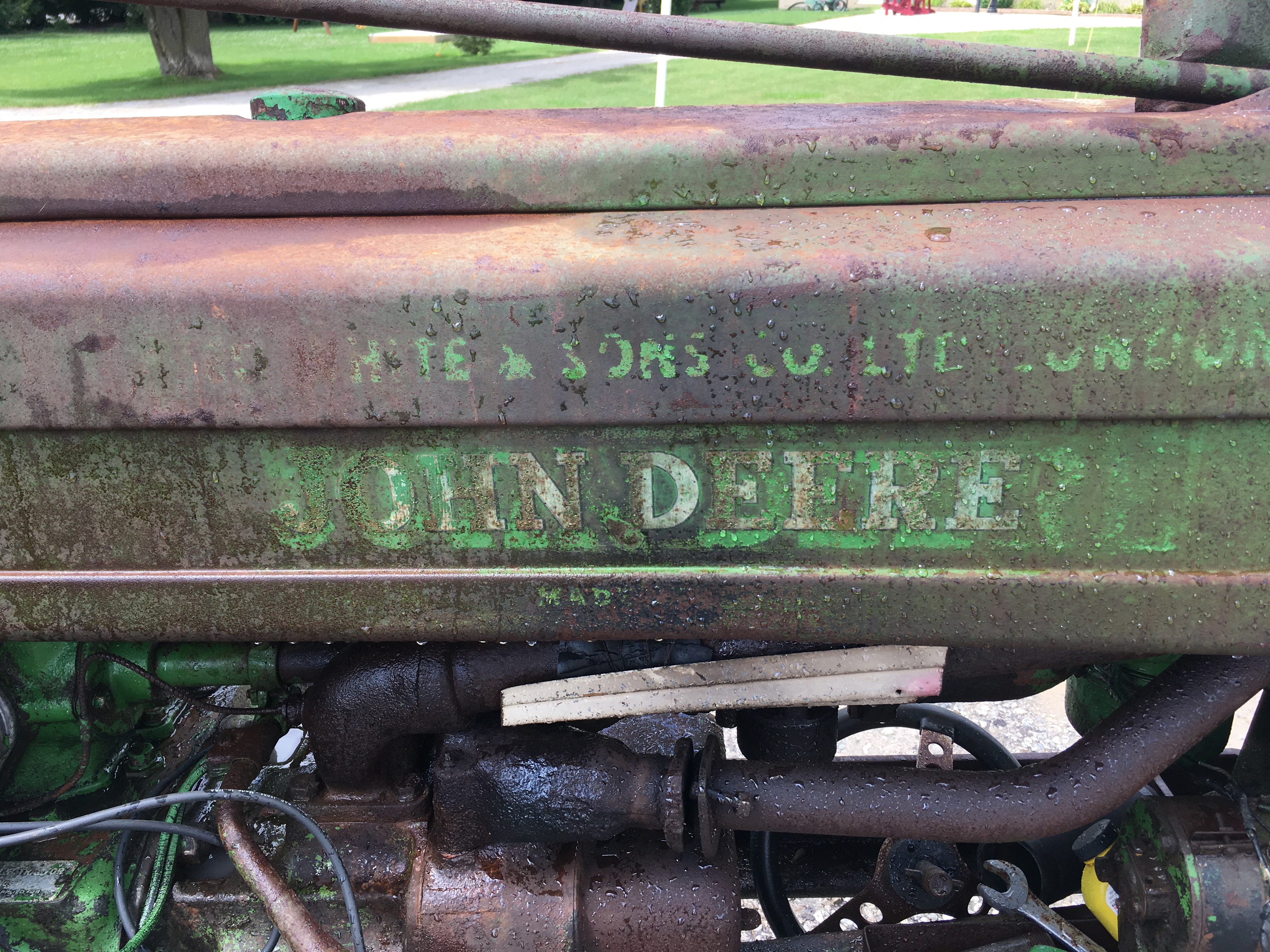

I have a 1947 Long Hood John Deere B that I am looking to sell and was wondering what it is worth. At least I think it is a 1947, there is conflicting data on if it is a 1947 or 1946. It needs some TLC as it turns over but has no spark. Needs tires and a good clean up but I think all the parts are there. George white tag is stamped 1946 but serial # makes it a 1947. Has a pan seat so it would be an early 1947. Here are a few pics.
   / Pricing on a 1947 Long Hood John Deere B
#2
Reposting pics.

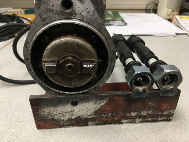

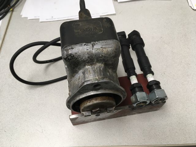

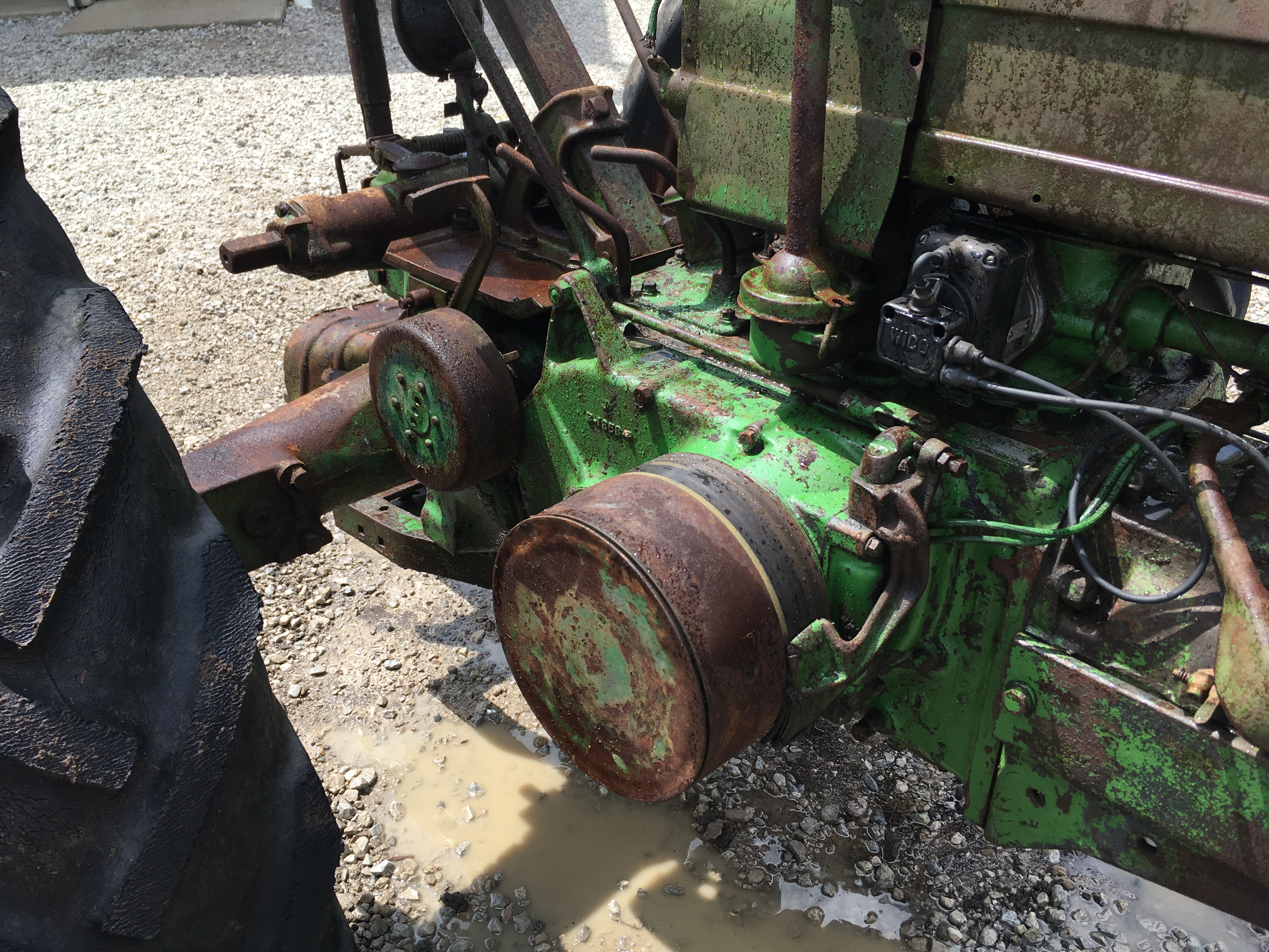

Mag had no spark so I set up a little test stand to help me find the problem. Cleaned every thing up, new plugs, points and condenser and got a real good spark now.

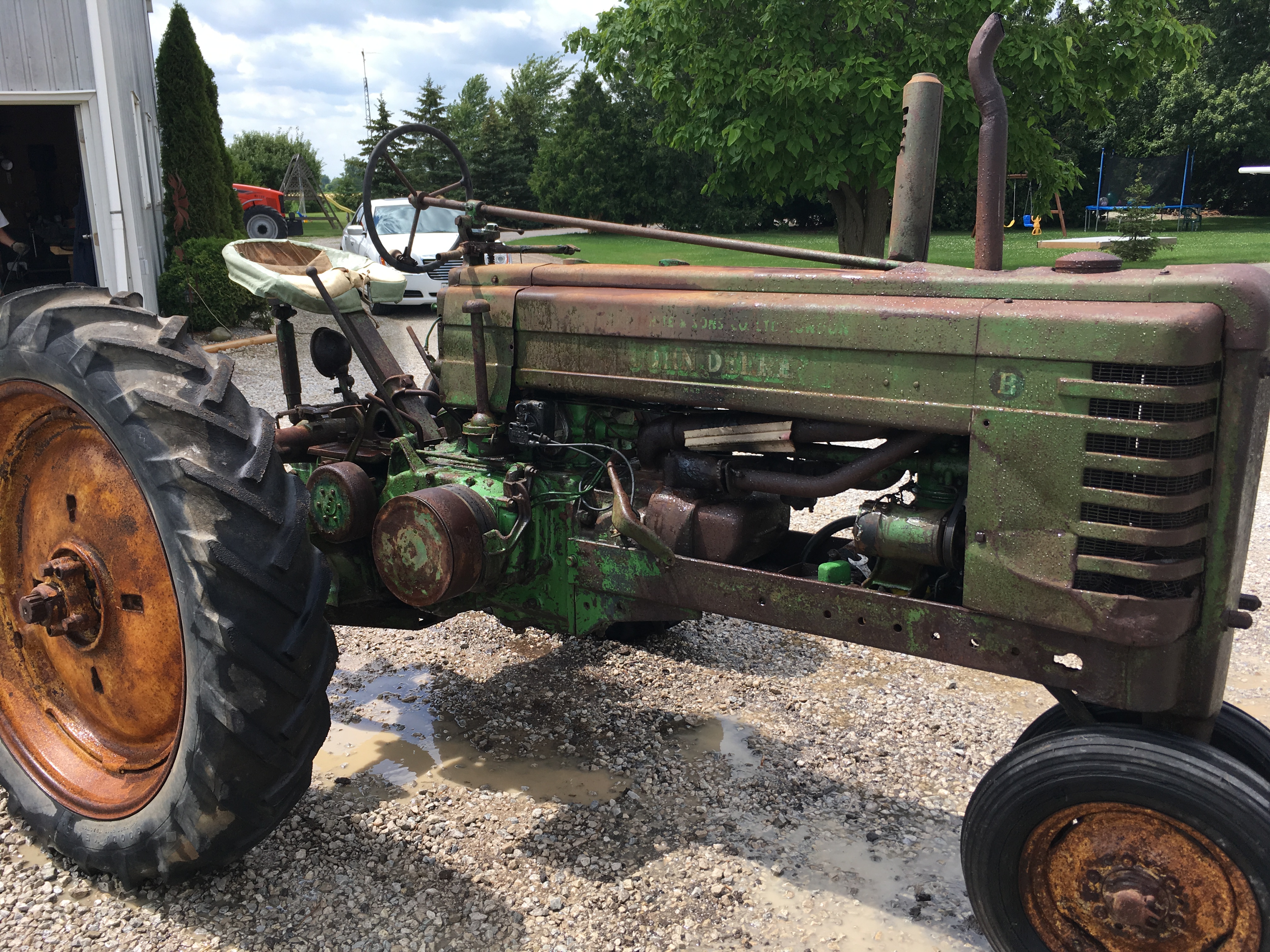

Got a chance to pressure wash dirt and grease off of tractor.
And after almost 30 years of sitting in storage, the old B is poppin again.

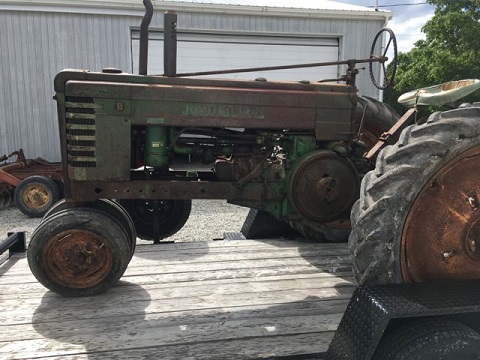

Sold the tractor last night.

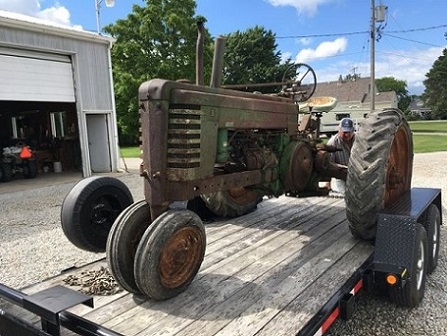

Here are some pics of the B being loaded onto the trailer, tractor just fits between the trailer fenders.
