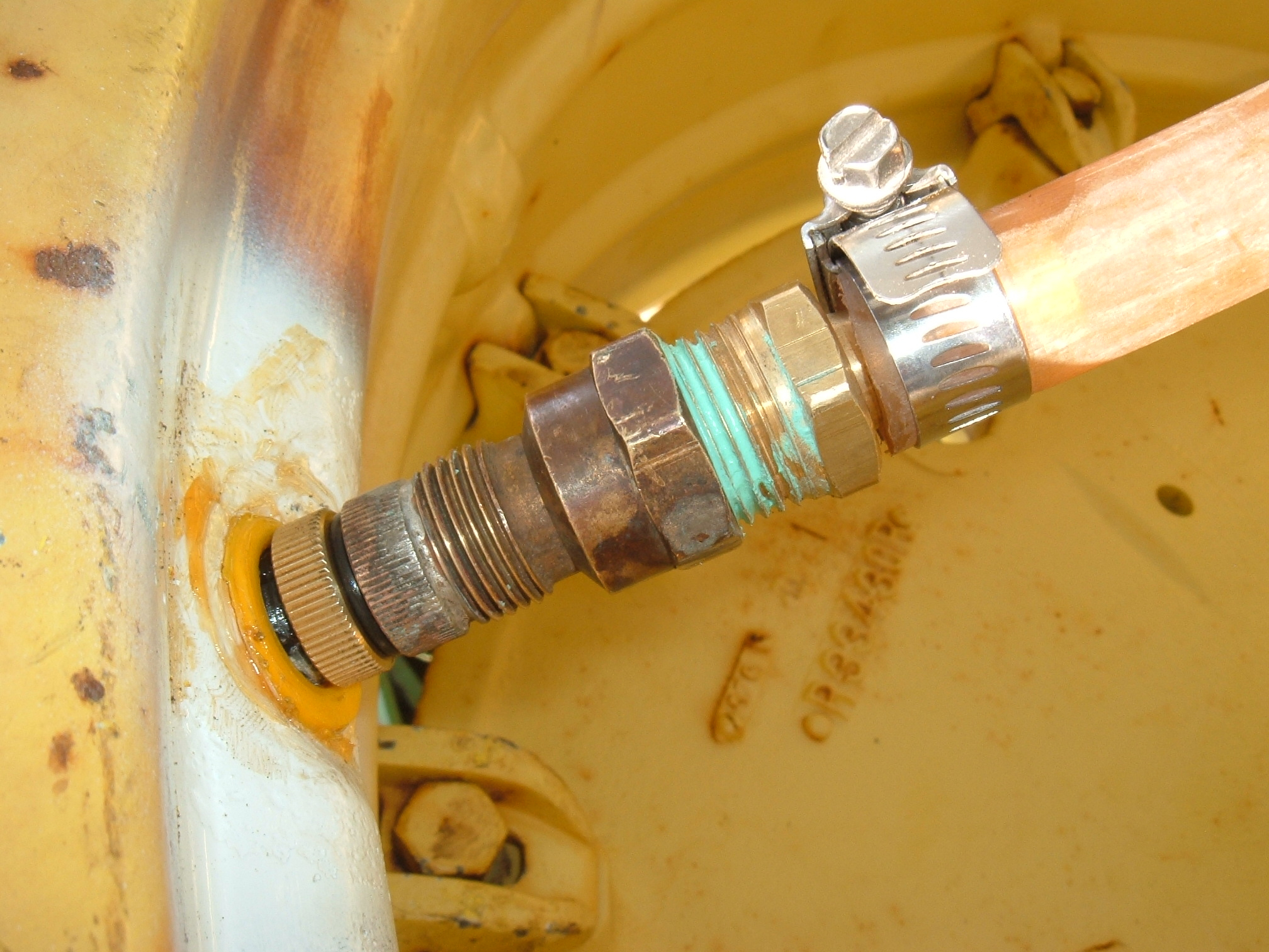

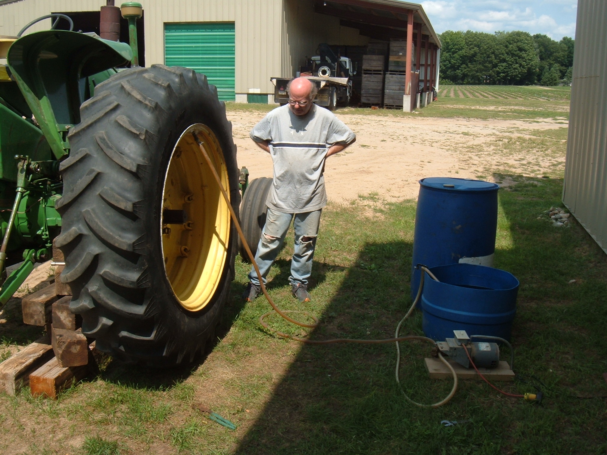

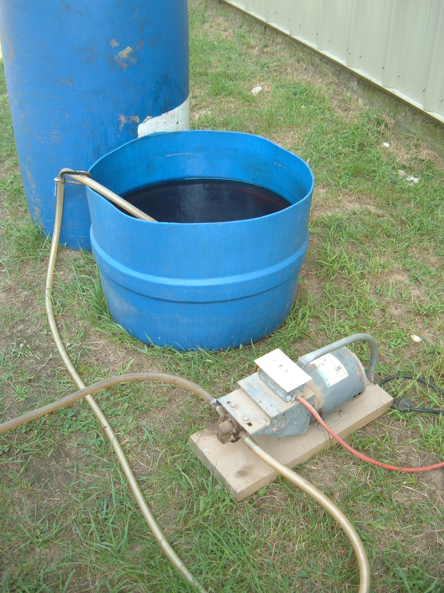

Just do it yourself.... use windshield washer fluid if you're concerned about freezing. An adapter valve can be purchased very cheep (About $10). Search on YouTube for video 'Filling tractor tires'... there are a few showing how easy it is. Took me just over 4 hours, but I was filling 80 gals.
