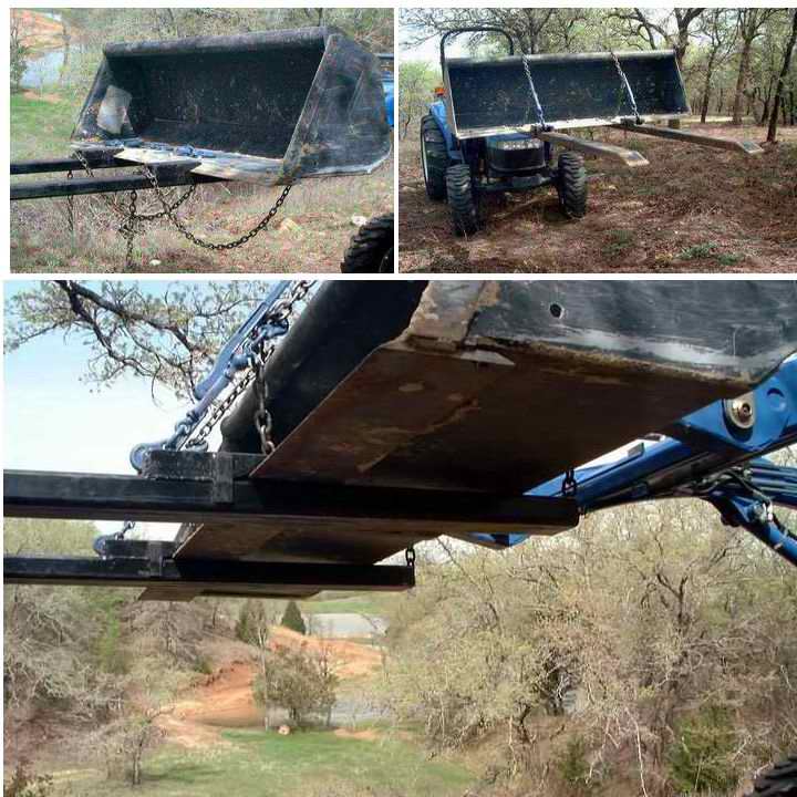

Gott, you "gott-a" help me with a little more info here. Do you mean loader lift or 3PH lift? I'm sure the 3PH can lift more on my tractor than the loader. I know that because I've had to turn around to lift a container my neighbor uses as a workshop, and I couldn't lift it with the loader. The heaviest thing I've lifted with the loader is a pallet with about 25 bags of Masonry mix on it. I was using my loader forks, so the load was fully 24" in front of my loader arm pins where the maximum lift is rated. Anyhow, I was able to curl the load enough that I just skimmed the ground while moving the load 100' to my barn. I think if I had dedicated forks instead of the loader chain-on type, I would have been able to lift that load much higher.

Chain-on forks: see attachment
