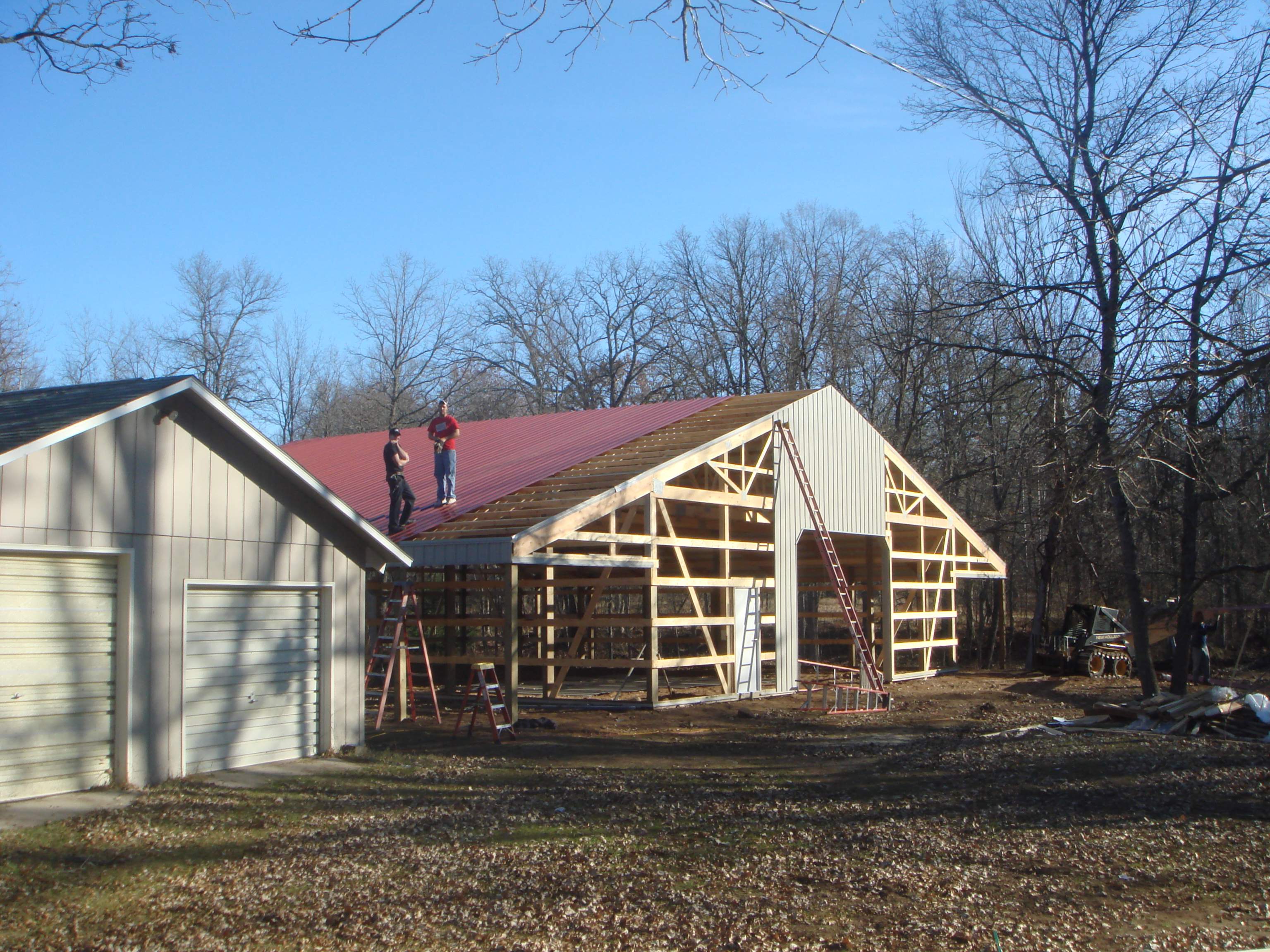

Attached is a progress picture of a new shed in the U.P.
I wanted to put the same color sheet steel over the existing adjacent garage to kind of tie them in together.
The 2 car garage is around 1,100 square feet in area.
The contractor wants to screw in new 2x4's laid flat on 24" o.c. over the existing shingles and then screw the sheet steel to the new 2x4's for around $3,400.
I initially thought this price seemed high.
What do you think?

I just had my garage done last month. It is 26X38. Two foot over hangs on the eaves and 1 foot over hangs on the gables. The initial thought was to go over the old shingles as well. But I was concerned a little bit about the added weight. It's bad enough when you have 2 feet of snow on the roof the way it is. I opted to tear everything off down to the deck. Then new builders felt. I also opted to use 1 by 4's instead of 2x4's for the nailer. I wanted to keep the height of the roof as close to original as I could so the rake trim looked about the same on the facia. I was also concerned about the wavy look you can get when spacing the nailers 2' on center, so I opted to go 16" on center. I figured this is the last time I am roofing the garage and I didn't want any reason for me to have to do it again. The next time it needs roofing, it will be someone else's problem. It is all screwed on. The entire cost to do the job was $4200. That includes everything mentioned above and a continuous ridge vent, one boot for the hanging furnace with clean up and disposal. So your price for what you have mentioned seems in the ball park to me.

Measure your roof. Call a Mfg or place that cuts custom lenghts of steel. I bet your looking at less than a grand in steel. So, $2,500 for installation is high. You can do this yourself, there is not a lot to it.

Is the $3,400 price for labor and materials? If it includes materials, then it's a good price. Labor for doing it that way should't be too much since they are doing it the cheap way and cutting a pretty big corner.
If it was my place, I would remove the shingles, check and repair the decking, install new flashing and lay down 30 pound felt paper. Then I would install the metal directly to the decking, on top of the felt paper. This is the high dollar way of installing a metal roof, but it is also the best way. While metal roofs are waterpoof and don't require felt paper under them, condensation is always a problem with them and having the metal tight on another surface is about the best way to eliminate that issue.
Most roofers will strip a roof in a day and haul away the old shingles. Ask your builder to brake down what it would cost to strip the old shingles, and then go from there. It might be cheaper to hire a crew to do this and then let him install the new roof.

I see now this building is in the U.P. I would definitely strip it down to the deck and start over. With the tremendous amount of snow you get up there, my main concern would be what kind of weight the trusses are designed to with stand. That was my concern on my garage in SE MN. And you have the potential to get more snow than we do.
As far as whether or not $3400 is a good price or not, if you can, and have time to do so, get a couple more bids from local contractors. Make sure they are all bidding using the the same requirements. That way you will be able to tell if $3400 is a fair price for your area. I know that would be a fair price where I am.
I would not recommend this without knowing what the existing roof deck consists of.
Typical 1/2" sheathing is not adequate to screw the new steel to.
Weight wouldn't be a big concern of mine.
The 2x4 and steel will weight ~1#/sq ft or less.
Plus adding 2x4's and steel adds a tremendous amount of strength to the roof.

I'm not aware of this, but it could either be a regional thing, or different with each metal supplier. In my area, East Texas, where we get a fair amount of rain and high winds, but don't get any snow, it is very common to screw metal into roof sheething.
It would be best to talk to the supplier of the metal and find out what they specifiy.
