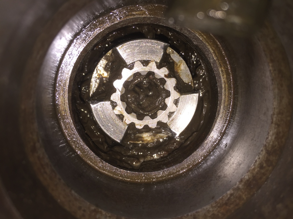

Great info FBB. I bought mine in early 1995 but I don't remember if I thought I was getting a 605 or an 850. I remember when it came in, the dealer said BCS was changing models and numbers, and that was the reason it came with an 850 owners manual but the tractor was a 605. The manual is titled "New Series 1994 Owners use and Care Manual". It describes the use and set up for the 830 and 850, and shows the straight shifter in the diagram (like mine has too). I still have the BCS sales catalogue/brochure from when I bought it, and it lists the "Professional 605/850". It came with a "free" tapered 3 dog quick coupling like they do yet today. It has the quick coupling on the tractor, paired with the tapered 3 dog male ends on the tiller and snow blower. I assumed the tractor was tapered 3 dog too, but I just checked like you said above and it is the flat 3 dog. I've been using it that way, pairing the flat 3 dog from the tractor to the tapered male ends on the tiller and snow blower for over 20 years, and never had any problems. The connections are still very tight with no wear.
I always thought of it as an 850 because of the manual and brochure I guess. That might explain how the other guy you referenced above thought he bought an 850 too. I used to think mine was sort of a hybrid as it was built in the transition year. But now I think it might be a mutt instead. :)
   / Price for BCS 605 with Tiller #9
I don't think flat 3 dogs fit with tapered 3 dog. The flat 3 dogs physically move out to engage the attachment. The tapered 3 dogs work internally to engage the attachment - the dogs don't move out. You must have an adapter in the somewhere. Could you post a picture?
I took a few pictures. PTO disengaged, engaged (these are looking in through female coupler), and the male coupler on the snow blower. I can see some wear on the leading edges of the tractor's dogs from the tapered dogs on the couplers.
