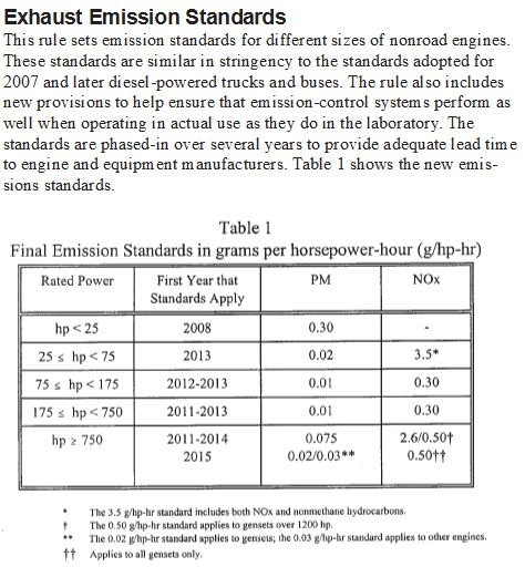

Actually it is not an EPA issue. The diesel engine on these tractors are 24HP. Anything below the 25HP threshold does not require a particle filter yet. The issue here is weight from what the JD dealers are stating; my dealer states this also. The tractors need to be under 610kg or 1345lbs or the tractor will need a ROPS. JD does not want a ROPS on these tractors, so they need to figure out how get the diesel engine, AWS and AWD into the new series without compromising the strength of the frame or other components on the tractor without going over the weight limit. I am wondering if there is a new standard set by the Society of Automotive Engineers (SAE) and the American Society of Agricultural Engineers (ASAE) for adding ROPS to smaller tractors. My dealer mentioned that it is a government regulation but I have not found this regulation yet for ROPS weight.
Below is a quick guide to NOx and when the engines have to be in compliance with the final Tier IV regulations. Any diesel engine that is below 25HP needed to be in NOx compliance as of 2008. All the larger diesel engines need to be in NOx compliance this year or next year. Here is the URL link if you would like to read the whole EPA "Clean Air Nonroad Diesel Rule" document - http://www.epa.gov/otaq/documents/nonroad-diesel/420f04032.pdf.
