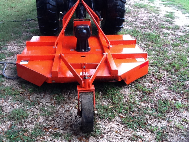

Is this going to be a rough use mower or a finishing mower application? I had a 60" Land Pride finishing mower behind my L2900 for 12 years and it performed flawlessly. I did add spun foam to the front tires of the mower. I also had a Fred Cain 60" rotary mower for heavier mowing. It also performed well.

I 2nd the LandPride 60". A finish cut FDR2560 was left behind when we bought our property. I mow about 4 acres of rolling bumpy terrain per week during mow season. I put new blades and a belt on and though it looks to be 10 years old it still cuts evenly.
