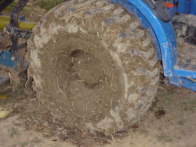

I bought a Campbell-Hausfield from TSC a couple of years ago. Has 6.5 HP Briggs & Stratton engine on it. I think it is 2.6 GPM and 2600 PSI. It has done everything I've ever wanted it to do. Isn't terribly loud. Not any worse than a push lawn mower. I think we paid somewhere between $299 & $329. Like you we needed one, but didn't have big bucks to spend, and mine cleaned the mess you see in the attached picture. /forums/images/graemlins/laugh.gif
