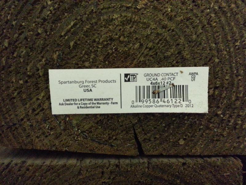

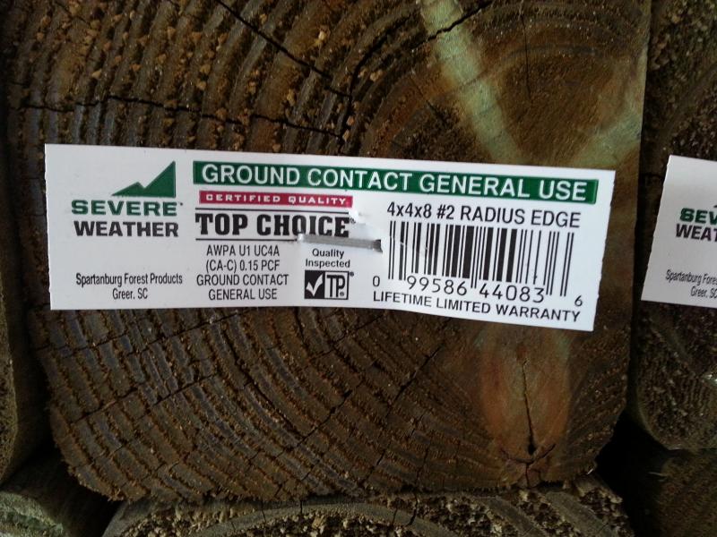

Running some errands today I stopped into the local big box store and was curious-the following are pictures of the tags on a 4x4, 4x6, and 6x6 I found there:
Notice that all are rated "UC4A", the lowest rating for ground contact. In the AWPA document I posted above, UC4A is recommended for fence posts, deck posts, and utility poles in regions of low decay potential. The next highest rating, UC4B, lists "permanent wood foundations" and "building poles" in "regions of high potential for decay" as applications. Food for thought...

The fact that 2x lumber is not rated for ground contact is besides the point. The point of this thread is that all ground contact rated PT lumber is not created equal. I don't think a lot of people realize that-I definitely didn't until I bothered to research it. I'll be curious to see if I can source UC4C or UC4B rated lumber through a local supplier and if so, what the cost difference is from UC4A. UC4A is NOT recommended for permanent wood foundations by the AWPA, so I wouldn't use it for pole barn posts. There are plenty of folks who have had barns built with pressure treated posts that still rotted off. I wonder if it was because they used 4As instead of 4Cs?
