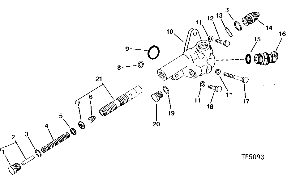

What is blowing out? Have you checked standby pressure? I think standby should be around 2250 psi

The o-ring in your schematic with the number 9 is the one blowing out every time. It's made out of nylon or plastic I think. I really don't know where to check the stand by pressure on this machine. I have a gauge and not sure if it will register that high or not. I know that is not normal for it to keep blowing it out so regular as it seems to now.

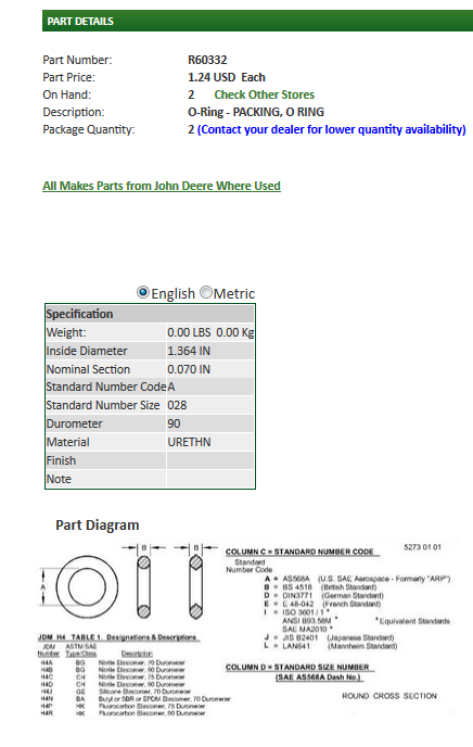

   / Pressure control valve problem #4
Are you replacing o-ring with the correct part number? Here are the o-rings spec's. You can check stand-by pressure at the frt pump. I'll guess stand-by should be around 2350-2400 psi. Have you checked to be sure pressure control valve isn't stuck in the housing or blocking flow?

You should be able to check stand-by pressure by removing plug(parts key 7) and attaching hyd gauge. I think BB you're referring to blocks(plugs) a passageway
