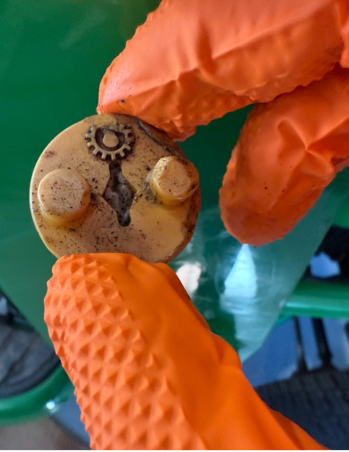

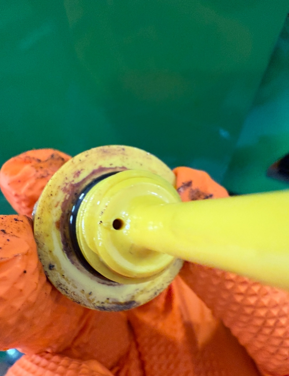

Are There any quick fixes to vent this front axle

Looks like for some JD front axles they redesigned the dipstick to be vented?
LVU33873 john Deere part number for other models.​
   / Pressure build up on front axle of a 4410 John Deere compact tractor #3
The front axle on my M6040 is vented. Dead center, top of the axle housing. A VERY difficult place to locate. It's a screw in plug with a nipple. Rubber hose attached to the nipple. Hose goes up - connects to a steel pipe - terminates in a 180 bend at the very top of the radiator.
Makes no mention of this in my Owners Manual. Had to put a small filter on the end of the steel pipe. Mud daubers like to fill the end with they eggs/goo.
