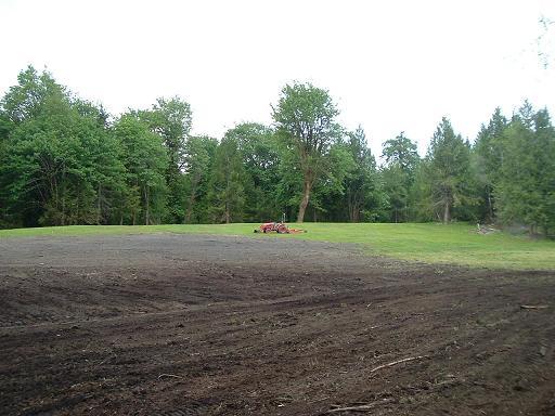

I'm a box blade guy myself but this question is frequently asked and you will find that the answers are often biased towards whichever piece is owned. Rake or box.
This was done with a BB.
