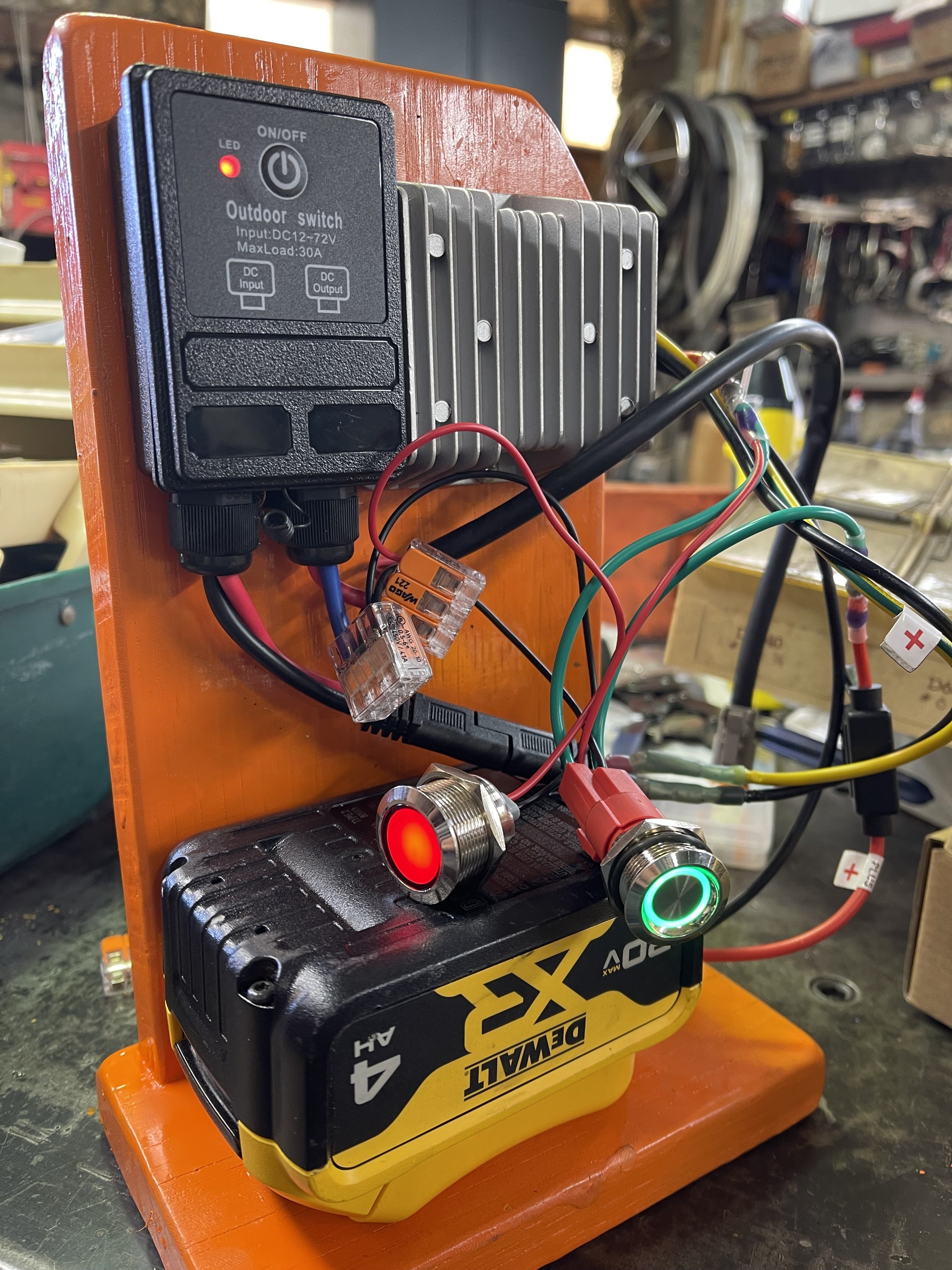

Assembly via manufacturer video straight forward. One hydraulic line going from diverting valve to blade cylinder was assembled backwards, nps to orfs, required some disassembly to correct. Unique feature is a remote control diverter valve that lets you switch 3rd function from cutting to head rotation. The supplied AMG battery was dead and not chargeable. Used another battery source and found the wireless receiver box also dead. Suspect water damage from outside storage. Called manufacturer for tech support. Technician called back after a couple of hours. My receiver was at least 3 years old and since upgraded to a new style. $550 for the old style, $450 for the new. Battery cheaper locally. Discussed some about using a $20, 30amp, waterproof wireless remote from Amazon and DeWalt batteries. They are available to help.
Ordered two types of wireless remotes with transmitters, Dewalt battery mount and 12v transformer, lighted 20amp switch. This experiment ongoing.

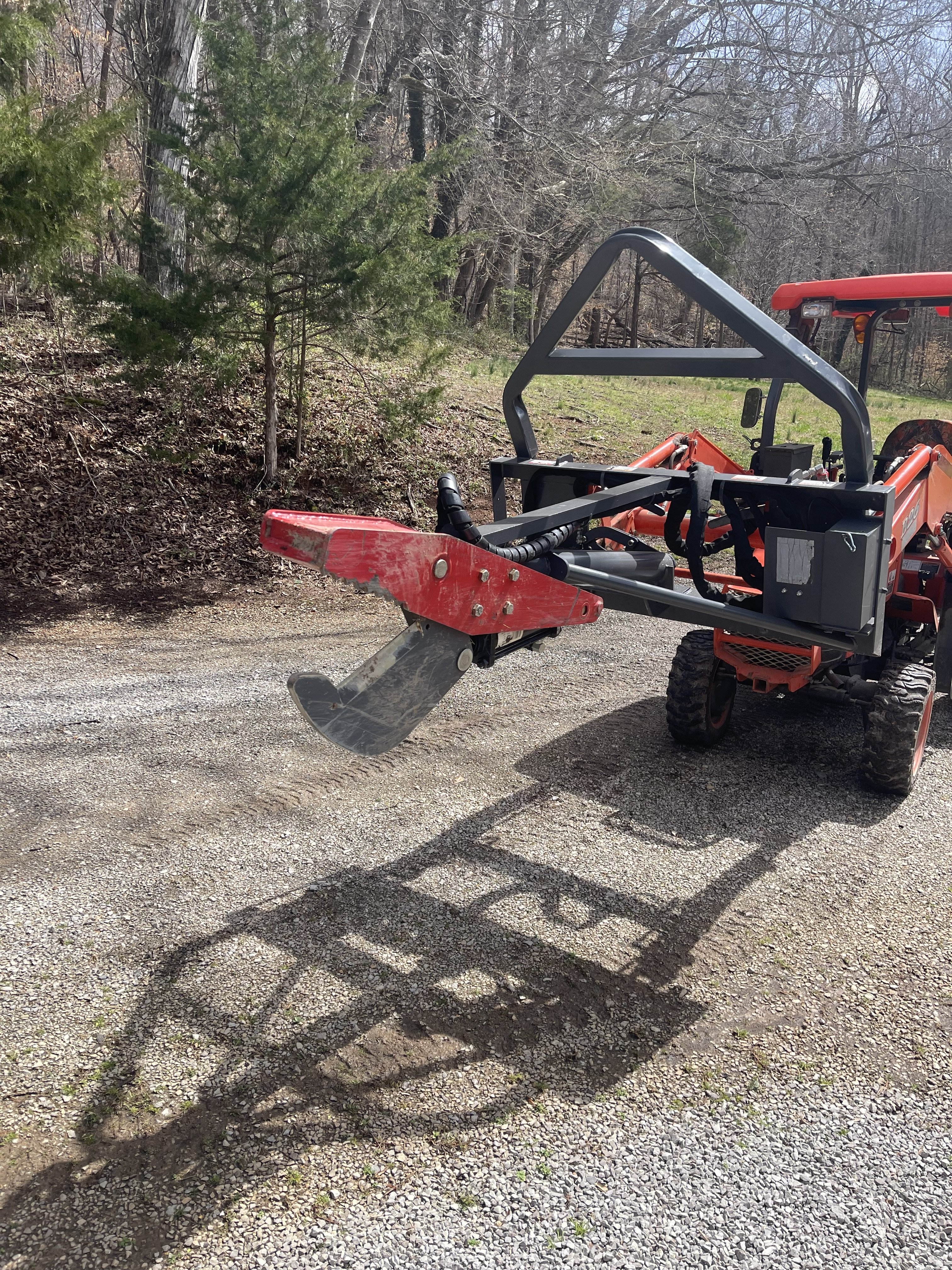

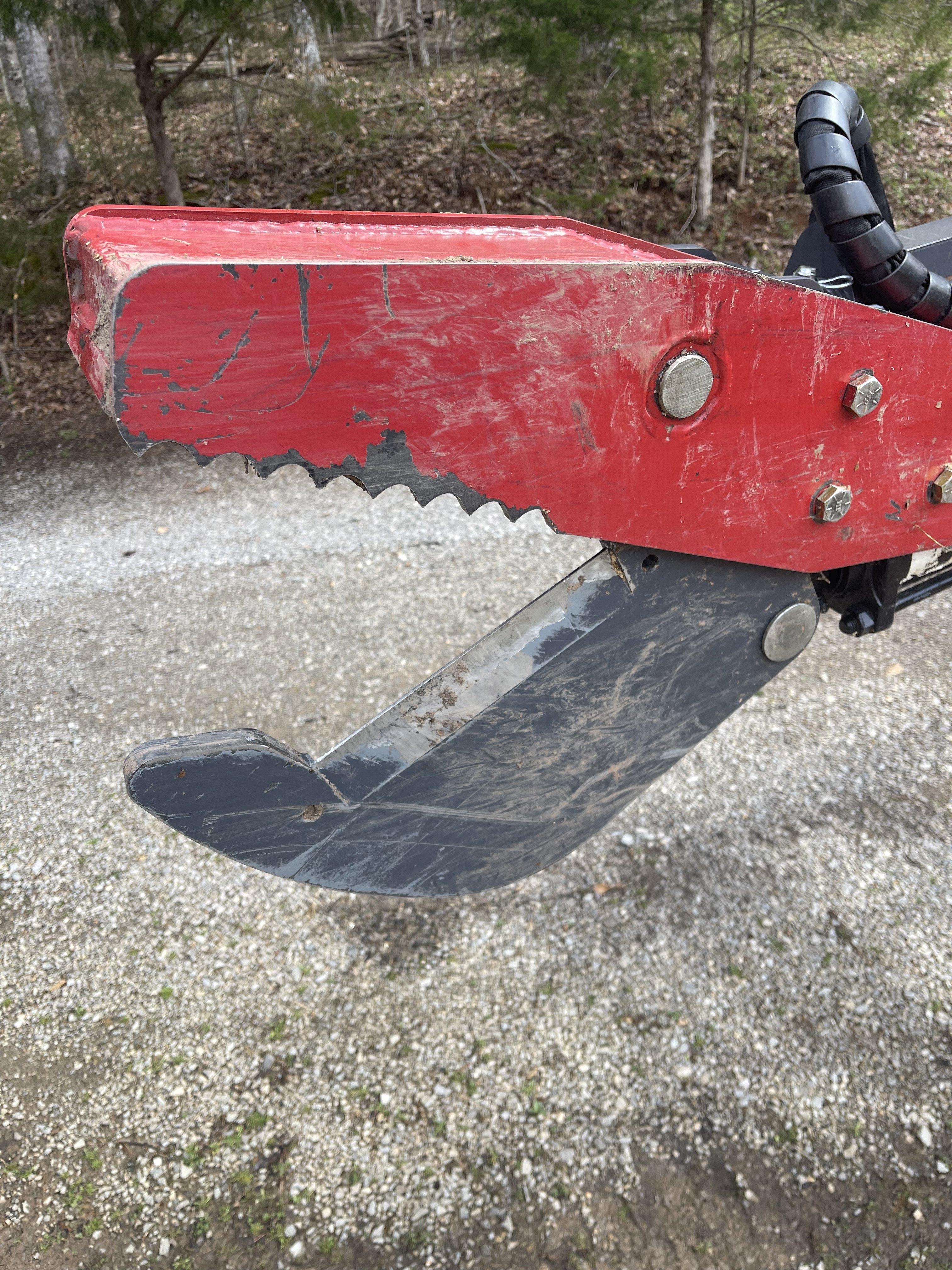

Even though I can’t rotate the head yet, used in horizontal position to cut 40-50 trees off flush with the ground. The extended boom, tractor HST made for easy maneuvering and positioning. Cut everything fitting into jaws which is about 7”. Easy cutting near and under fencing. I have got some rocky ground especially near bases of trees. Blade unfazed. Did grip a few cut trees to pull out for easy grappling later. Manufacturer discourages such use. See attached video of a users 3 year review to evaluate the use and abuse.

Hopefully cutting flush with ground will allow keeping maintained by rough cutter. Trees grow incredibly fast at the forest boundary. Selectively taking out small trees and horizontal limbs helps maintain that safe forest boundary.
Bushhog rated for 2-3”, Brown tree cutter 6-8”. This cutter can do same with much less required horsepower and collateral damage. Considerable more reach and maneuverability. Not bad for a small CUT.
No one tool can do it all. Time and physical ability considerations. Value my time at $200/hr so tools like this can certainly be a work force multiplier.
This is Precision Manufacturing smallest tree clipper. They make 12” cutting model for large tractors or CTL. Hydraulically controlled cut, rotation, and extension.

Replaced the factory electronics with Amazon waterproof wireless receiver, transmitters and DeWalt 20v battery adapter. $45. Works fantastic. 180 degrees rotation. Went on a cutting spree. Initially thought the miniclip might be too small. Ability to use on a smaller tractor and smaller head are big bonuses. Easy to cut <7” trees flush with the ground, cut long stems up for hauling away and pruning limbs from hitting tractor. Realizing the thoughtfulness of design and engineering. Only complaint is my face is sore from grinning.

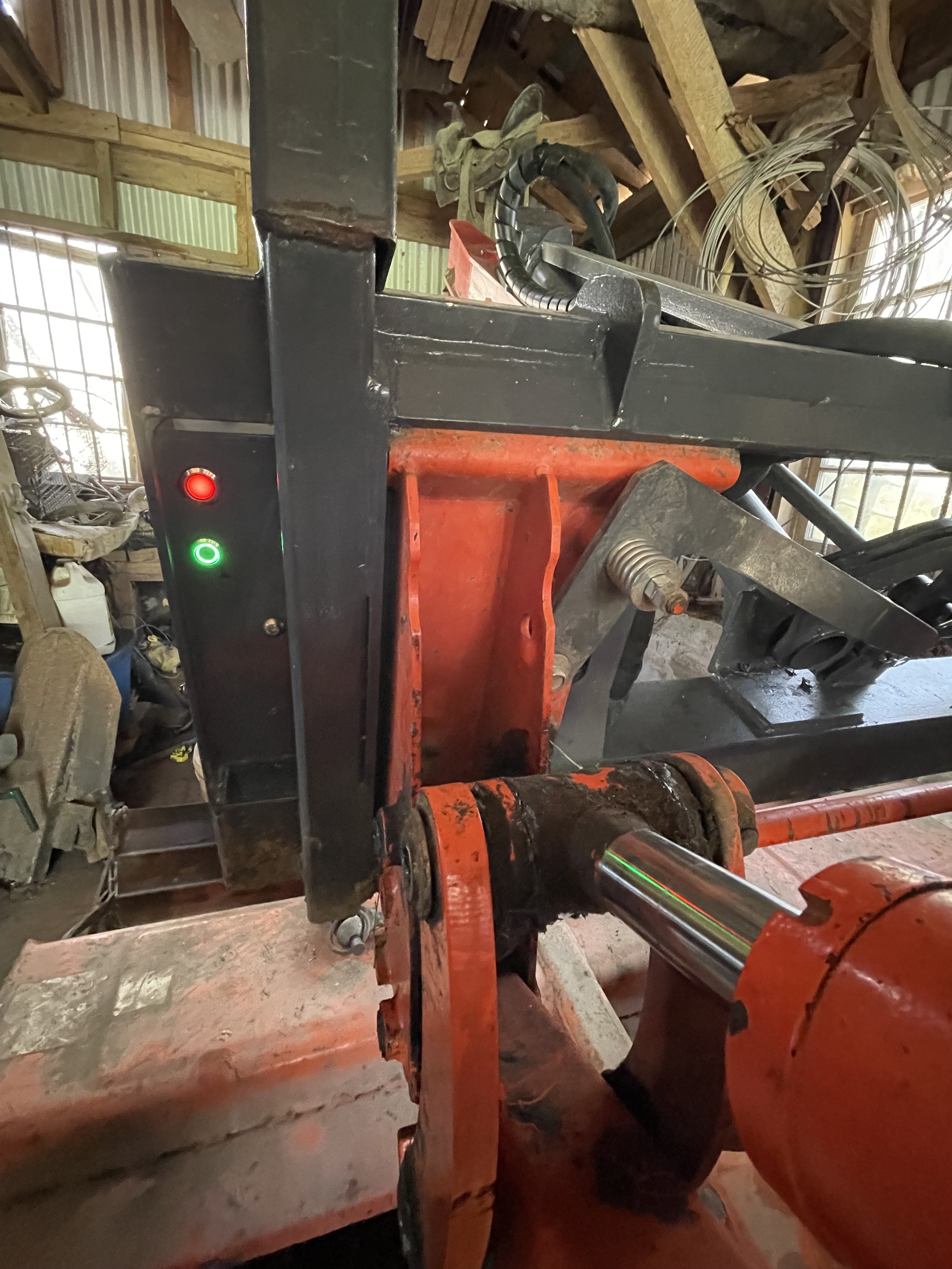

Green is a switch to indicate system is on. Remote transmitter is attached to steering wheel spoke. Red light is when solenoid valve is switched to rotate. Battery should last weeks of cutting. Electronics are housed in a heavy steel OEM box. Lights face the operator. The receiver has manual switch also. Can pair with over thirty transmitters.
Bought the current and replacement spare components for the electronics package all for <$100. Interesting ability to add an additional hydraulic circuit.
