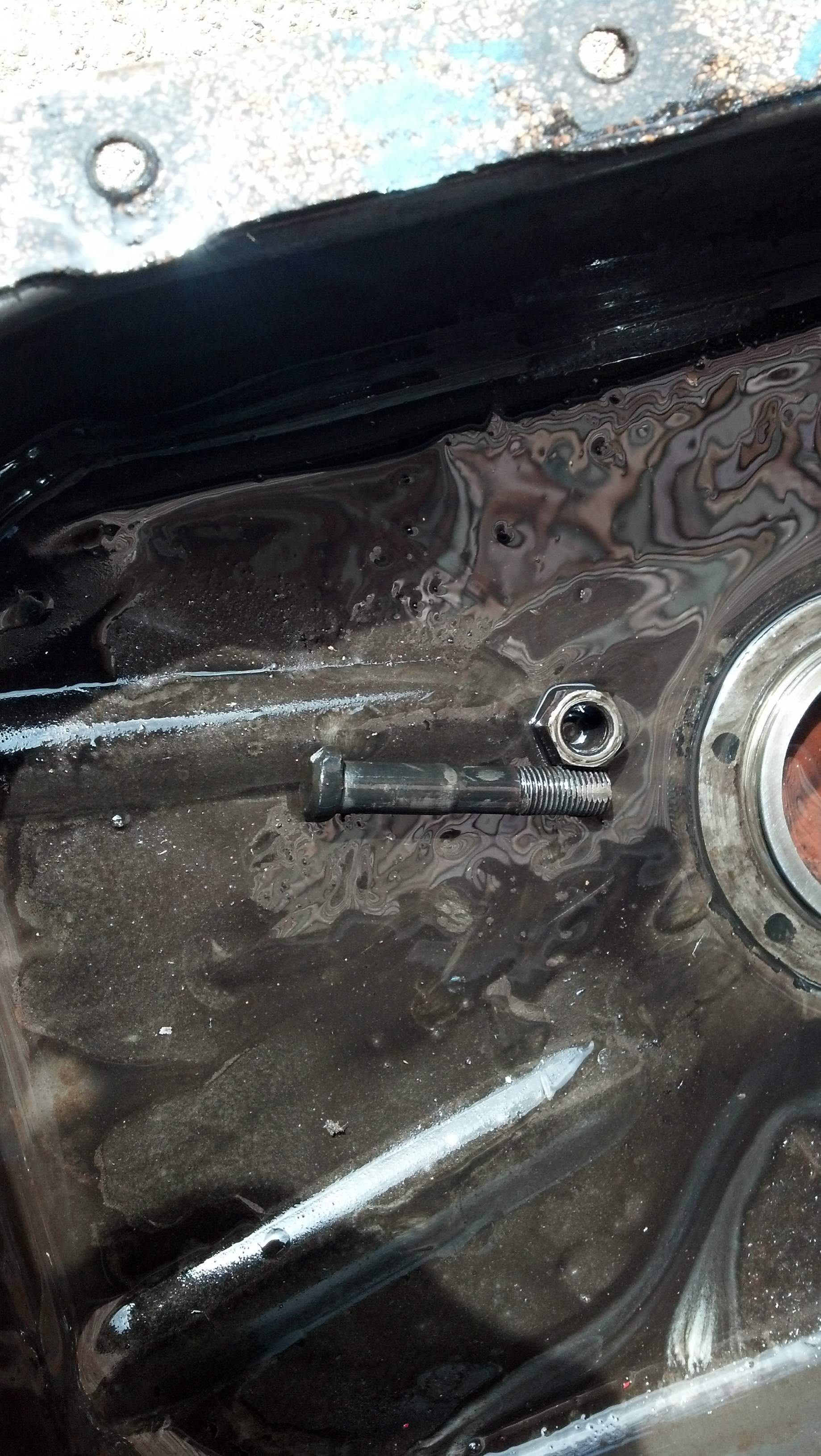

IMG_20140429_145820_073[1].jpgOk today a had a chance to drop oil pan and there was a connecting rod bearing bolt laying in the bottom of the oil pan, So i am going to pull the other nut and remove bearing and inspect for damage and maybe i will have a little luck and just need to replace bolts.I do plan on replacing both bolts because the other may have been weakened. When this started i shut her down right away and have only run her to move her back maybe 20 feet so i am praying to the tractor gods that i might have avoided any damage.
   / Powermaster 861 engine rebuild #7
If it was my tractor, the rod journal would be beat square... :)
sotty. not being cynical... just telling you to expect the worst .. cuz it only gets better from there.

yup.. that's how replacing a 13$ front main on my farmall F turned into well over a couple hundred bucks by the time i factored in breaking the crank pulley, and finding more stuff needing attention, the more i pulled the front of the engine and bolster down. :)
