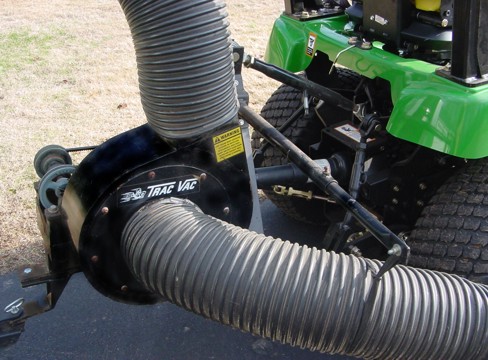

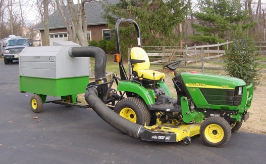

I'm running a model 854 3 pt. rear pto driven TRAC VAC on my 2210 and it works great. Taking it off and putting it on is fast and it holds 52 bushels of cutting or leaves.

That sure is a sweet setup you have!
I would love to come across a good deal on that.
