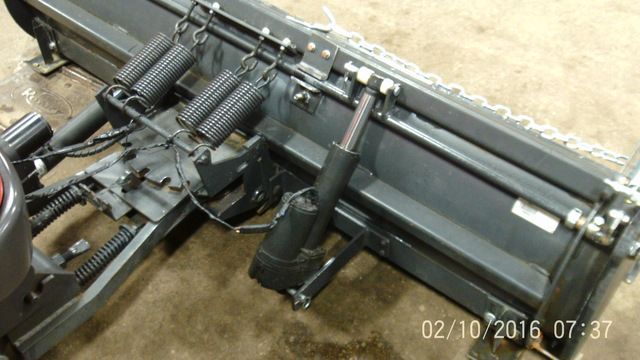

Nice. Was going to ask why you needed the chains, for support or to attach to a winch to let the wings adjust back. Then I finally got the video to play.
Interesting concept. What is twisting the rod to lift the wings? Hydraulics, electric motor or linear actuator?

A 4" actuator moves a lever arm welded to the pivot bar.I had to make the arm short and made two L-shaped plates to stabilize the rod,to get enough rotational movement. The wings are 5/8 UHMW and the pivot rod is 3/4" steel with 3/4" all thread welded on each end.
Some closeup shots of the pivot ends.I used chain because I had it lying around.Could use wire,cable,rope,whatever.

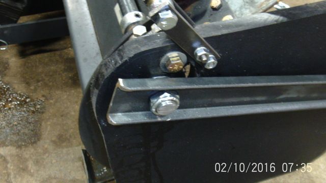

Might be hard to see but there is a slot in the UHMW that a 3/8" bolt rides in to lift the end plates.The bolt is fastened to a short arm that's welded to the pivot bar.I drilled the blade ribs out to 7/8" and used brass flange bushings.
