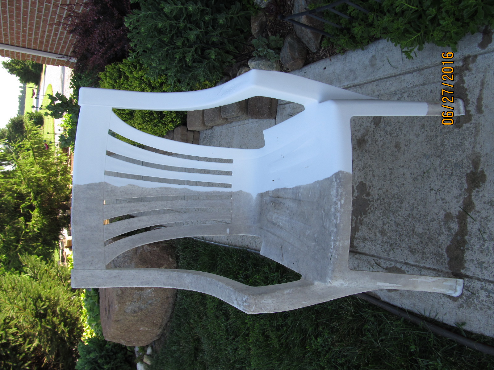

I did a thread on pressure washers, including the one I bought and found that 4000 psi, 4 gallons of water per minute, a Honda commercial engine and a 40 degree number four tip cleaned my algae clad, nasty shed siding in mere moments with no soap. No nothing but water and it's 100% clean. I also posted a photo of a plastic chair that had been in the barn 10 years and I showed it half cleaned. It was impressive. It also cleaned my concrete walk nearly 100% and that was also in mere moments.
Sorry I don't have a chemical or soap, although I started out that direction but I found none was needed, including blowing the grease off a tractor loader. Be careful of rubber seals and decals. Hope this helps and not viewed as deviating or disrespectful of your request of soap suggestions but I found that none was needed. Just pressure.
EDIT--Here's that chair. Just water and it was moldy, dirty and nasty.
I have no idea why photo is sideways.
Thanks for the data point, but I've only got a 2,000+ psi washer in Virginia and some of the areas are third floor up plus attic piece. What I'd really like is spray on, rain off.
You photo is probably sideway because a lot of phones and some cameras put a character in the exif to show orientation and it doesn't deal well with the forum software.
