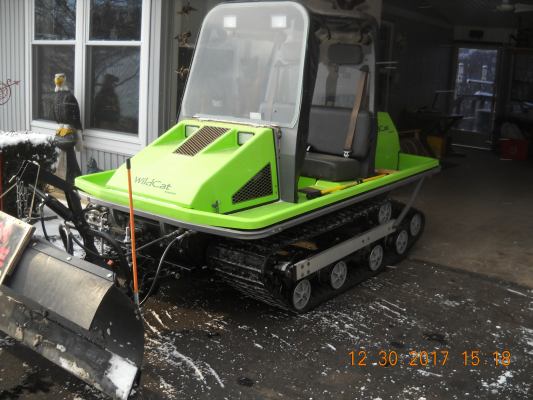

I just put on a piece of stall mat I got at TSC to see how it will do, don't know if I will be using my power trac to clear snow much, I just got a terra track Wildcat with 6 foot hydraulic raise and angle snow blade plus a cab. My sons driveway is about 900 foot long and very steep. I am hoping that tracks work good on it.
