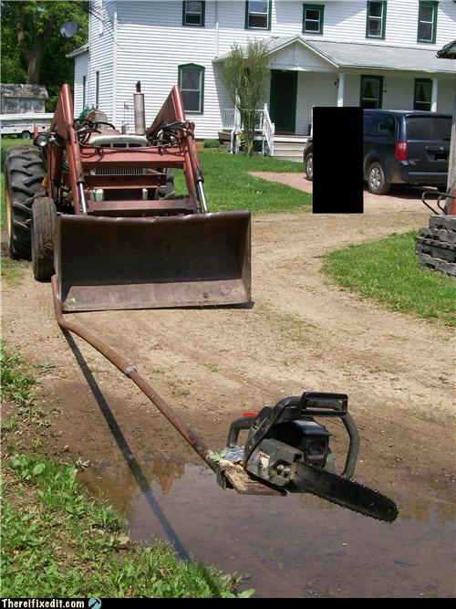

Speaking of Mods, I saw this and thought it was ideal for those higher limbs
Rgds,
tim

Oh, MY!!! That looks like its duct taped on. :thumbsup:

not only that...
there's no way to pull the trigger remotely so the trigger must be taped too! It could get ugly with that saw running full blast if the tape holding it to the pole let loose.

Did you see the PT someone on here is selling? He has a hydraulic chain saw on a boom for his PT. It looks much safer than that thing but not much.

Maybe I don't use my PT enough, but there is now way I could ever accurately cut a limb with a pole saw on my tractor. I think the guy that suggested using a shotgun would have better luck.
