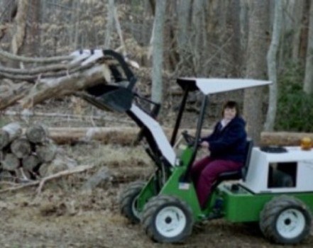

"" It is very easy for even the most inexperienced operators to learn to use. ""
Within 20 minutes my daughter, Lara, who has Down Syndrome with an IQ of ~55, had learned, with some coaching, to operate my revised PT-425 with the Grapple Bucket well enough to transport brush piles to the burn pile by herself!!
/forums/images/graemlins/cool.gif
