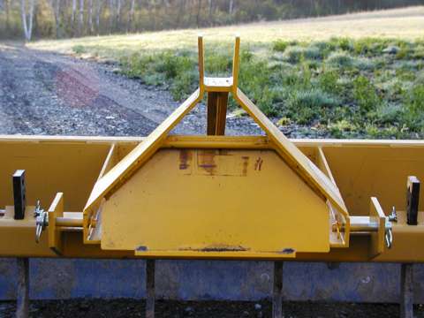

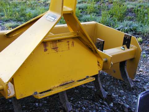

Box Blade
I decided after looking at the PT box blade that I needed something heavier to handle my long driveway maintenance needs. I looked at a couple of brands at local implement dealers and decided on a Bush Hog SBX series. The dealer had an SBX720 6ft in stock and my first impression was that it was just too big and intimidating for the 1845. So I ordered up a 5ft and later in the day as I was working with the 6ft rake I got thinking it was going to be important to have the blade wider than the 5ft wheel track so I decided to cancel the order & take the 6ft model. I have no experience with a box blade so its been tough trying to get to the right decision. This turned to be the right one. I then had the dealer weld on a quick attach plate which I'll have to photograph. I turns out the Bush Hog 3ph "tower" for the top link rises from the lower links at nearly the same slope as the beveled upper sides as the PT quick attach plate and the width is just right. It's a nearly perfect fit and a simple weld up. If anyone is looking for a box blade this series is worth checking out for this reason alone.
Wow, I should have had a box blade years ago - I've been struggling with grading with the FEL on my 484 all these years. What a pleasure it is to grade with this thing - especially with it up front where I can see what's going on. This model weighs about 550 lbs and I think I've already decided a couple of hundred extra lbs would make it grade more smoothly in float.

Here's a picture of the SBX 720 on the PT1845
   / Power Trac 1845 customizations
Re: Box Blade
A detached view

A closeup of the quick attach plate weldment

And finally, another closeup - this one head on
