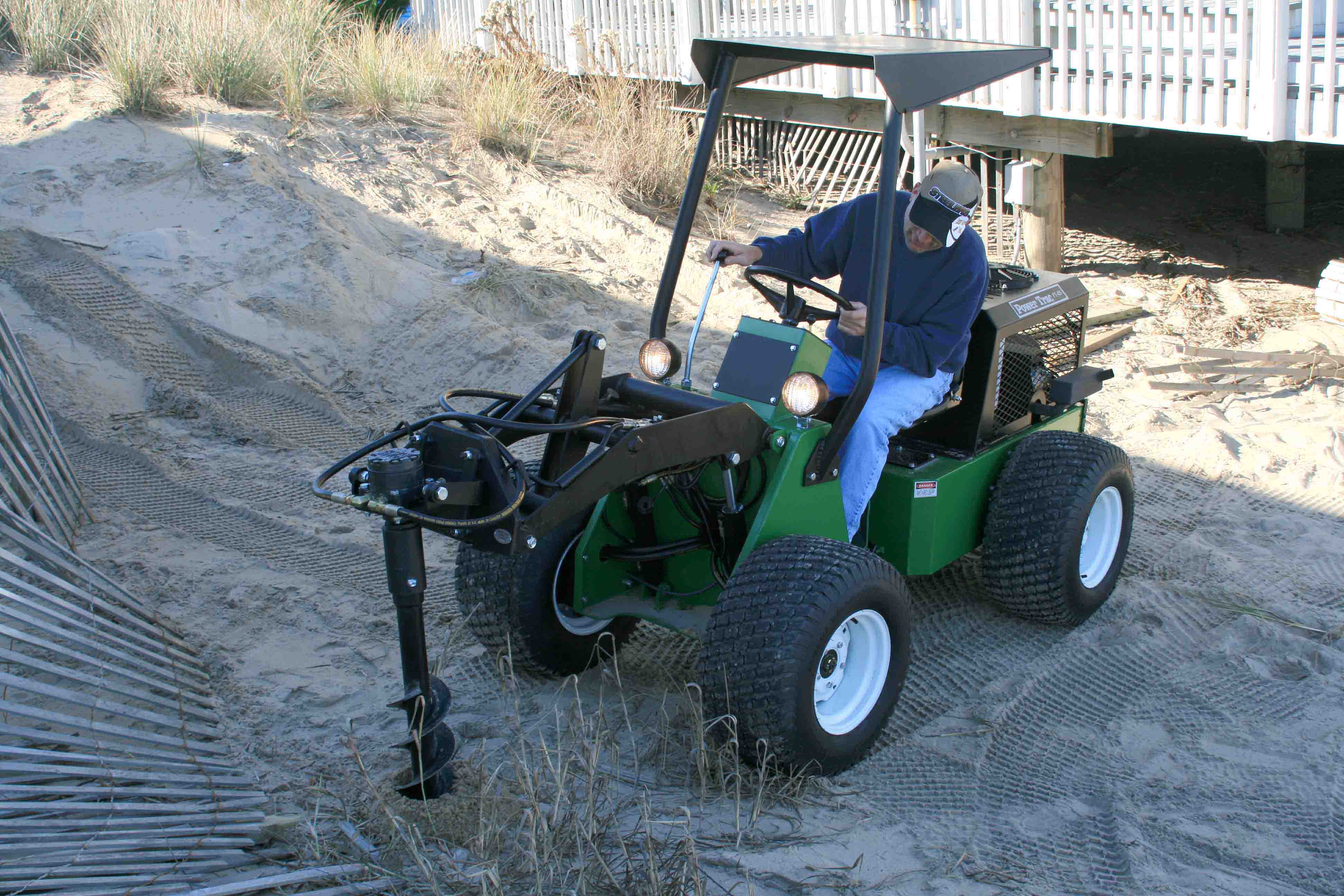

Trogger, I agree with Beachwood and BobRip, ... go with the 425. After buying tools and toys for 30-some years I never regretted buying the bigger, better tool. Admittedly I experienced a little "buyer's remorse" for a day or so, but looking back it was always the right decision to go big. The differences are more than just horsepower, ... it's wheel motors, hydraulics, tire size, lift height, and more. When you go to Tazewell and see them side by side, the 425 is clearly a different beast than the smaller machines. Best of luck to you in your pursuit.
