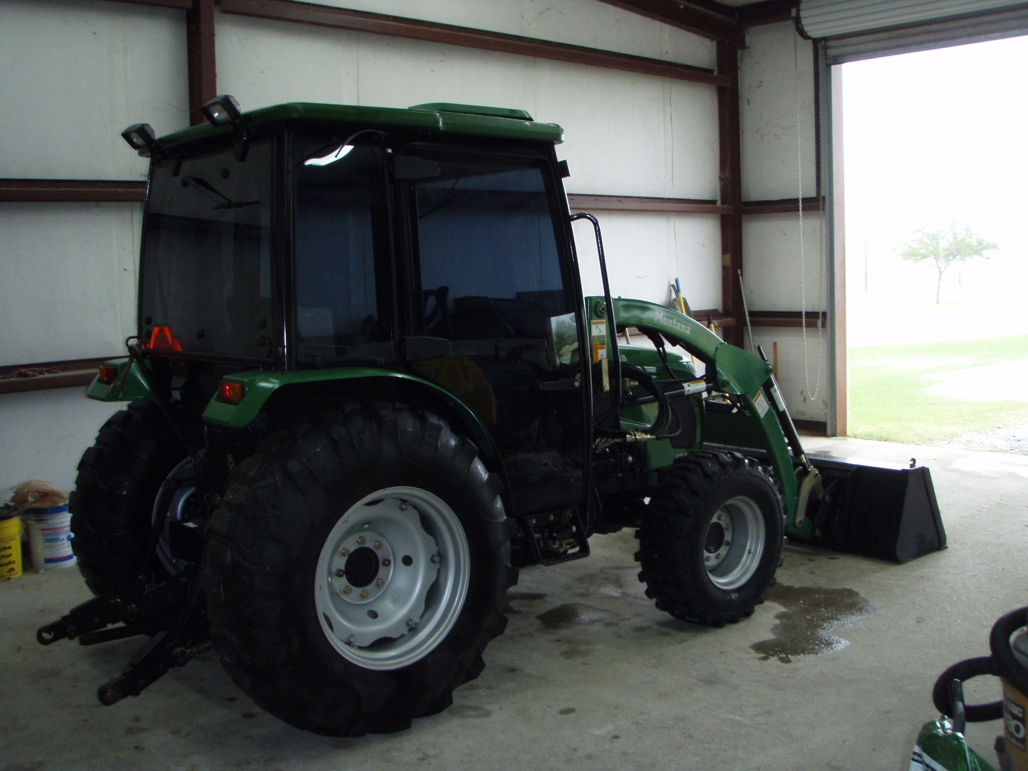

OK, I know we have hydraulic power steering on our 5740C. For the last couple months the steering has been abrupt and unpredictable similar to either air in the system or low oil. There are no unusual power steering pump noises like it is low on oil. My question is I have found what appears to be the power steering pump on the front left of the motor. But I can't figure out how the oil is checked, there does not appear to be a sight window or a dipstick on the cap. The manual is not helpful, surprise and says only to use transmission oil. Can I assume they mean trans-hydraulic like used at the other end? It is getting to the point I am starting to get concerned, the steering makes it a full time job keeping the tractor on the road at road speed.

Thanks guys, I went and had a closer look and what I had assumed was the power steering pump is as you have called it, an easier oil fill. My first clue should have been no belt drive to that section.:rolleyes:. I am going to have to try to purge the cylinders, after 4 hours snowblowing this morning it seems to be getting worse(or at least more aggravating). Hopefully that works. Oh well at the minimum I have an easier way to fill the engine oil now;). Oh and I realized a picture probably would have helped so now I have a picture too.

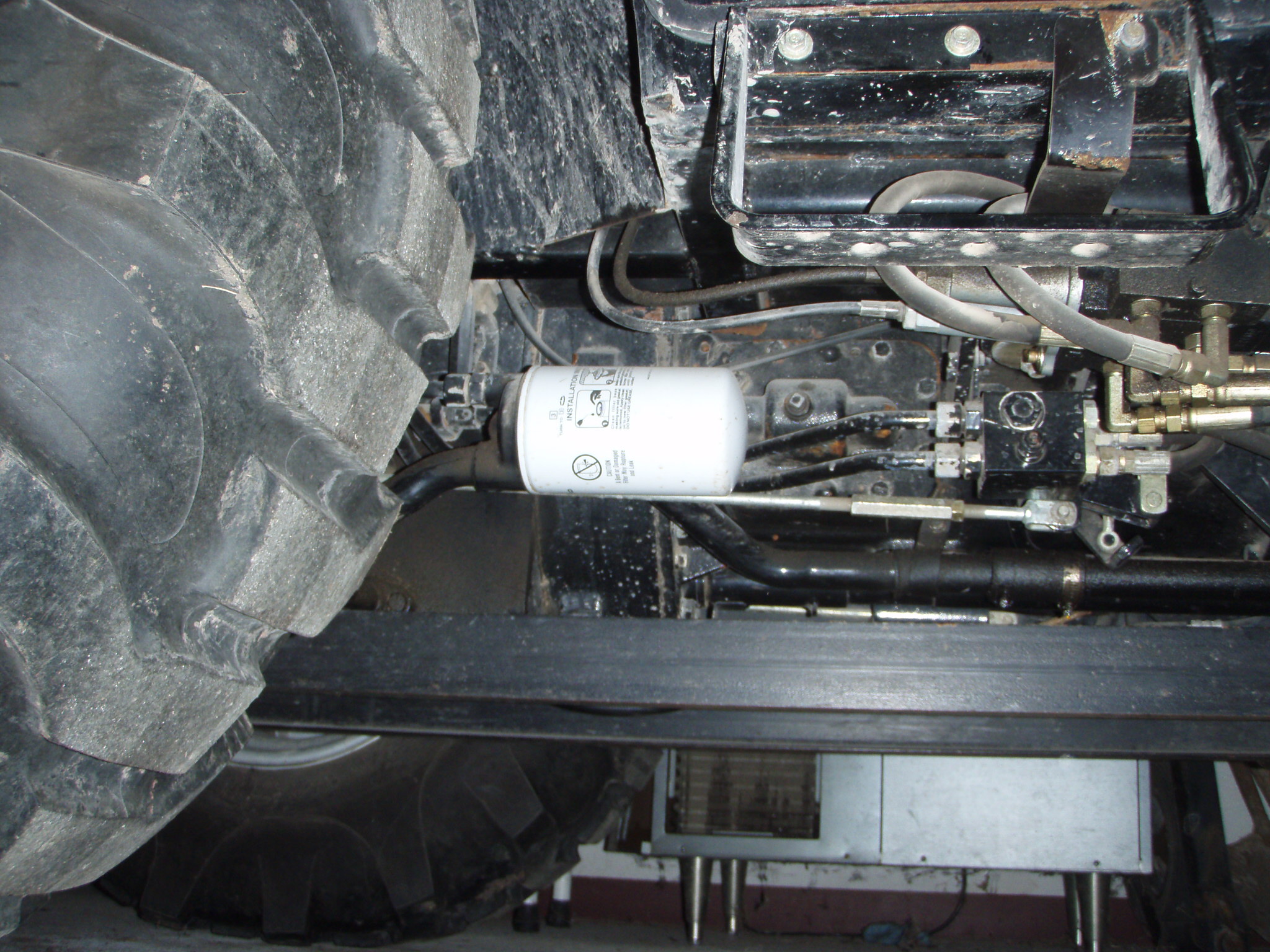

My 4940C steering did the same thing. I changed the main hydraulic/transmission filter and my steering was back to normal. I had only 255hrs on my first filter before I had to replace it. This filter is under the tractor by the right rear wheel. Change it out and there is no need to bleed the steering system, it will self bleed its self when the tractor is running.

Thanks Texasgreen, we had changed our filter once already, but it has been 150hrs, so I changed it again. At the same time I found a leak at the bottom of the steering shaft where it enters the hydraulic valves. I tightened up the leaking plate and together this seems to have fixed the problem to a large part. I was also wondering if anyone knows if having the rear tires over filled can cause some of these problems at road speed we had ours filled last summer at a local shop and I noticed over the winter that with temperature changes you could see frost all the way to the top of the tire,not a line approx 2/3 up as I anticipated. I will probably adjust this spring once the weather is decent- I took the snowblower off last week to level a load of gravel that was delivered before the restrictions are on the roads and this morning I woke up to a 3' drift in front of the house( after meltoff was 2" above my driveway for the last 2 days :mad:
