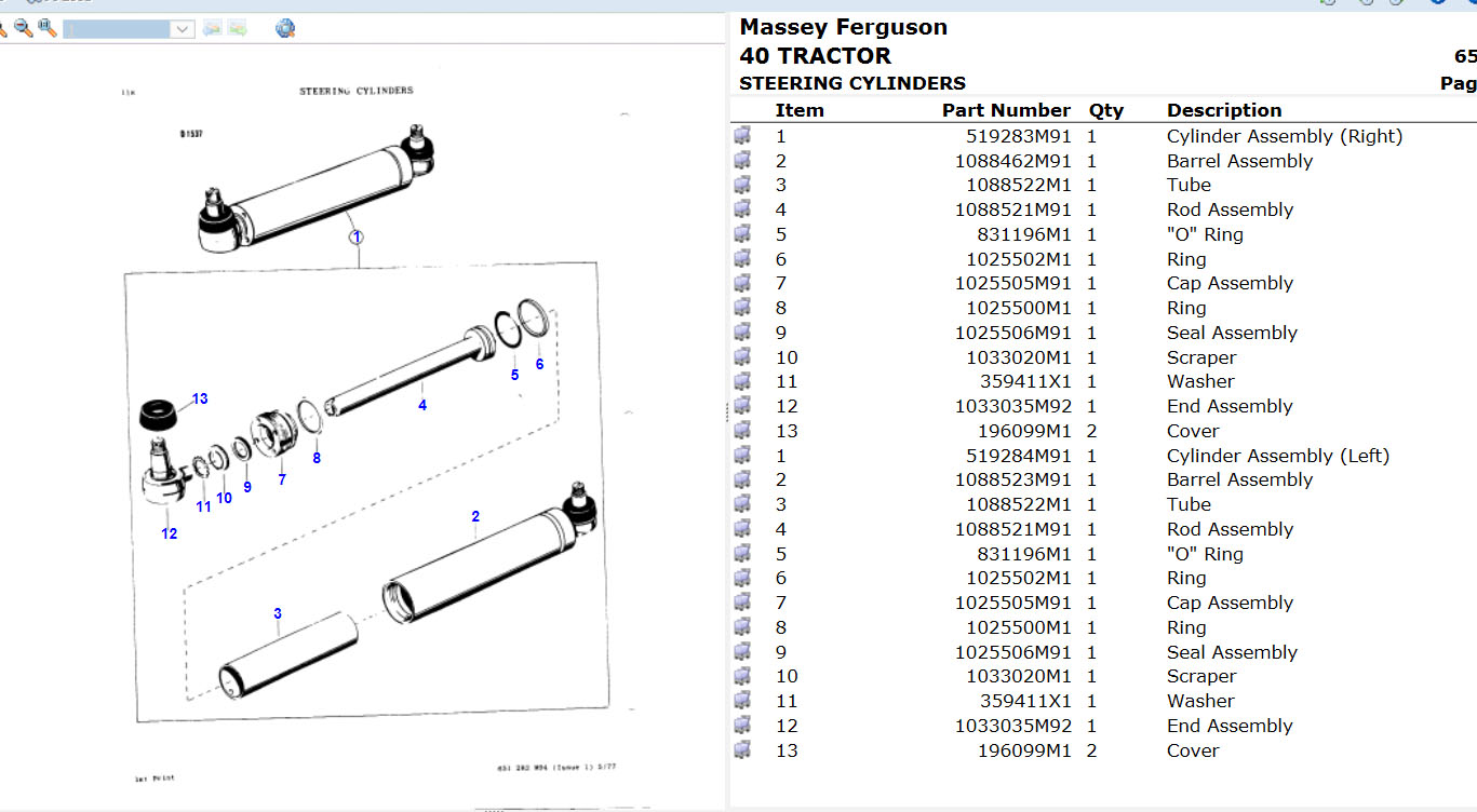

Do you know why it has a internal tube for the piston? You might find out if you use the cyls that you posted a link to well not let the steering wheel to come back to the same spot all the time. Have you seen a parts list of the cyl, if you have did it show any valves made into the piston?
   / POWER STEERING WON'T TURN LEFT UNDER LOAD REPLACEMENT PARTS NOT AVAILABLE
I am not sure why it has an internal tube for the piston other than providing for both hoses to be attached to the fixed end of the barrel instead of one hose at each end. I have attached the parts list picture of the cylinder. I don't see any valve, so maybe not an issue??

The inner tube gives each cyl the same amount oil as the other no matter where the cyls are at. The tank in the pump is real small and it keeps from running out of oil in it. So after all the air is out of the system the steering should return to the same spot.I have forgot what that steering system is called, but as you turn the wheel you are pumping oil to a cyl. So you can see why a little air can make the steering ack funny. Your steering head tank might not be big enough for the cyls you linked to. Do you think a single piston 2 rods cyl would mount up some how?

I didn't mean it would come back to center by itself. When it's turned to center the wheel is in the same spot as it was before you turned it.
The shaft takes up room in the cyl and the oil on the outside of tube makes up for your shaft.
