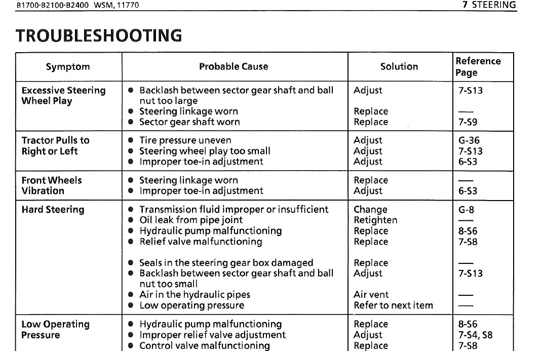

I am attaching the WSM troubleshooting section.

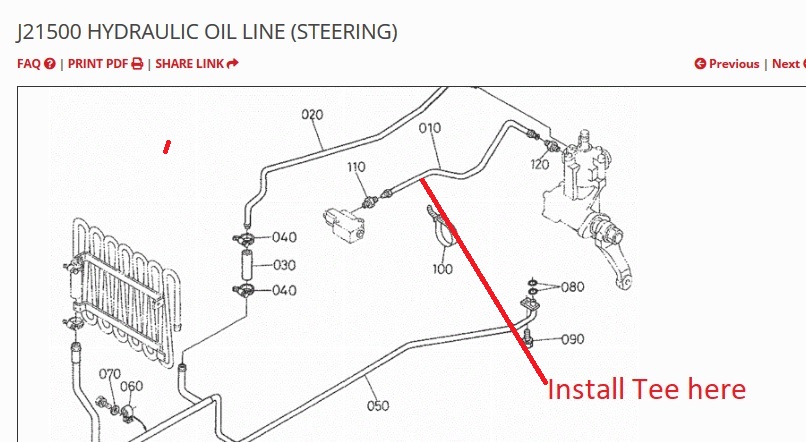

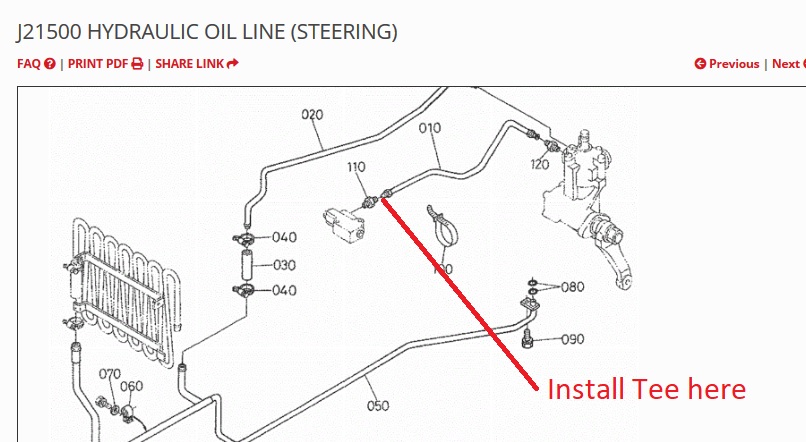

Look at the parts illustration I have marked up showing where you have to Tee into the high pressure line going to the steering box.

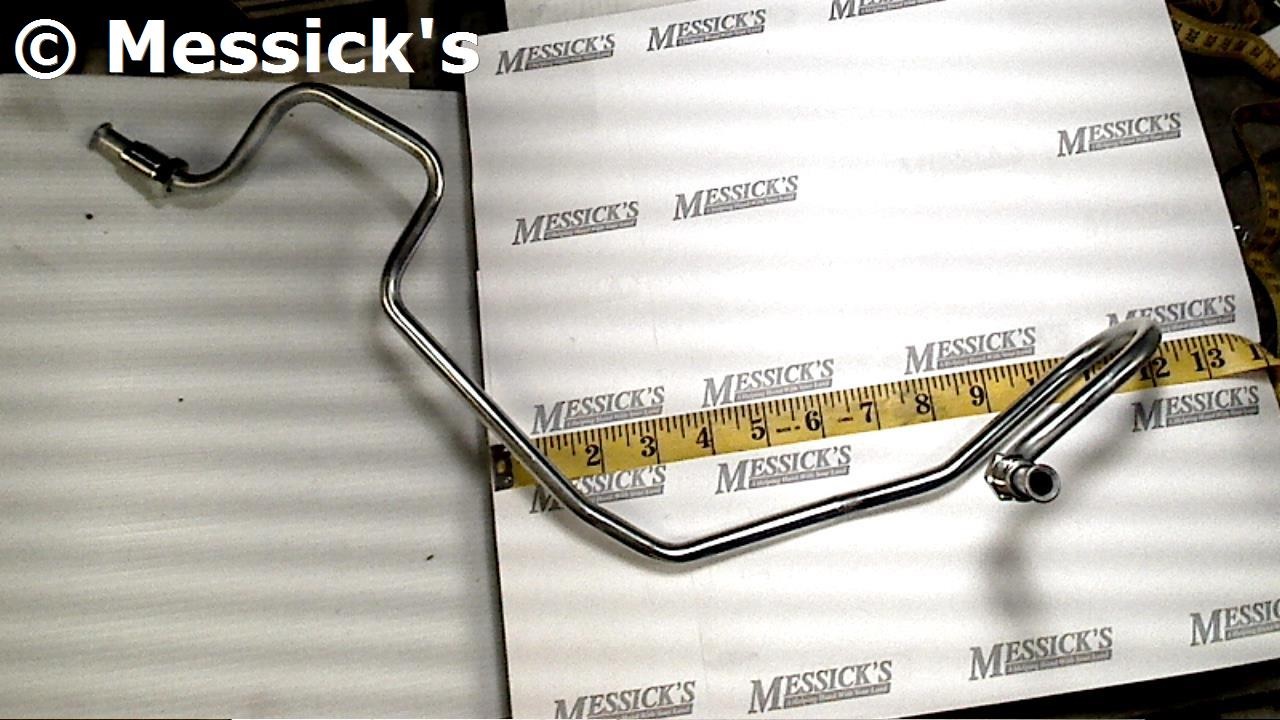

Look at the photo (supplied by Messicks) of the high pressure steel line feeding the steering box.
You need to remove the steel line and go to a local hydraulics shop and ask them to braze in a tee on your steel line which can then be plugged for normal operation once the test is done.
The gauge needs to be on the end of a length of hose.
Ignore the marked up illustration showing a Tee at the end of the steel line
