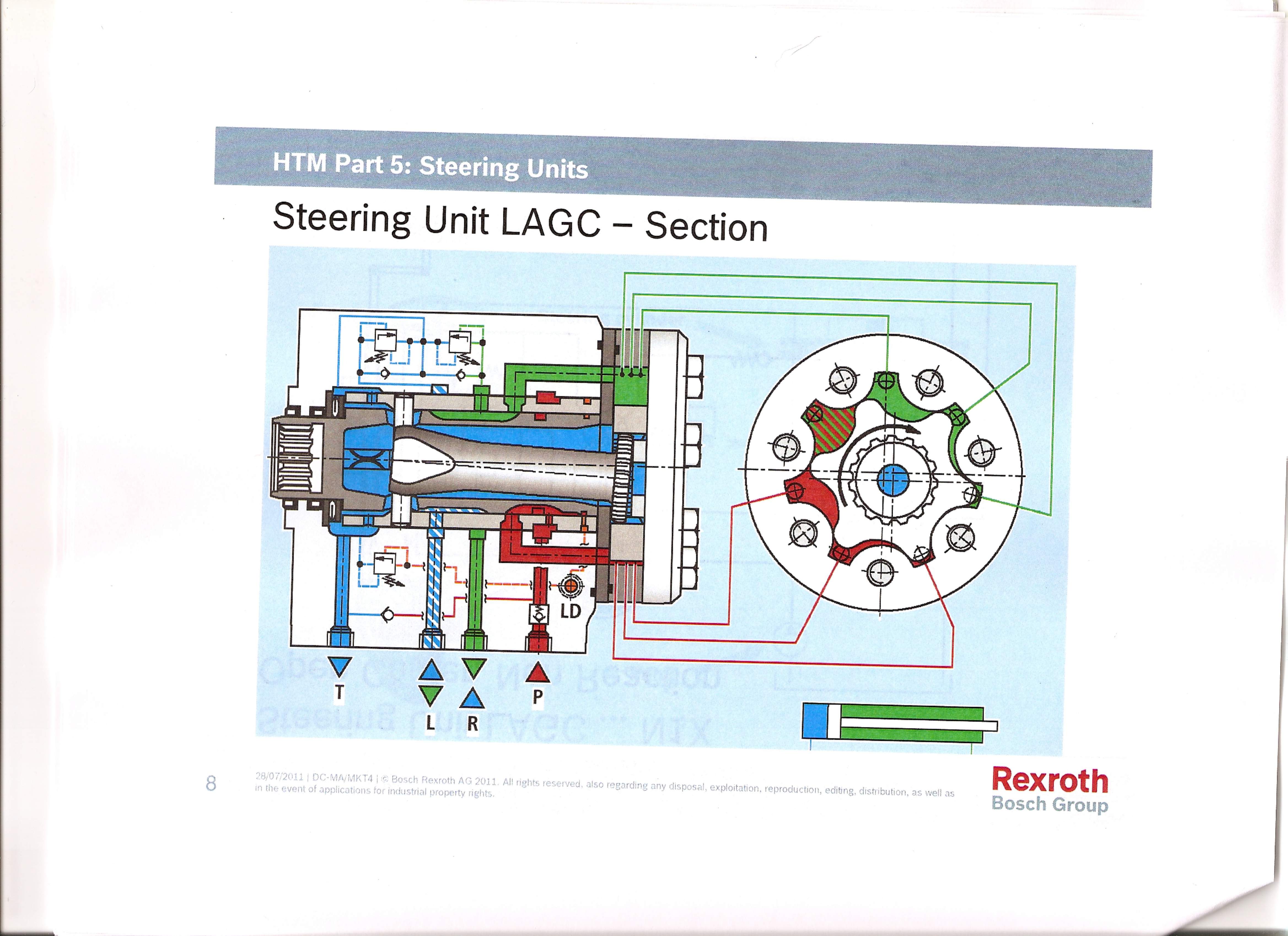

Noticed a couple of problems though one was the squealing hydro while reversing but after allot of reading last night found out about a line replacement for it. The second problme though is with the power steering. When it warms up after running it for a half a hour or so the steering isn't as responsive as it should be or at least what I think it should be. If you are turning the steering wheel slow you can just keep on turning it. You have to turn it fairly fast and then when the wheels do turn if you let up on the steering they go back to center on thier own or close to. It's kind of a annoying thing. Is this normal on these tractors or a common problem? Seems like there is a valve that is bypassing somewhere and allowing the pressure to bleed off once it's warmed up.

Steering valve.jpgRyan,
Most power steerin gsystems consist of the steering valve or control taht is driven by the steering wheel and the steering cylinder. I am attaching a sectional view of a basic steering valve. This happens to be a Rexroth unit but, Eaton, Danfoss, etc. are of very similar design.
The steering valve controls how much oil is pumped or metered into the steering cylider by the geroter style pump built into them. This is the multilobed assembly on the right hand side of the picture.
The steering wheel is connected to the splines of the dark grey colored spool. The white "pin" is a leaf type spring that allows the light grey sleeve to rotate slightly independant of the internal dark grey spool. This slight movement directs the oil flow from the geroter to either the left or right steering port. If this outer sleeve gets sticky it can allow the wheels to drift and or alow oil to by-pass to tank at very little resistance. These valves are usually pretty robust but they are like any other made man item and do fail.
These are also a Real PITA to repair.
Bad cylinder seals could also cause some of the syptoms you are seeing. Cylinders can usually be diagnosed by turning the wheels to a hard stop and removing the return line from the cylinder and then checking for leakage flow past the seals by trying to turn the wheels against the stop.

Thank you for the info oldnslo, hadn't considered the posibillity of a interal leak in the steering cylenders but it is a possibility. I have a suspision it's a valve issue but you may be correct. If the tractor is sitting still the wheels will stay where you point them but as soon as you start moving they slowly come back to center. They don't always come completley back to center but usually pretty close. I haven't driven it on the road yet so I don't know how much of a hazzard it is there yet but it sure is a pain when working in tight spaces. Like the tractor so far otherwise though. Hopefully can get this problem sorted out.

First little bit of combining today so not sure when we'll get time to get the tractor in to them though. His initial thought though is that the steering pump is shot. Also said it could be a cylender like oldnslo mentioned or posibly a bad valve. Reasureing to hear though that they're willing to work with us on it.
