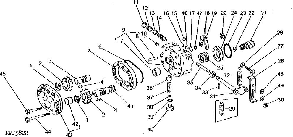

Have a 1961?? JD industrial wheel loader. I burned out the power steering pump by towing it. I didnt have the
gear selector in the tow position. I hear the pump is in the trans. Where?? how do I get to it and where can I get parts. This tractor has been in my family for 43yrs and realy want to get it going again. thanks for any help

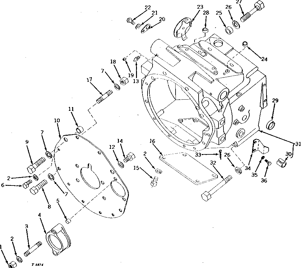

1st there is no tow position on the trans shifter on a JD 2010. Hyd pump is in the clutch housing not the trans by removing a bottom cover under clutch housing.

Access to hyd pump is though hole in bottom of clutch housing covered by plate(parts Key#16)

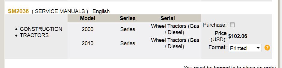

Tech manual available from JD and other sources.
