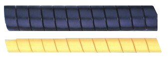

We've done all 4 and agree a cuss word or two will slip out, and be sure and wear gloves. I used Kubota hoses on the back and had the front made locally. The mistake I made was not having them put the protective sleeve back on the front hoses when they were made. The ends were larger than the Kubota hoses and the sleeve would not go on. It was harder than I thought to find the larger size of protective sleeve. Other than that it just took time and patience.
/ Power Steering Hose Failure #11
You could have used the spiral wrap. You don't have to disconnect hose to install the wrap.
